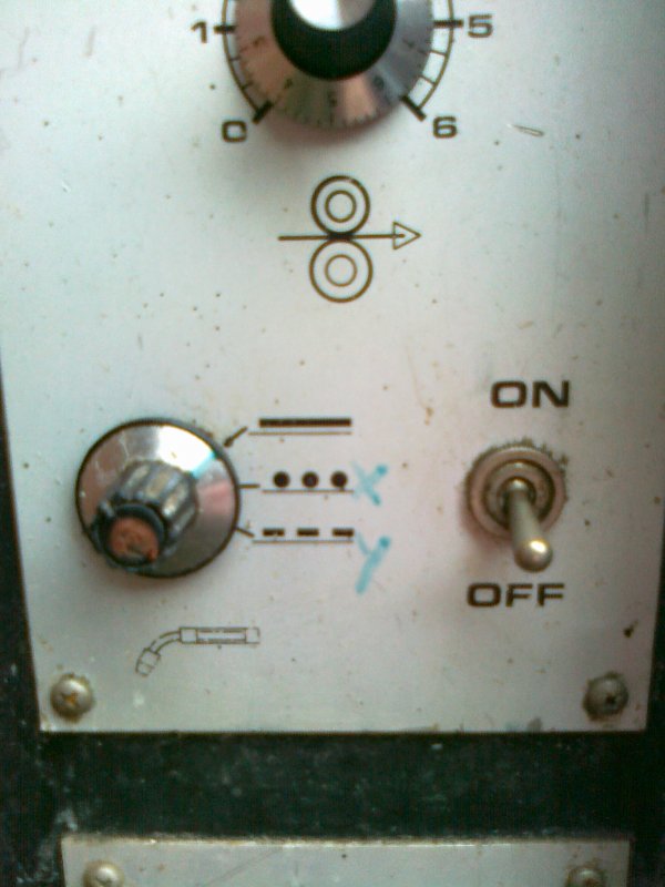

hi mike thanks for your reply--sorry it took me 2 months !!!!----yeah i do have that switch on correcctly--and i recently took it to a reputablle repairer and they said it is not repairable---bullshise!!-----it just wont run a bloody weld----anyway i do not want to toss it as i paid bulk dollars and its a really top welder when running
Does that mean it will only weld when in the SPOT position on switch or that it will only weld briefly when set on the NORMAL even if the trigger is kept pulled?
does it have a STITCH position and when set to max time does that weld for any longer than the NORMAL position assuming the NORMAL position is where it faults?
Have yo got a pic of front and insides?
