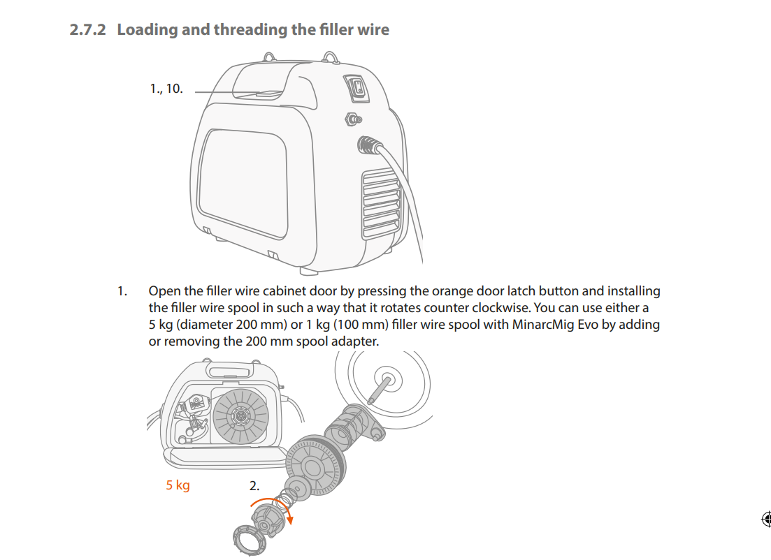

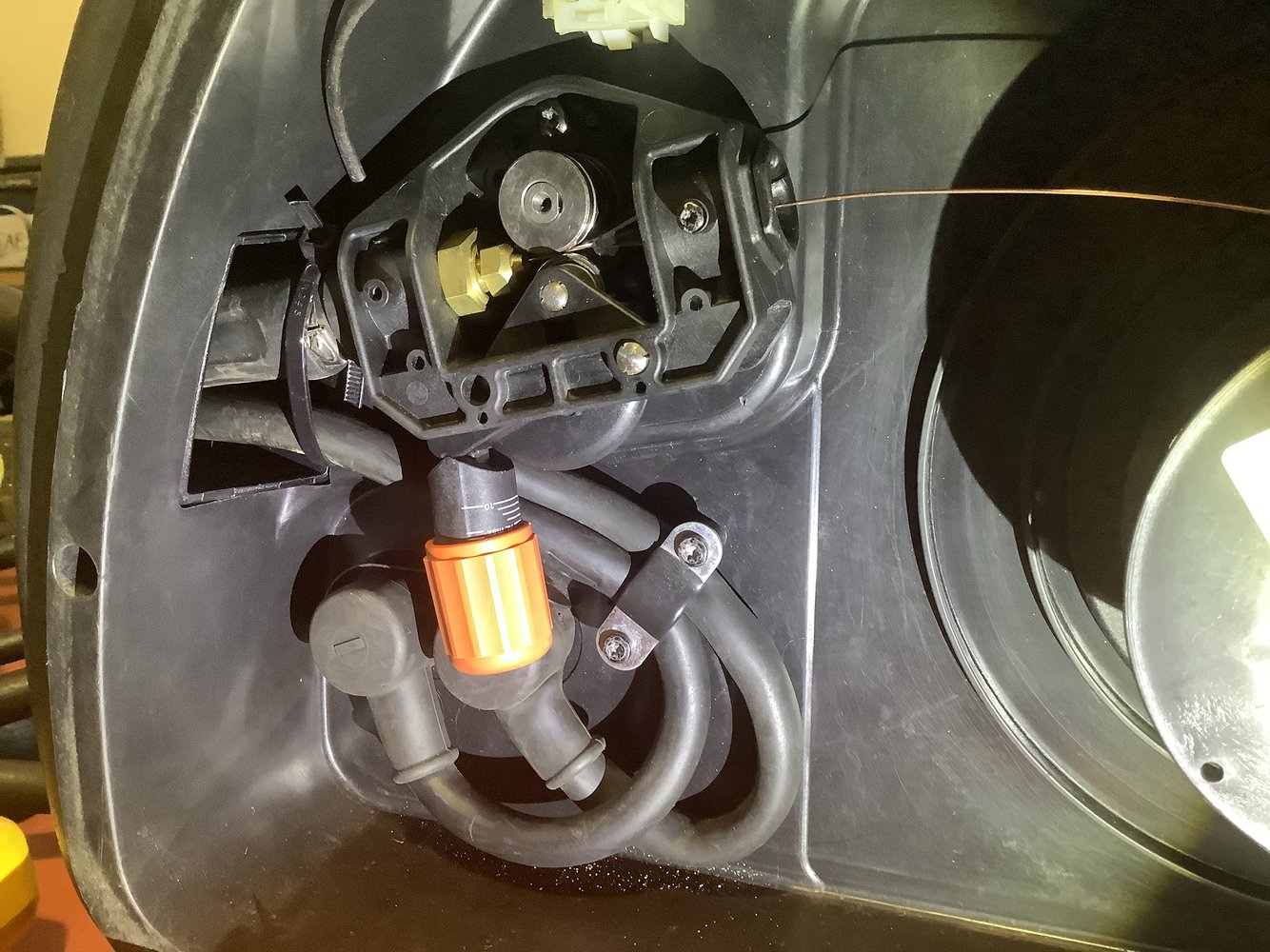

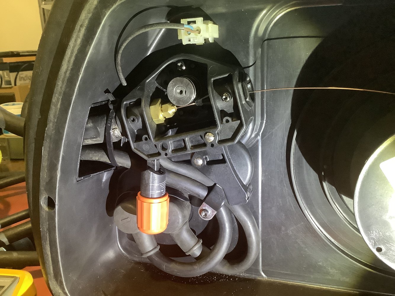

Actually EVO 200 is intender for small reels, only thing that is needed is to remove the attachment for 200mm reelThat's quite a sharp turn for the wire to get from that small reel into the plastic guide and drive unit. Could be a lot of friction there.
