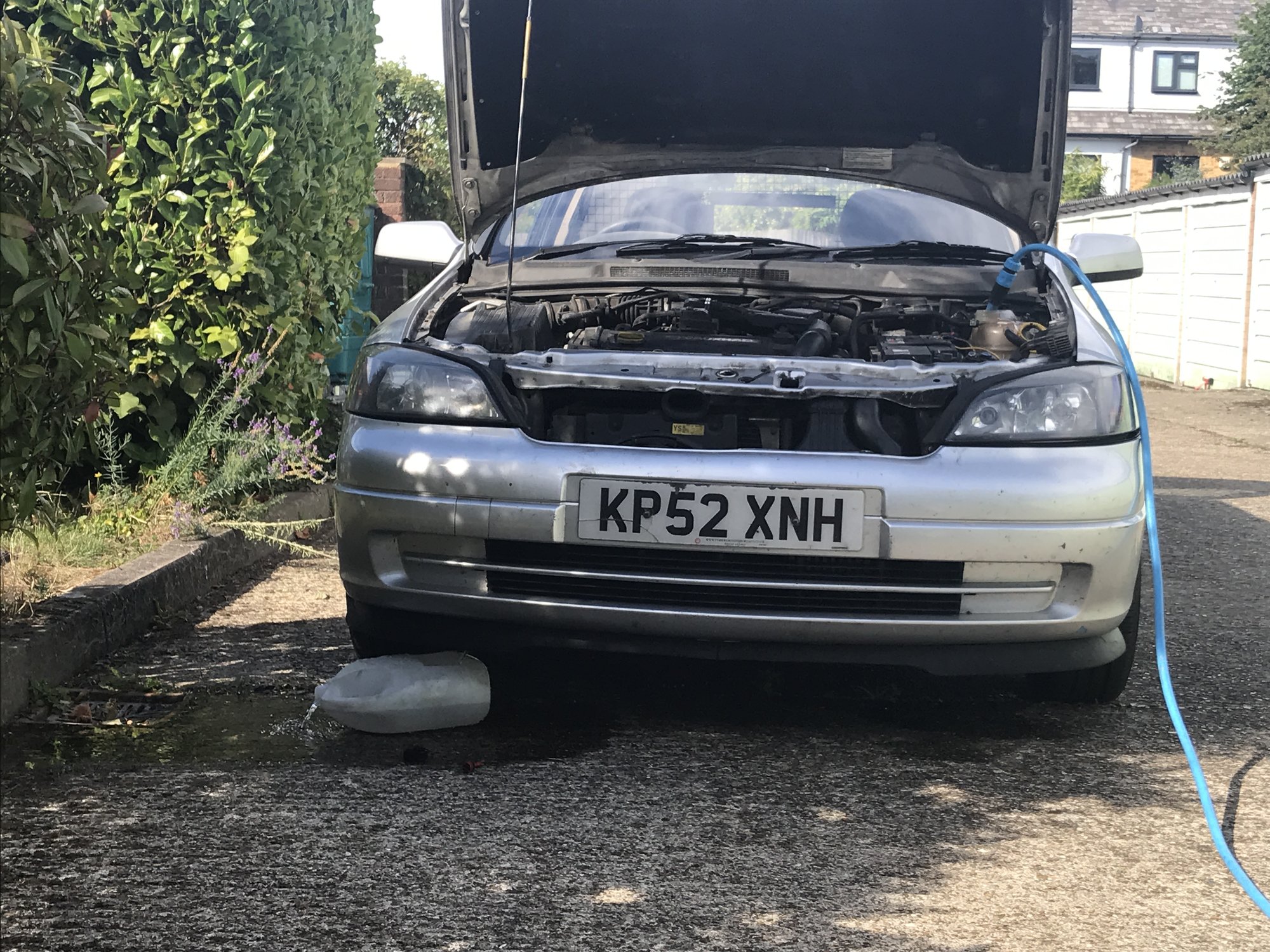

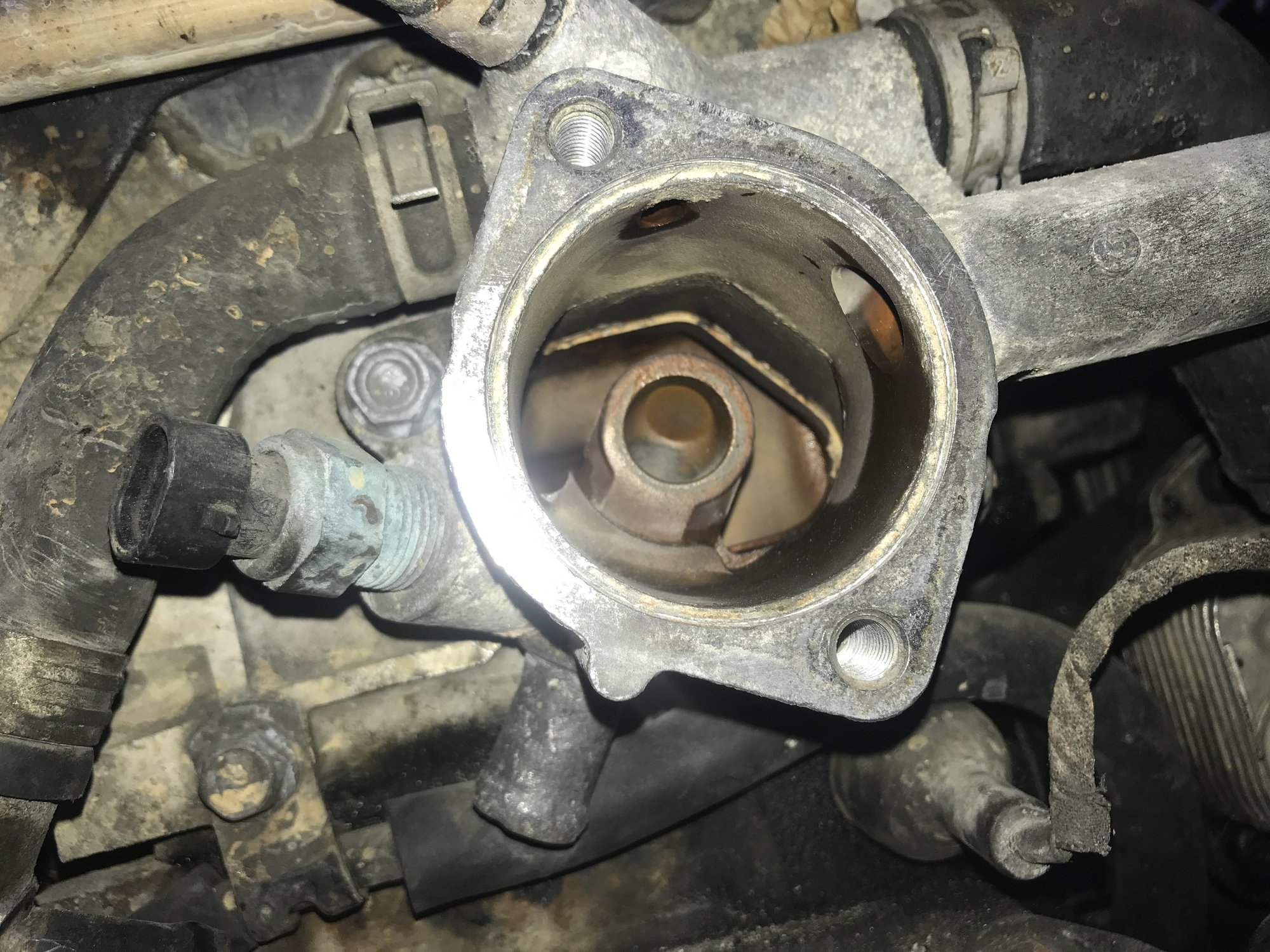

    The ole girl has always taken an age to heat up and rarely got up to full temp, after recent events with a blown coolant hose which has been replaced, she started heating up more quickly reaching a decent temp and the fan was kicking in every now and then.
    The first time the fan ran I wondered what the hell all the noise was, I don’t think it’s ever been required to run since I’ve had the van and there were leftover bits of pigeon that I hit about 8 months ago flying again.
    This worried me so today I’m checking the thermostat (had planned to do this since I got the van even have a new one that’s been on a shelf in the garage for several years)

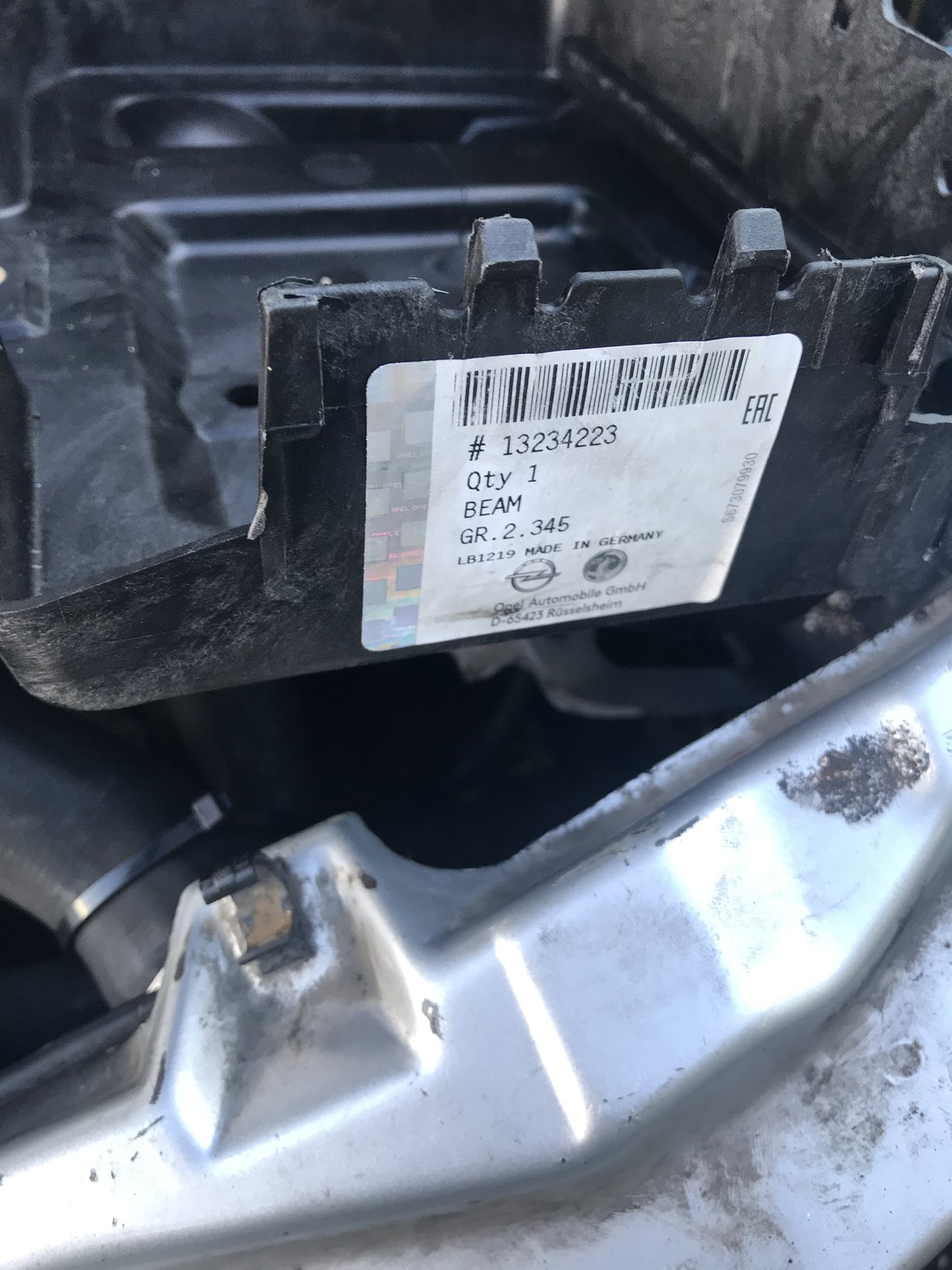

  4. Tray
    Tray Member
    Messages:
    91
    Location:
    England
    So removed battery for better access and because I’m also replacing it as it’s a bit tired (It’s lasted 5 years) and I managed to get exactly the same one for £55 (paid £88 5 year ago)
    Opened the stat housing and was greeted by this

  8. Tray
    Tray Member
    Messages:
    91
    Location:
    England
    No not the kitchen this time.
    As you can see the rubber seal in the valve is falling to bits, first one I’ve seen with a rubber seal to be fair.
    I’m guessing it’s never closed properly since I’ve had the van, and maybe a bit of it was jamming the valve open then came loose when I had the burst hose and drove the van for 20mile with very low coolant causing the valve to open fully and release the trapped bit.
    I’ve taken the thermostat out to replace with the new/old stock from me garage.
    A while back I took out the heat exchanger between the coolant/oil due to a small oil leak where it bolts to the engine.
    I found it completely blocked on the coolant side I reckon radweld has been used and it’s caused this.
    Clearing it out did help the heater warm up a little quicker so I’m guessing it’s not just an oil cooler as most people seemed to refer to it but that it helps make the heater work quicker from cold as well.
    All the hose connections around the thermostat housing were very furred up and on removal there seemed to be a lot of the same stuff I found in the heat exchanger around the joints.
    The inside behind the stat looks pretty clear.
    I’ve given the cooling system a good flush with clean water and have put some rad flush in with the stat still removed to make sure it gets circulated properly and the system is well cleaned.

    Also today new OEM battery tray (only £15 on fleabay) to keep the MOT guy happy as the old one had snapped right across the battery retaining clamp.

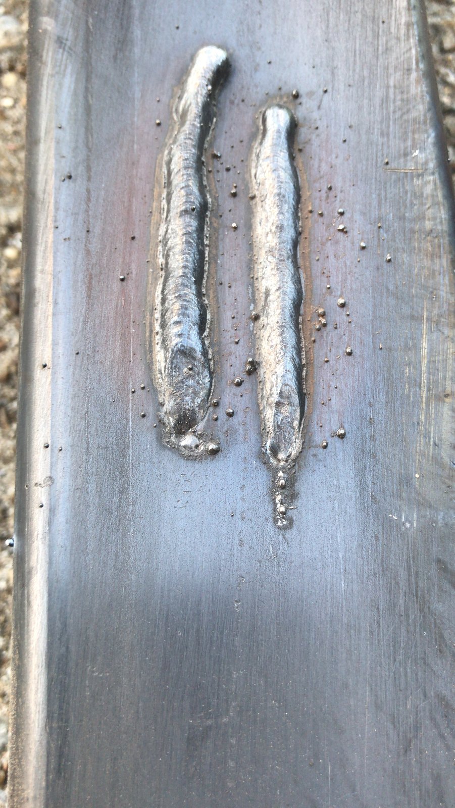

    Oh and this turned up so I might get some welding practice in too
    I know flux core is generally frowned upon but I got no gas and no workshop so I’m outdoors.
    These are the first 2 beads I have ever run after getting my Cosmo130 fully modded thanks to this https://www.mig-welding.co.uk/forum/threads/new-user-with-cosmo-170-sip-and-a-headache.8028/ thread.
    Using 0.8 flux core on 4mm box section 1 setting below max(the breaker kept tripping on max)
    I know I didn’t clean the box section first it was late and I just wanted to give it a go.
    I think they’re pretty good for a first attempt and only a slight clean up with a wire brush.

  17. a111r Member
    Messages:
    463
    Location:
    London
    Looks an ace first attempt, I'd say.
