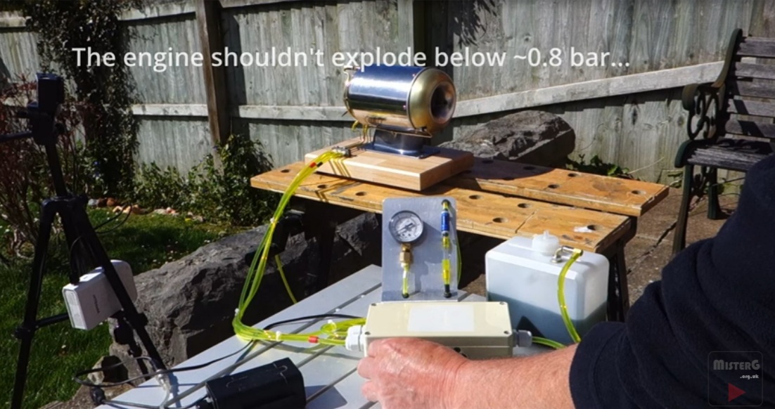

Hello again!
Well, after a bit of a hiatus, I got back to this project and assembled the various bits and bobs I needed to try running it on liquid fuel.
The main requirement is a pump capable of providing a controllable flow of fuel that can be adjusted from a bare dribble with no delivery pressure to ~ 250cc / minute against ~1 bar back pressure from the engine (I think my 400cc/min above was a bit of an over-estimate). The proper pumps are ruinously expensive (~£300+) so I am trying a cheap RC Glow fuel transfer pump:
It is a positive displacement gear pump (I had to open it as it wouldn't run when I got it - there was a bit of plastic flash stuck in the works)
I was thinking of running it with a pressure relief valve and controlling the fuel flow with a needle valve, but as it transpires, there's so much back-leakage in the pump that it will run against a dead head without complaining too much, so I just used a cheap (and very nasty) Chinese needle valve to shut the fuel off and control the initial flow:
A portion of the fuel feed is diverted to lubricate the bearings (it has oil mixed into it for this purpose). The flow to the bearings is restricted by a fine hypodermic needle (0.4mm bore). To try and stop it blocking, I added a fine filter to the line before it.
After faffing about trying to make a neat looking arrangement, I eventually gave up and threw the lot in a old box that I had knocking about:
The fine filter is the blue thing on the right, and the needle for the lube restrictor is coiled up inside the glass tube which is there to (hopefully) provide some sort of tell-tale for the lubrication flow. (The pressure gauge is for measuring the the air pressure inside the engine - it was a convenient place to put it).
I consoled myself with making some shiny pipes to fit on the engine instead:
And a bulkhead fitting...
...for the fuel tank (made from an old battery acid container)
Which brings us to last Saturday...
Overall, very pleased with how it went - the engine ran very sweetly and was very tractable. I was reluctant to push it without knowing what speed it was doing. (I think my turbine wheel should be OK to ~98,000 RPM, but ultimately, these engines have no rev limit - short of self destruction.) As it happens, I was limited by the pump in this case, but a few more volts will overcome that (I was running a 12V pump off 8.4V).
So, if I can sort a reliable tacho, I'll stick the engine on some rails, next time, and attach a spring balance to see if it poduces anything other than noise and smoke.
Thanks

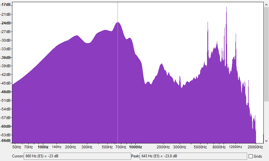

One of those sharp peaks near the top end is pretty close to 19x643 Hz too (As in, one vibration per turbine blade) which is reassuring.
