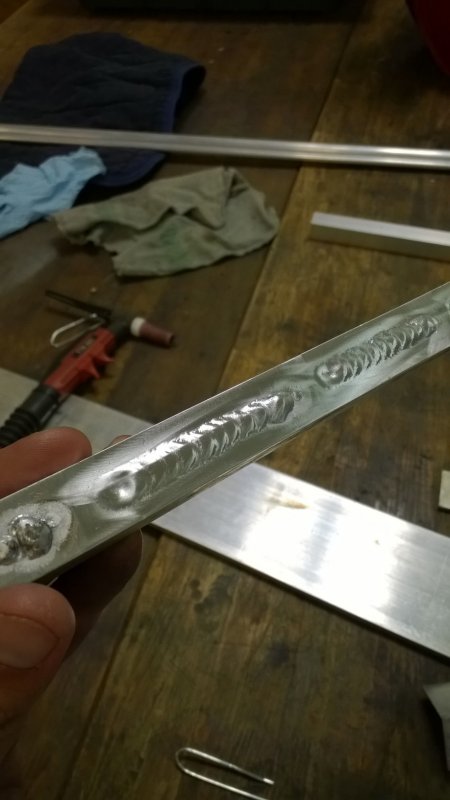

I've been welding mild steel in my free time for a while now and decided i wanted to have a go on aluminium. If I can learn fast enough i'd like to try and finish a project in about a month. But we'll see how that goes.
So anyways I've read a lot of posts on the forum and watched videos by mr. tig and weldingtipsandtricks. Basically anything that said TIG aluminium. After that just took some scrap pieces and started experimenting with different settings and technique. I'll post some pictures of what i've done. In a few nights I think I made decent progress, at least I m happy with it and enjoying to learn ally. Any comments are highly appreciated!
I use a kemppi mastertig, argon shielding and no foot pedal because i don't have one.

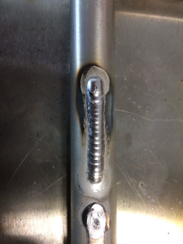

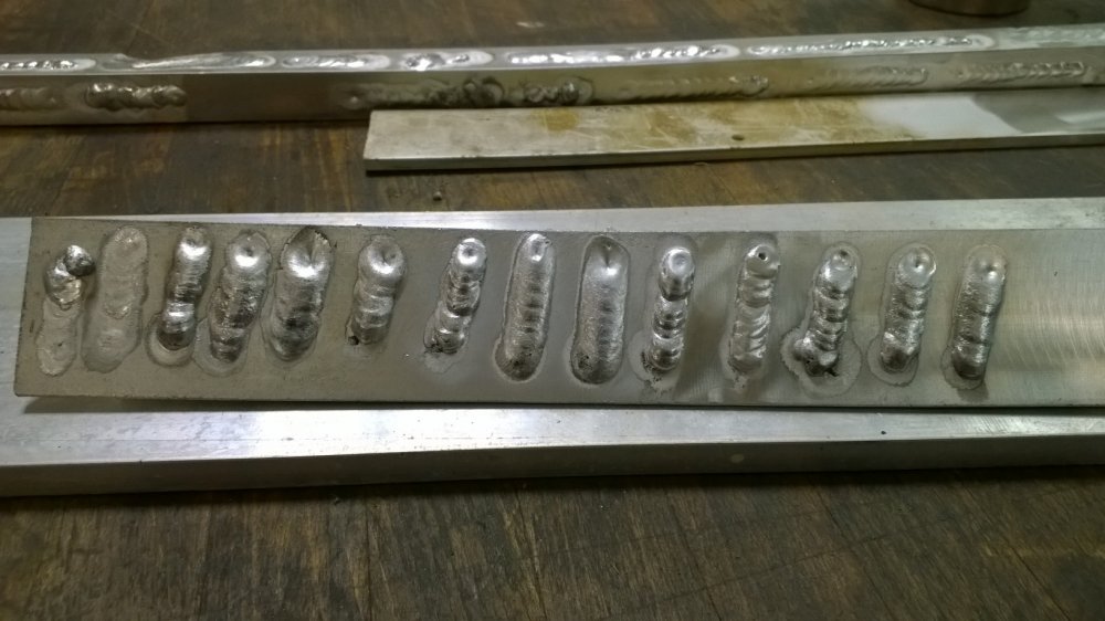

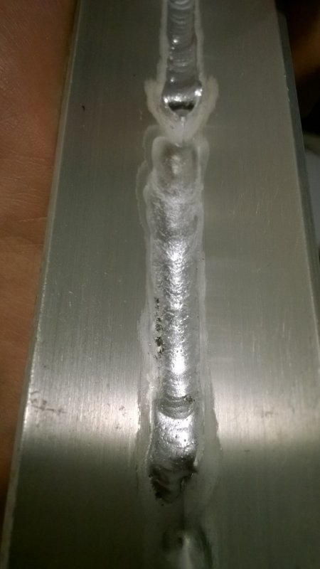

So this is how I started out. Piece of 40mm x 40 mm L profile, about 2mm thick. Tried out different amps and ac balance.

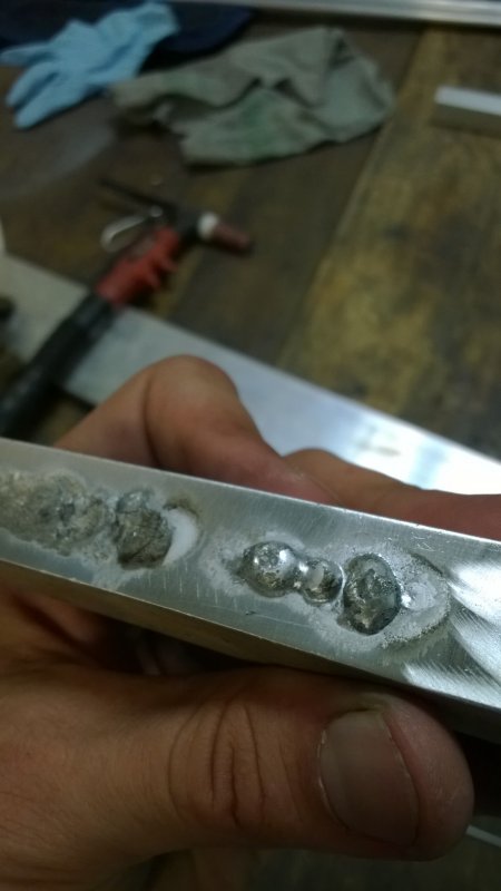

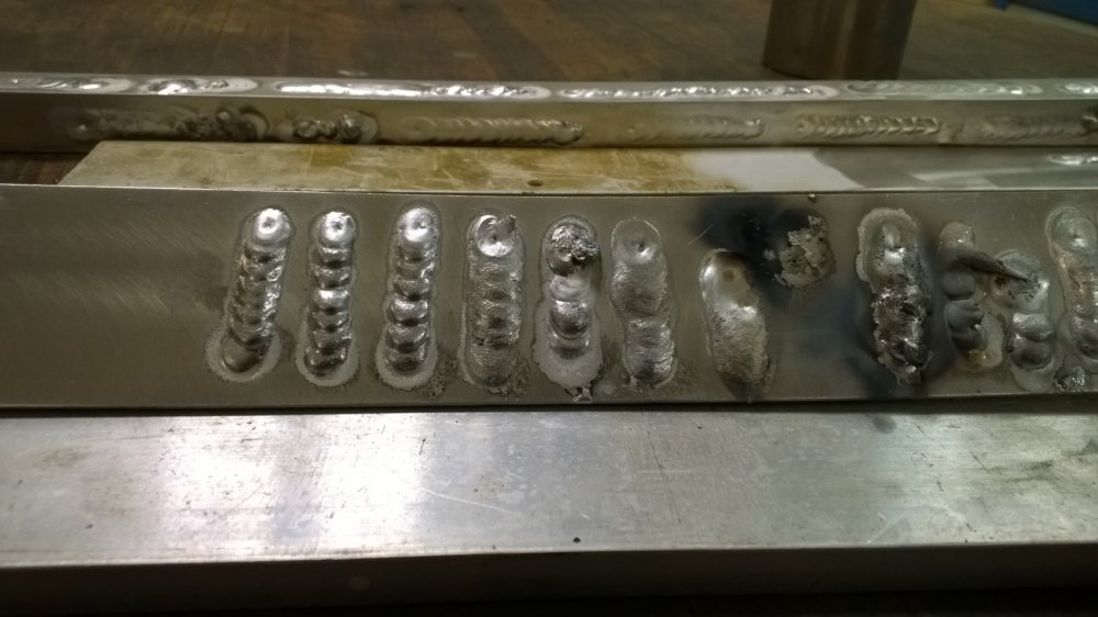

So figured out, welding straight on anodised without cleaning doesn't work ;-)

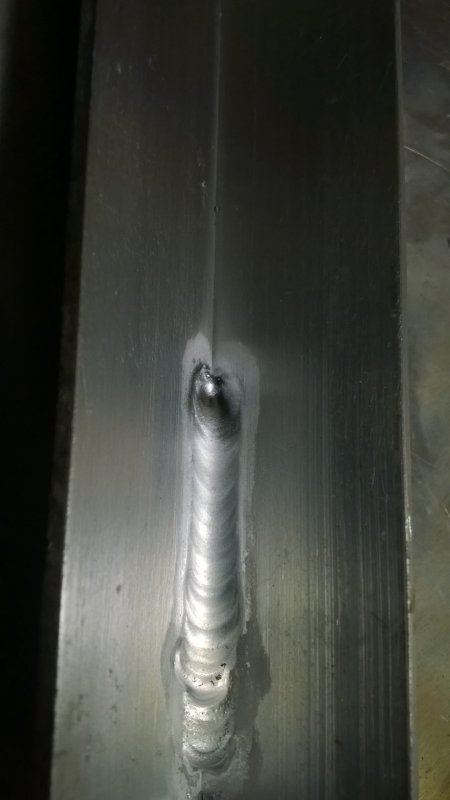

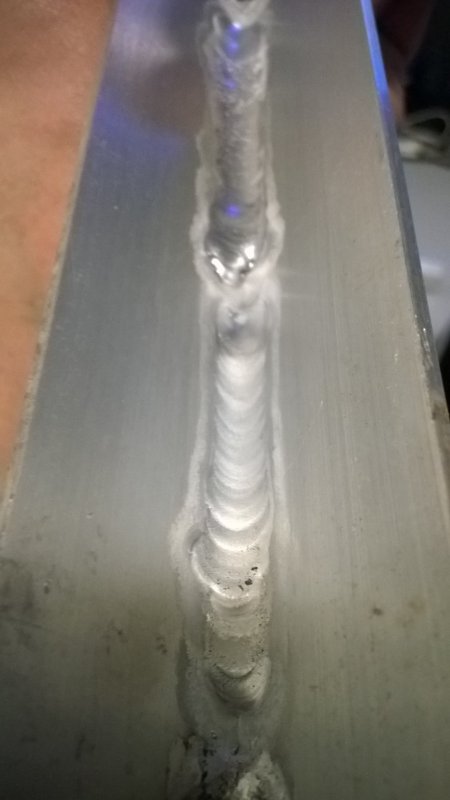

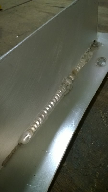

This is starting to look alright in my opinion. Did a bit of cleaning with scotch bright after welding.

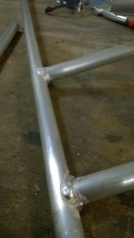

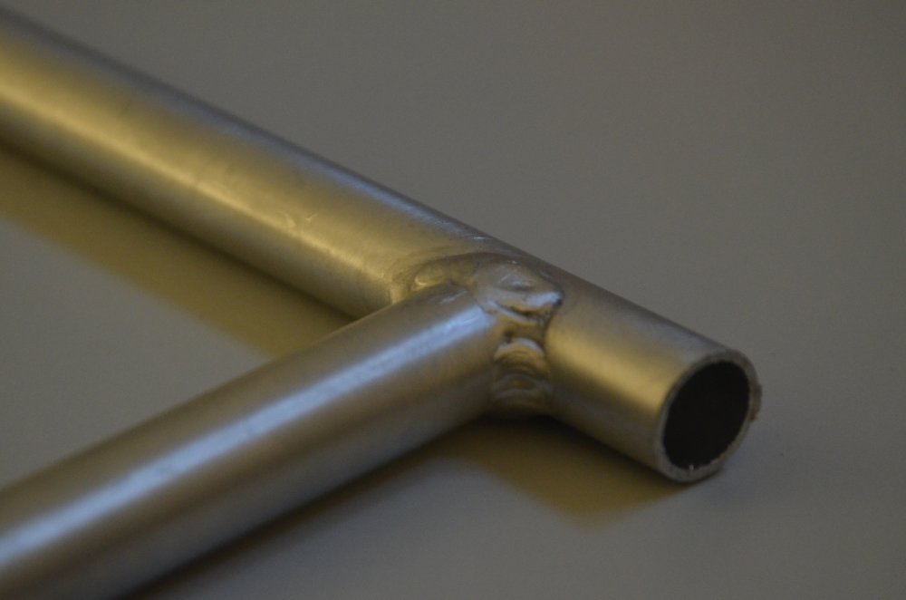

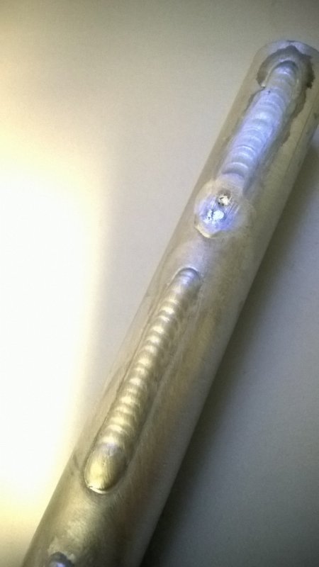

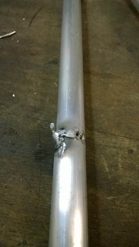

For my project, a small luggage carrying rack for a motorbike, I intend to use 18x1,5 mm tube. So picked up a length of 6060 18mm tube.

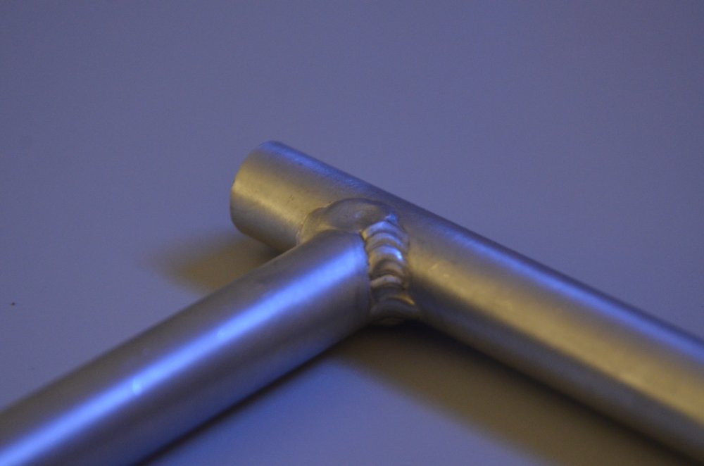

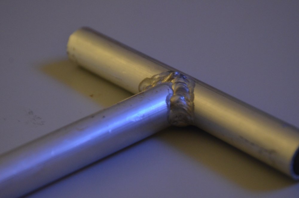

First go at the 18mm tube.

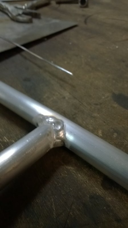

Second go, also cleaned with scotch bright after welding. Looks a lot better when you clean it up after.

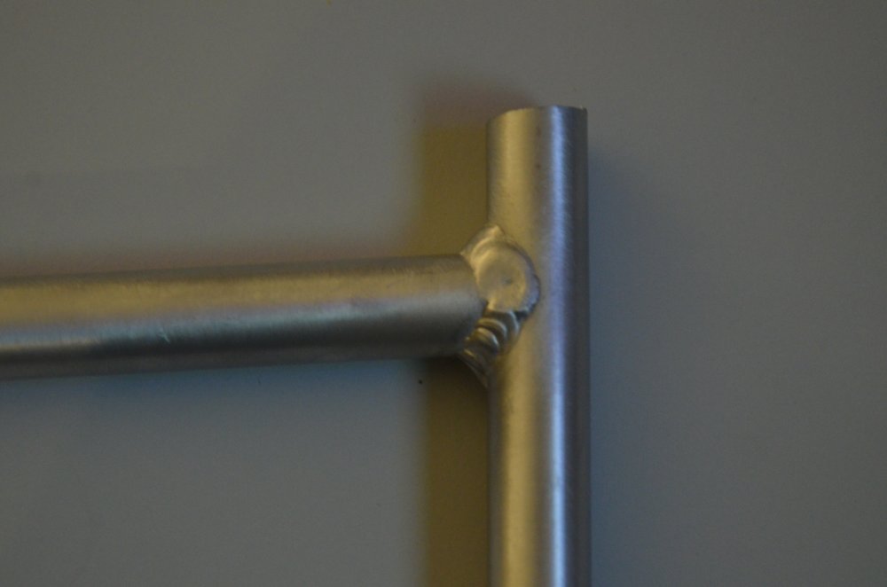

Same weld, other side
And one from the top.
All the 18mm tube was welded with kemppi mastertig. Ac 100hz / balance set to -55 (this is a bit different from other machines because it has some sort of auto-balance function) / 6 liters/h argon and 50amp most of the time. By the time it all warmed up went back to 35 amps.
What do you guys think. Any tips to try make it look better i'm gonna try out soon, and i ll post pictures of any improvements.
Do you think these welds are structurally sound? If i look inside the tube i can see the weld 'coming thru' on some places.
