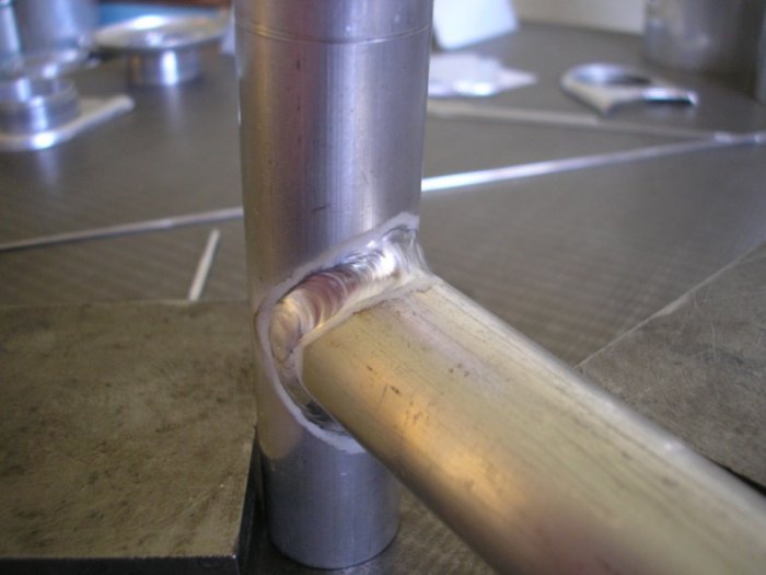

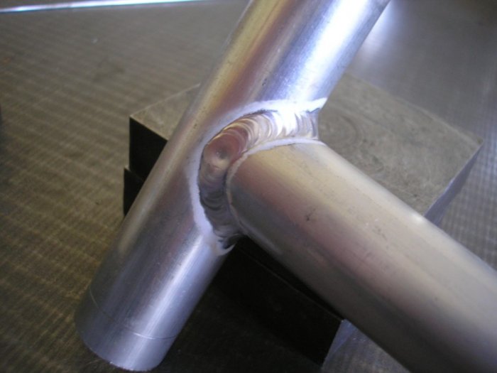

ive only ever used 5356,never had them grainy?
Seems to be the nature of the beast for old transformer machines. Less of an issue on inverters. Lots of stray arcs (just like the area around the weld.).
It does look like too big an arc length and overheating the weld pool. It should get better with technique.
My opinion is the same as it was

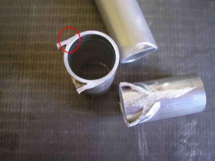

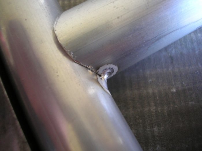

the relevant bits are the tacks with lack of fusion being much wider than the rest of the weld
The goal with a fillet is to get fusion at the root and deposit a weld of sufficient size for the wall thickness
