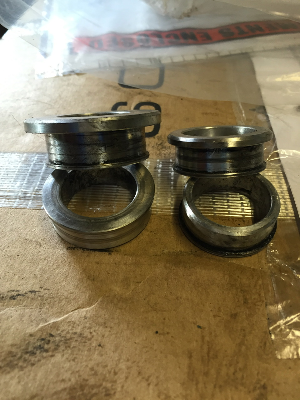

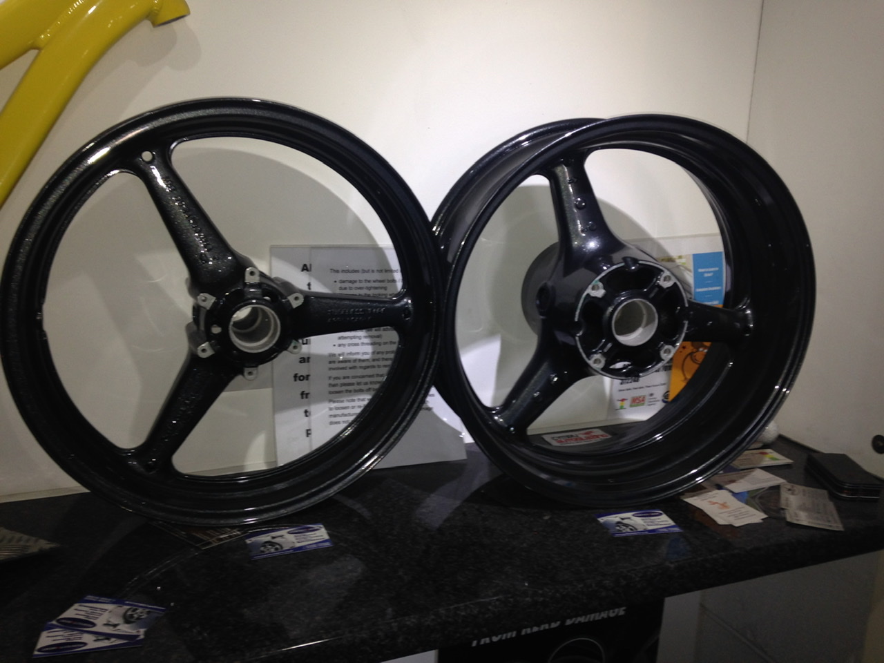

Cheers @Greeves246 that should come in handy.
.......a 1mm lip that goes under the seal is all it takes.
Interested to see the results. Couple of local suppliers there I've not heard of. Could be handy for future. Brynol in Pyle is hit and miss and the turnaround is poor.

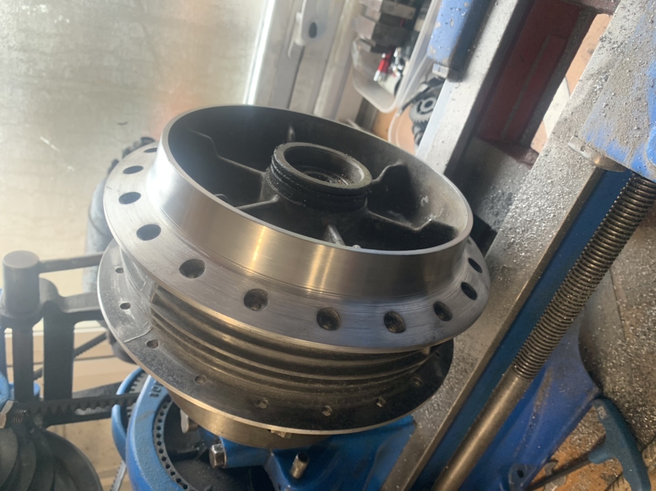

So the spacer is the same diameter all along then score a slight 1mm grove with something like a threading tool.
They have a slight lip that tucks in behind the dust seals in the wheels.
Use them alot on the race bikes as that way wheel changes are so so so much easier!!
