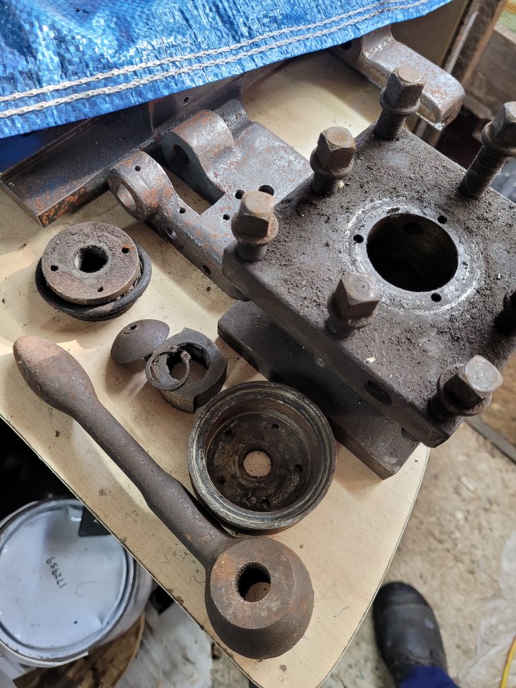

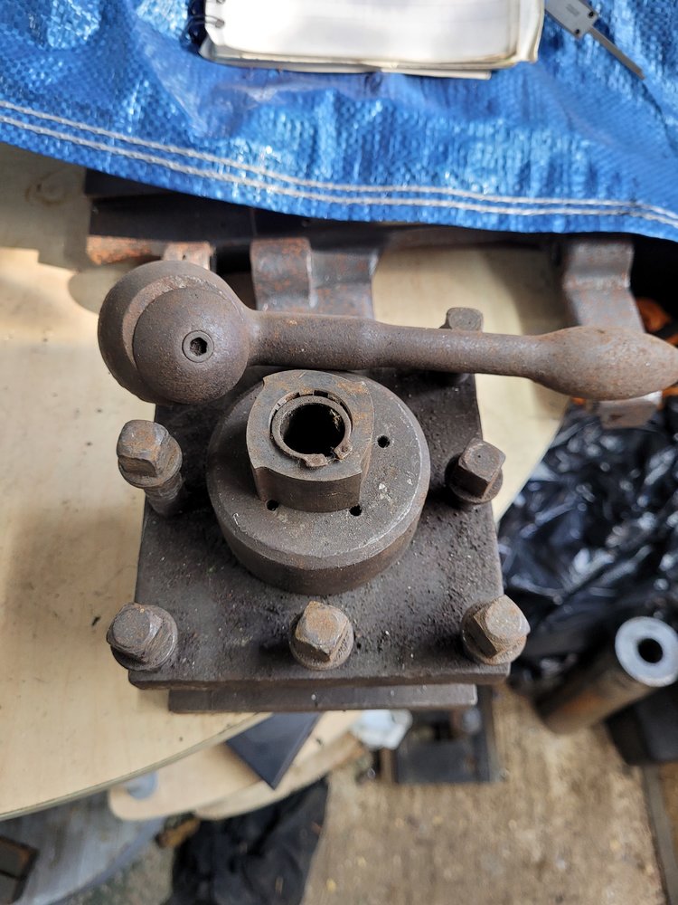

Oh really...I think I have a complete toolpost the same as that. Actually identical
If it didn't index, I wouldn't be bothered. But it should, so I can't help feeling I should sort it.

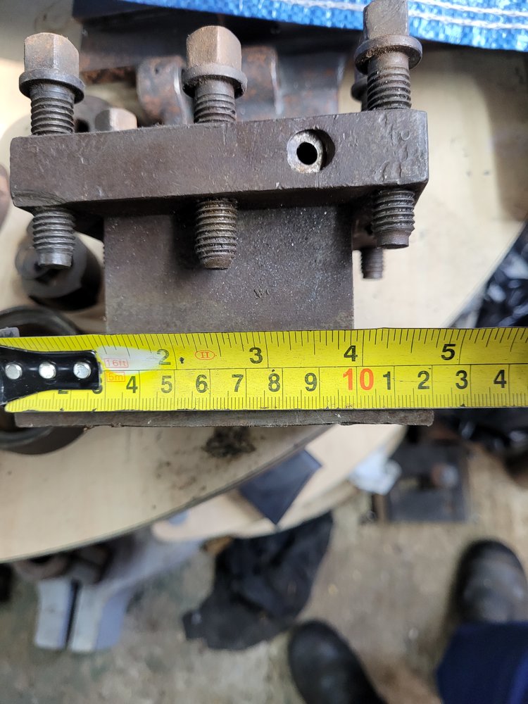

Give me half hour and I will measure it. Its a big ol lump of toolpostOh really...
Yeah, mine is!Give me half hour and I will measure it. Its a big ol lump of toolpost

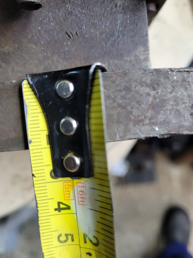

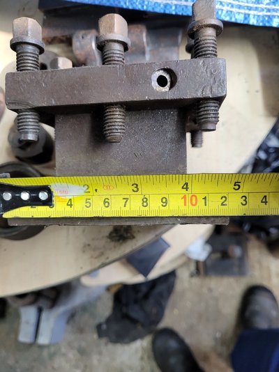

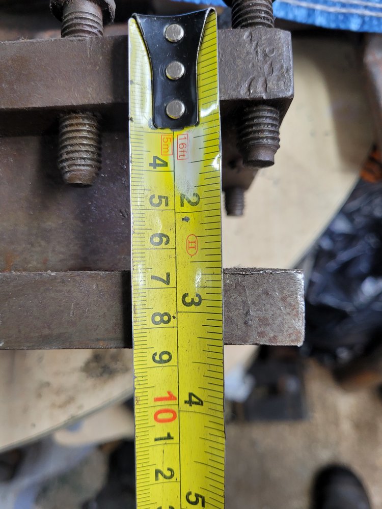

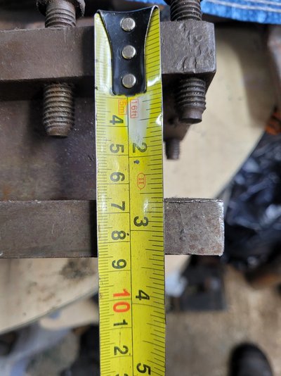

Thank you!Well happy birthday mate. Dimensions and pictures.
120x120mm Square
85mm total height
Top plate/bottom plate 20mm.
Underside hole 54mm
Topside hole 41.5mm
View attachment 399981 View attachment 399982 View attachment 399983 View attachment 399984 View attachment 399985 View attachment 399986

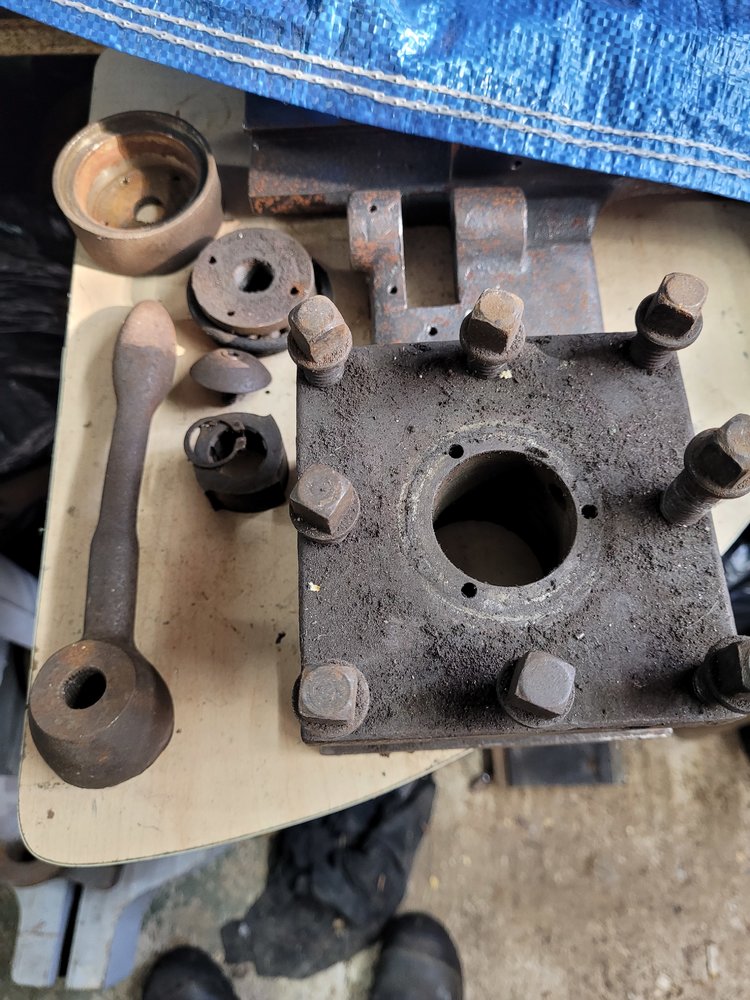

I was just looking at the exploded view of the toolpost. I will have a look for the wedge although it's been kicking about in here foe years so the chances are is probably lostThank you!

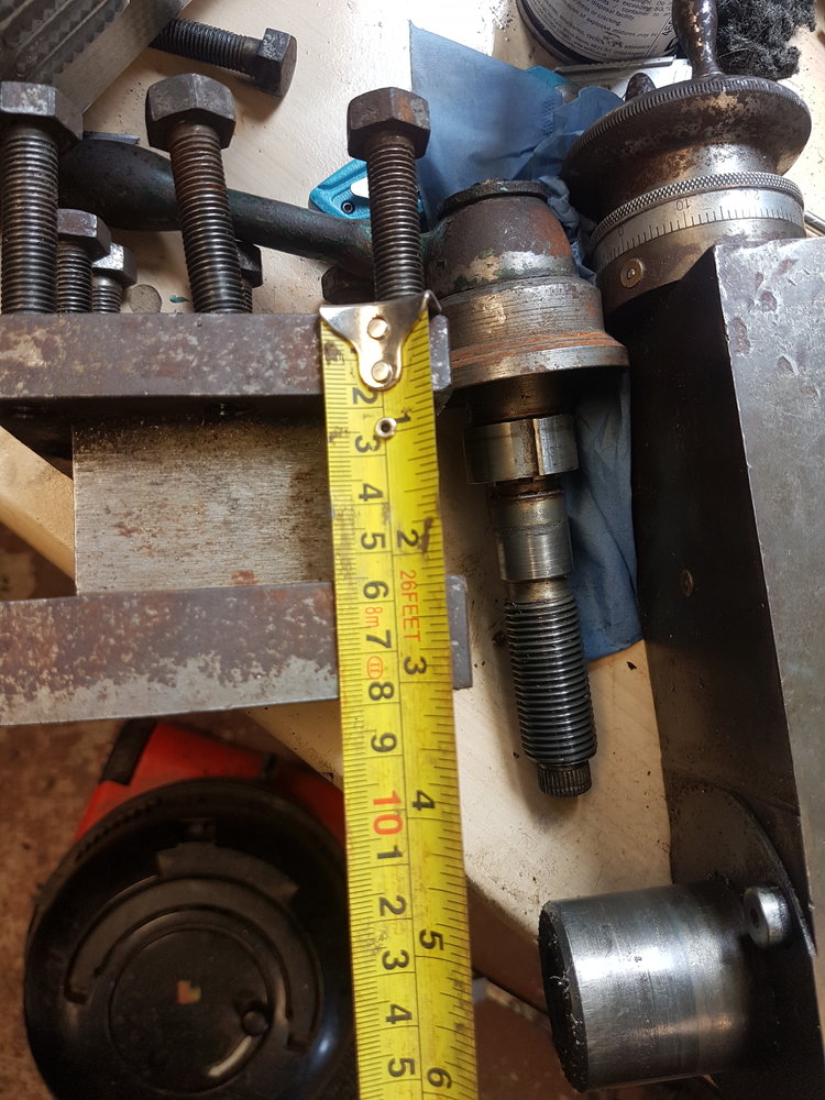

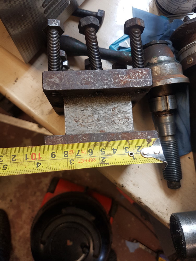

I'll measure mine in a bit when I get in the workshop.
Yours seems to have at least one of the pieces mine is missing. Underneath the grime, yours looks in better condition than mine too.
Do you have the spindle? Or the little rotating wedge type thing that goes on the end of it?
Yes. Mine on yours you would most probably loose tool height centre@Machinery restorations
Mine is smaller than yours. No idea if the mechanisms are shared though, if imagine they are, and just the blocks changed.

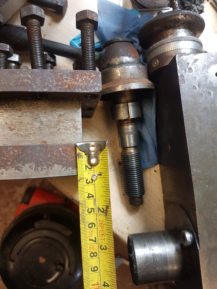

View attachment 400040View attachment 400041View attachment 400042
The base of mine, oddly, is thicker than yours.Yes. Mine on yours you would most probably loose tool height centre
Thrust bearings mate@Machinery restorations
A question if I may though, in your pic, what is the O ring around. I can't tell from the diagram if it's a large spring or a thrust bearing.
Thanks. Couldn't tell if it was a spring to release downwards pressure when undone or a thrust.Thrust bearings mate

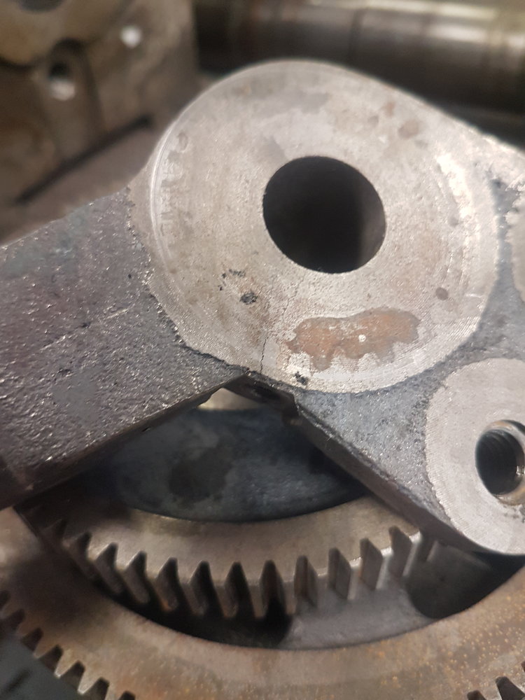

The tumbler is repairable. There is always broken or cracked parts to sort. I get a reasonable amount to do.Another bit of broken cast iron.
So that's 2 gears and the tumbler bracket.
View attachment 400329View attachment 400330
I assume this will want V ing oit and brazing. Looks like im going to get some brazing practice!

Yeah, I'm sure it will be fine.The tumbler is repairable. There is always broken or cracked parts to sort. I get a reasonable amount to do.

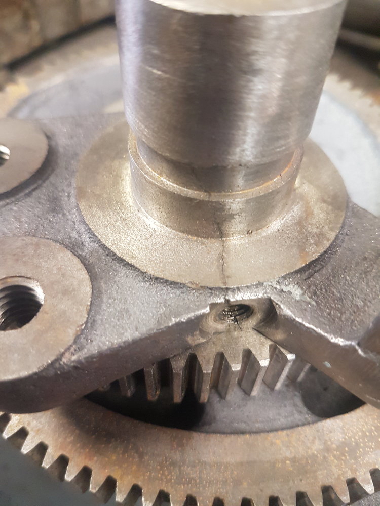

It's part of the parcel of old machinery. Cast gears can be a faff to sortNo exciting updates. Still doing a bit each day though, cleaning parts, sanding stuff.

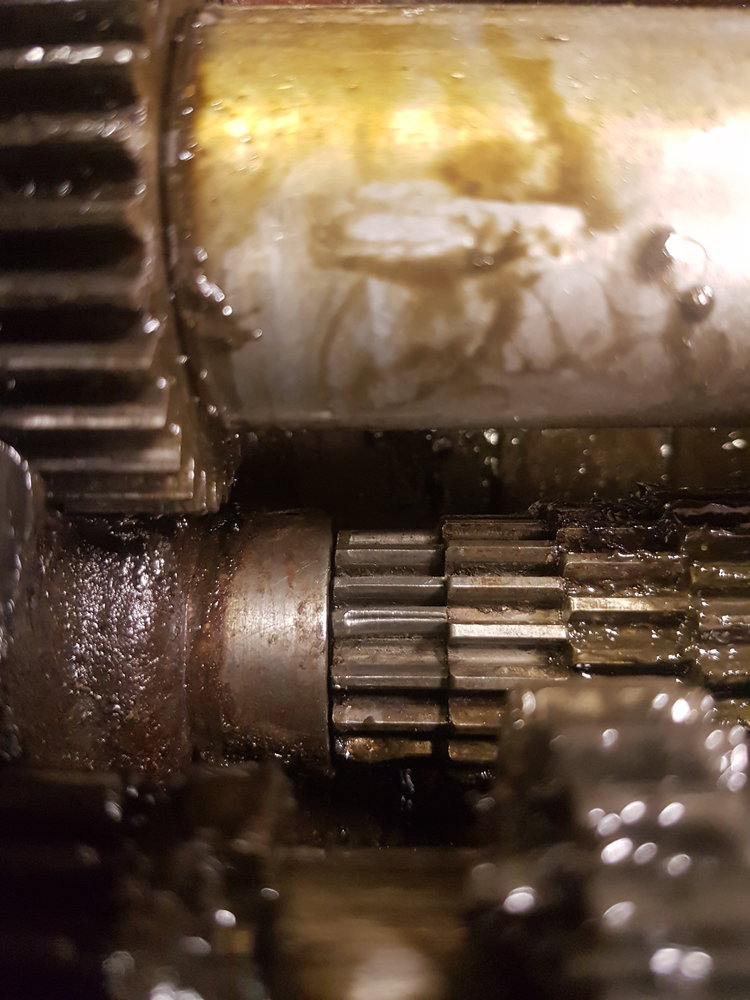

I did find a broken gear (another! Wonder if it was crashed?) In the gearbox. It's FILTH in there and I don't really want to strip it yet, but I pulled a couple of bits out and cleaned the tooth.
Seems it's bent and cracked rather than just snapped off.
These are small gears, and the fact this hasn't just snapped off I'm taking as a sign it's probably steel.
Think I'm right?
It's been run like this, you can see by the wear. You can also see by the wear in the casting where this tooth has been pulling the lever out of gear!
Why you would continue to try and use this gear, quite alot too, is beyond me!
Would be great if it is as I'll just weld it. Handy considering my attempts at brazing the cast gears are currently going badly.
Yep, and I knew about most of them before I bought it, so no complaints, just opportunity to learn.It's part of the parcel of old machinery. Cast gears can be a faff to sort
At least they are already within my skills to sort then.Gearbox gears are probably mild steel, but it's not a rule.
