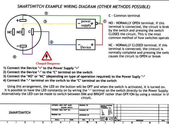

Some might remember posts of mine about building a light box with LED strip to display a pottery item. Well, I bought a switch like this one https://www.ebay.co.uk/itm/SmartSwi...e=STRK:MEBIDX:IT&_trksid=p2057872.m2749.l2649 and set about wiring it in accordance with this diagram which appears in the listing
However, my soldering skills are woeful and after getting all the connecting wires done with appropriate terminals....nothing!!
If I ignore the switch and connect the battery direct to the LED strip it lights up.
I've tried all the options and, in case some of the joints weren't making good contact, have continuity tested them all. They're not pretty but seem to be passing the test(s) fine.
It's now driving me to distraction [after weeks of doing a bit, then coming back to it
] and it'll soon be getting introduced to to Mr BFH! A LONG shot but would anyone who knows electronics be prepared to wire it & get it going for me in exchange for beer tokens? I could post the switch, wires, appropriate new connectors and battery holder along with postage to cover return etc.
Help please if you can, it all looks straightforward but this is really getting to me...........
] and it'll soon be getting introduced to to Mr BFH! A LONG shot but would anyone who knows electronics be prepared to wire it & get it going for me in exchange for beer tokens? I could post the switch, wires, appropriate new connectors and battery holder along with postage to cover return etc.Help please if you can, it all looks straightforward but this is really getting to me...........
