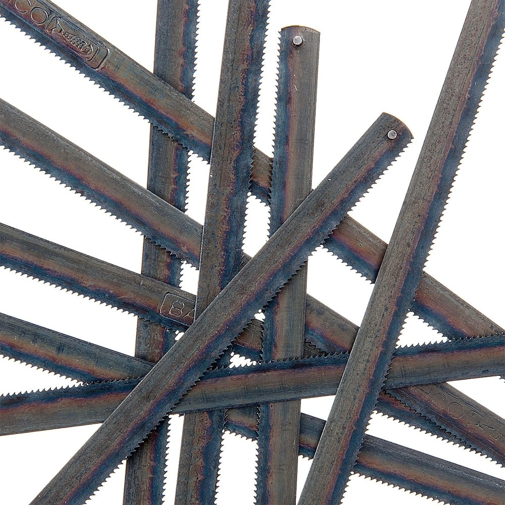

Anyone know of any current production Junior hacksaw blades that are any good.
I tried the following brands
Eclipse had no set and got stuck.
Irwin were very sharp, good set, cut ok but snap because they were too brittle.
Bahco ok on brass, on a 8.8 bolt the teeth just rub off.
Old blades from all 3 brands are far better, the old bacho blades cut 12.6 allen bolts with ease.
The new bahco blades are blue/black all over with no marking, the older blades were stamped with the logo and they have a two tone colour, back of blade bronze and edge blue.
