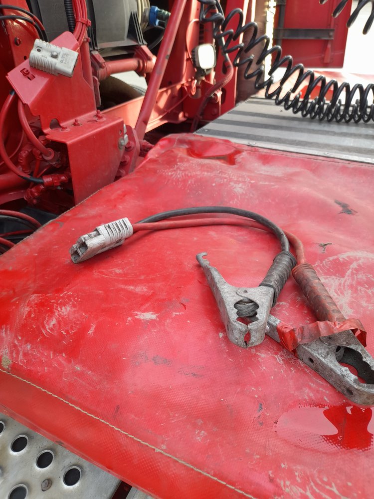

Just had an issue on the wagon this morning that would have been easier if I had a set of loooooong jump leads.

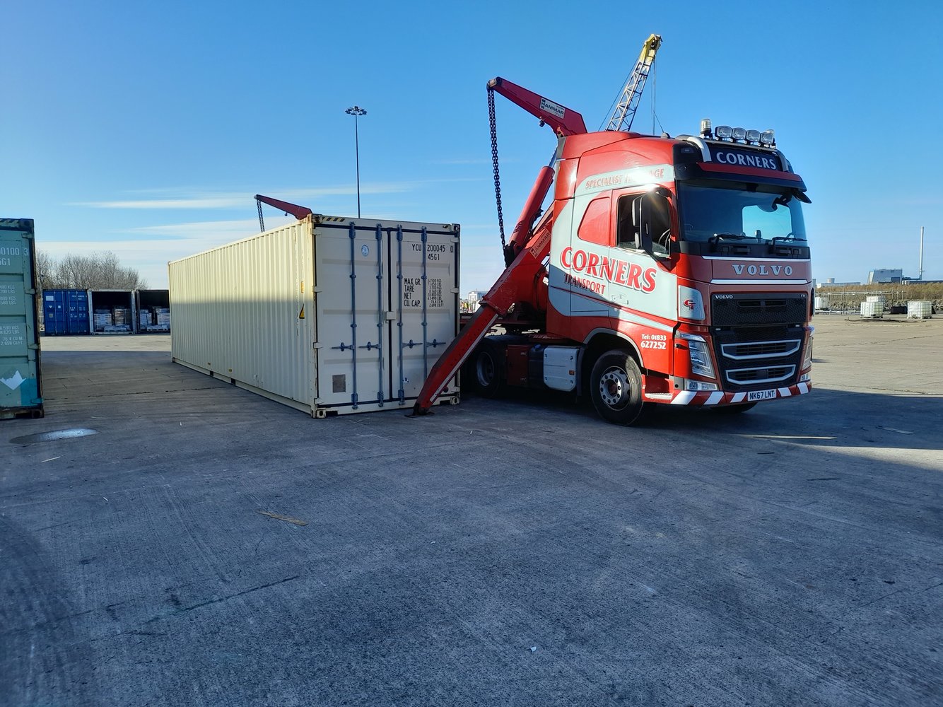

Am at Teesport all week lifting loaded containers off of Teesport's own wagons and the problem was fuel related on the donkey engine for the container lifter trailer:
By the time our illustrious fitter had the problem solved the (single 12 volt) battery on the donkey engine was flat and needed jumping from his van. What I'd like to do is make up a set of jump leads long enough to reach from the lorry batteries to the end of the trailer, 45-50 foot-ish (13.5-15 metres if you're that way inclined...) with an Anderson connector on one end for 24 volts (the connector at the left of the image isn't connected, there's a live one below it behind the cover) and my sexy adapter for 12 volt work:View attachment 474860
What size of cable is good for such items and where is good to buy it? Plain black cable is okay for me for both leads, I'm intelligent (oh yeah???) enough to mark the crocodile clips relevantly.
And for the record I'm happy to do it and pay for it myself as it might help get another wagon driver out of the brown stuff as well as me. My strange ethos is that if I pay for something it's mine and mine alone. If the company pays for it they can quite rightly do as they wish with it and the one time I need it they'll have used it and not put it back... I like being prepared for any eventuality and I'm happy to pay for it. As I said its strange ethos but it's the way I am.

35mm2 for 'usability', just have a bit of patience and let the donor vehicle run whilst connected for 10-20 minutes or so to charge the casualty battery.

I got longer leads with Anderson type plugs on them in workshop for Battery Support units.

I just bought like 3 cheap sets of leads that had the same size cable and did my own ends, picked the best Croc clips and put them on a short fly lead on an Anderson plug.
