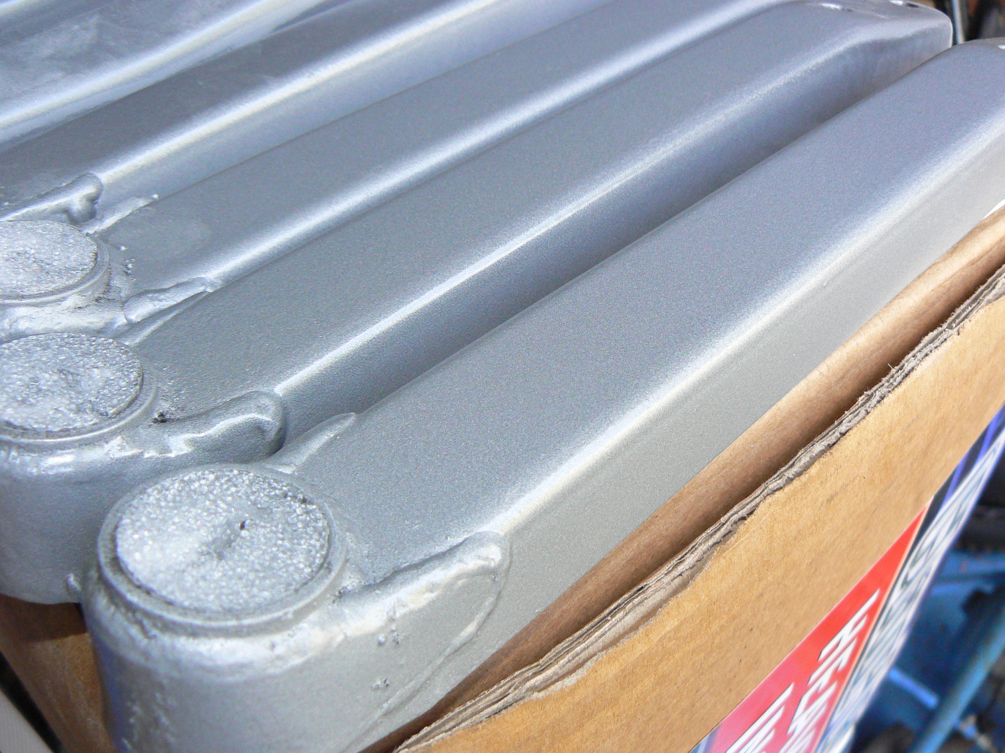

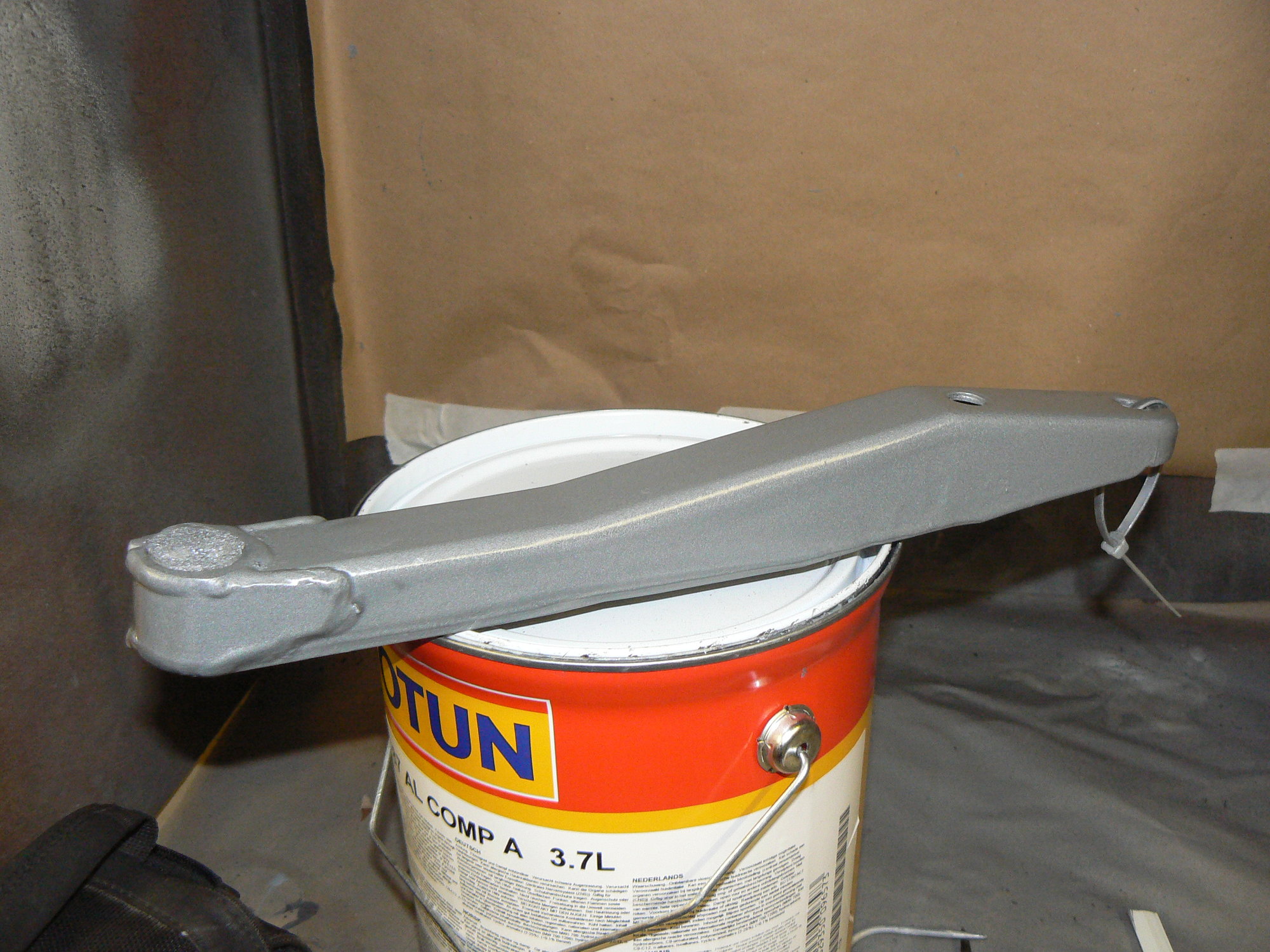

Having read a lot of the theads on here on use of Jotun 87 , I have now used it for the 1st time. Putting it onto bare metal suspension parts and spraying (Standard air spraying, HVLP Gravity gun, 2.5 tip, 40psi at the gun, 4:1 Jotun/Hardener with 15% #17 thinners). Sprayed very easily.
My question is, what sort of colour have others achieved with this paint? Mine have turned out as a very nice grey but I having to use a lot of imagination to see any aluminium/silver. This is after very well stirring the paint with 2 different shapes of stirrer in electric drill and then "picking" paint with a scoop from the bottom of the 4L Jotun can.
I had hoped for more silver content, but see pics.
