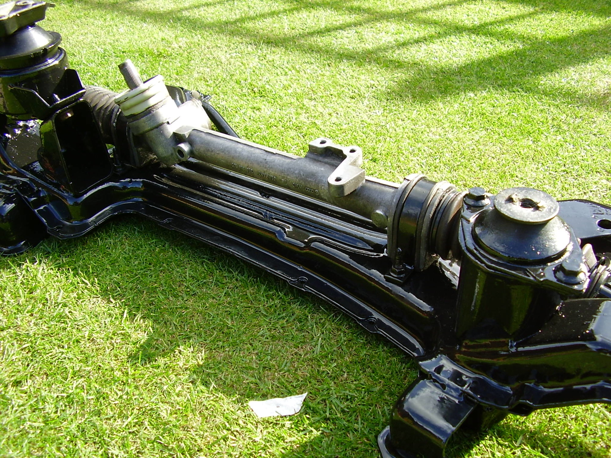

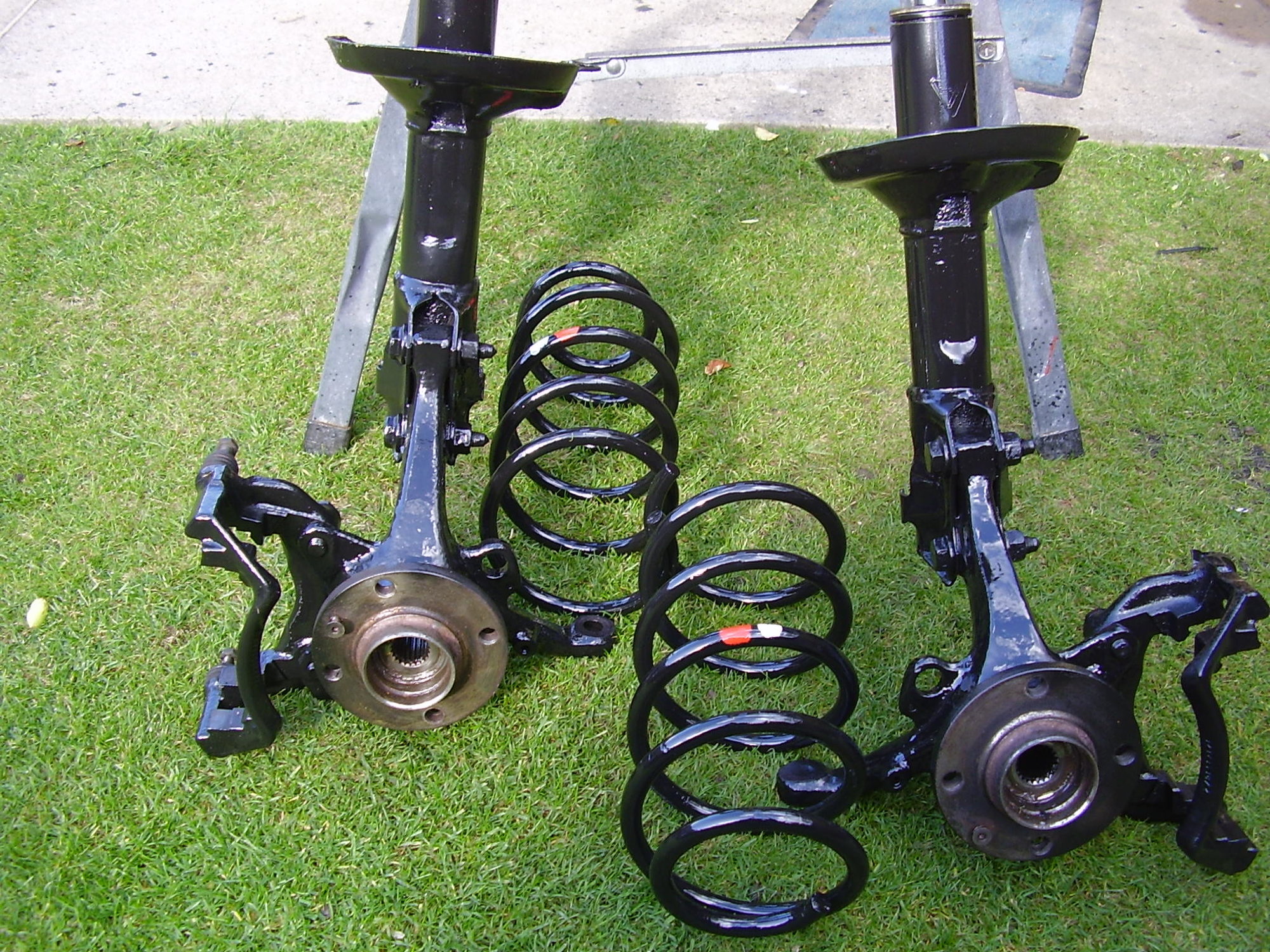

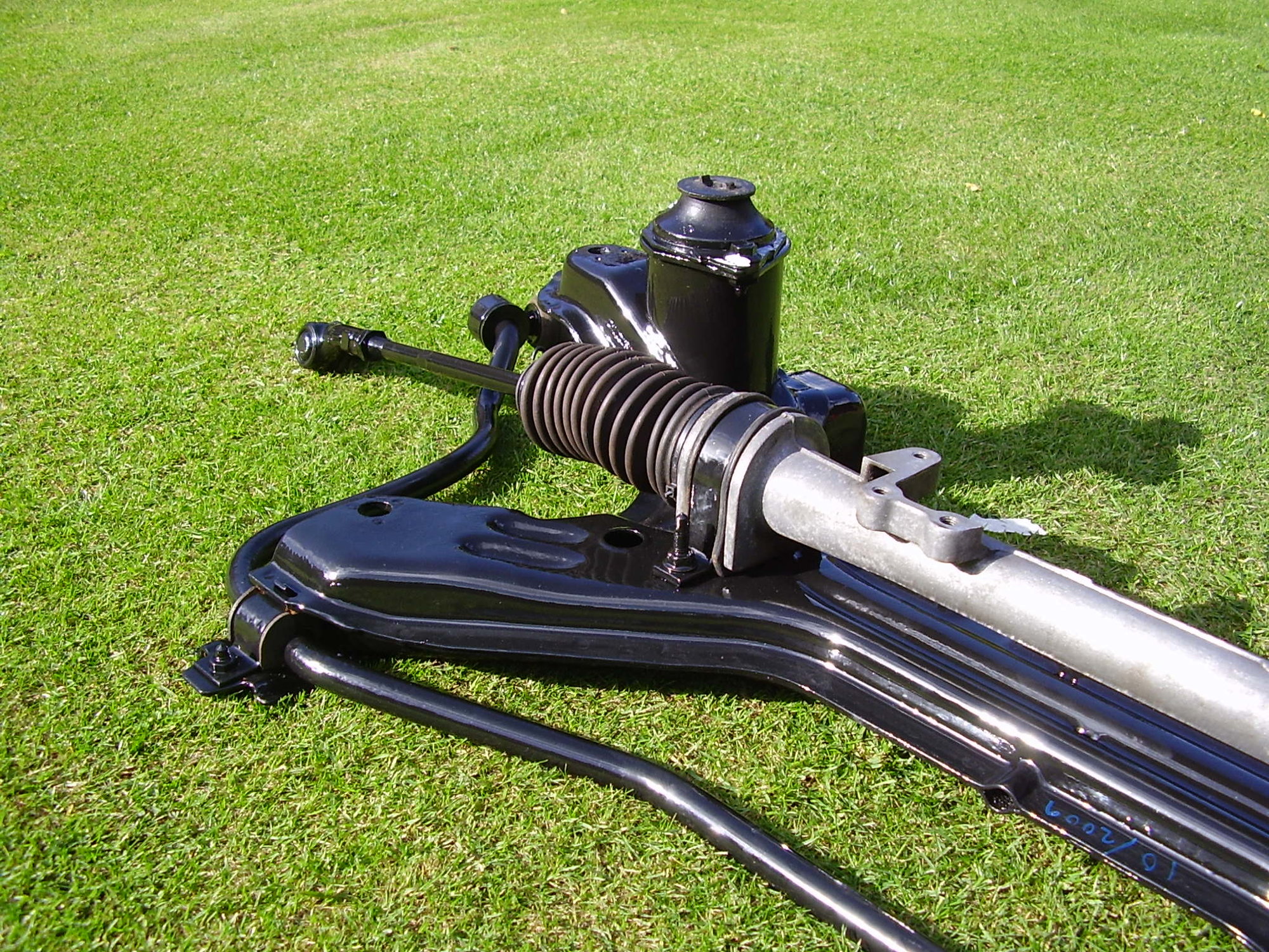

  8. steveo3002 Member
    Messages:
    5,240
    cambridge uk
    i was pretty happy with mine that i did with rustoleum black , also use aldi metal paint
