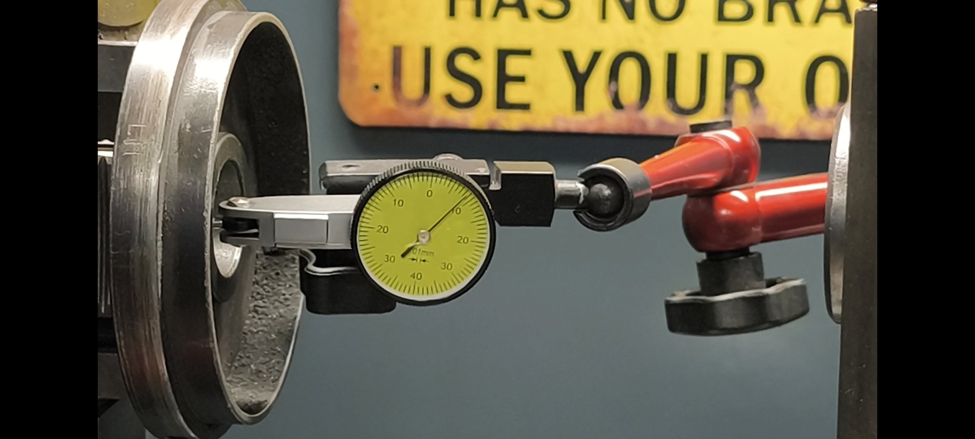

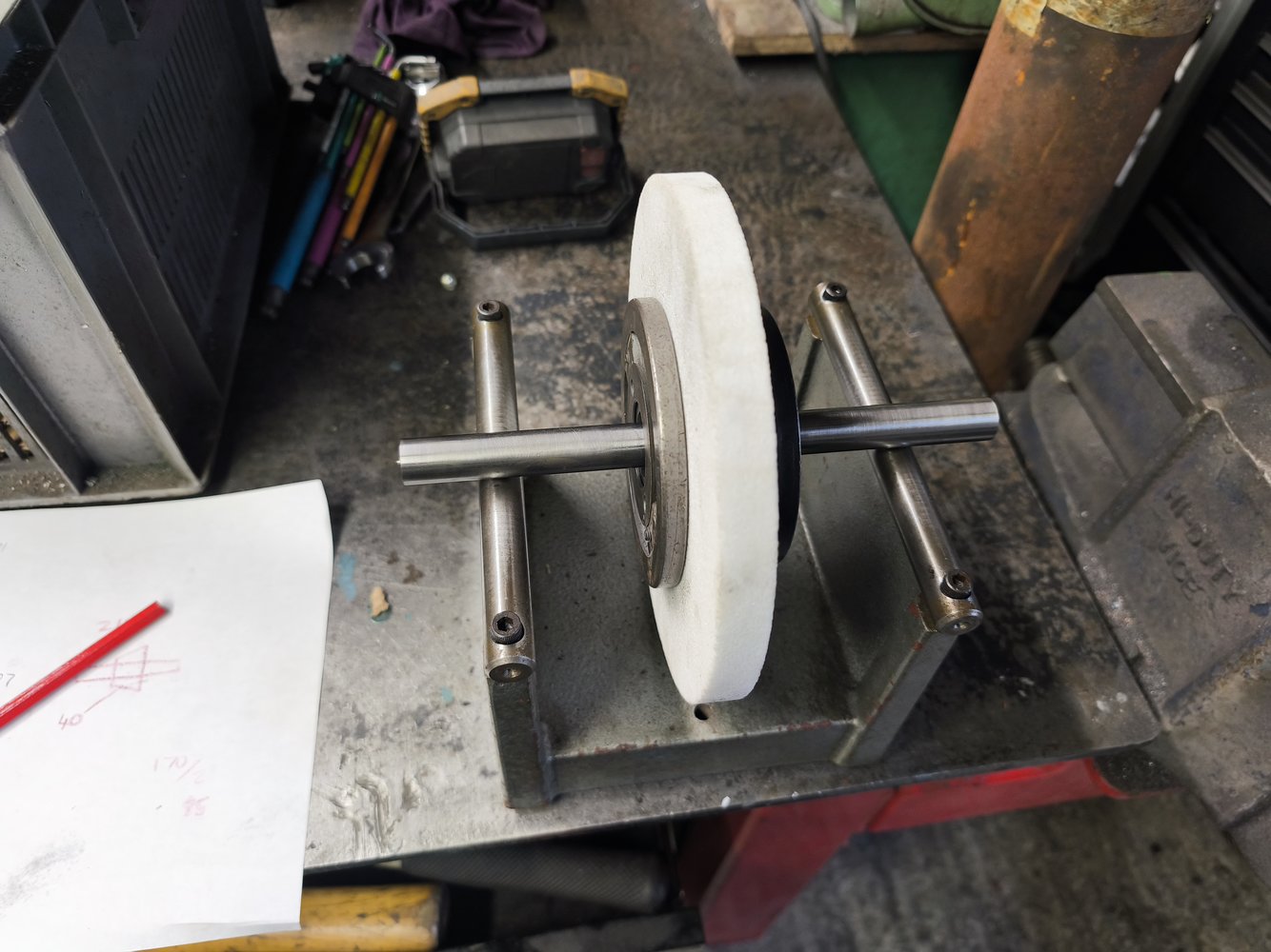

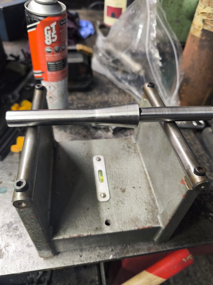

The arbor is nothing special. You can copy the taper from the wheel flange. Mount it in a chuck and swivel the compound until it matches the inside taper.
This place says 15 dungarees:
You can measure the flange taper using two balls of differing diameters and a height gauge.
European spec. ones are 15 degrees. North American ones are 3" per foot.

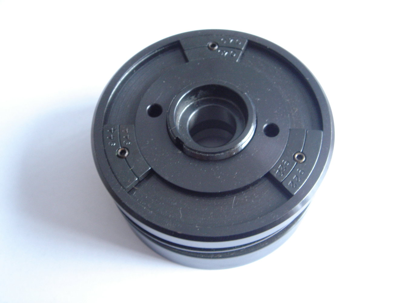

Jones & Shipman 540 grinder hubs/adapters
I have one of these grinders and am confused (not a rare condition for me). I know several readers of this forum have J&S grinders so maybe one of you can un-confuse me. My grinder came with one wheel adapter. I'd like to get one or two more. Since it's a wet grinder, it is about 3" OD, with a...
www.practicalmachinist.com
WTB: some 1 1/4" wheel hubs for Jones & Shipman 540 grinder
My J&S 540 surface grinder came with four wheel hubs for 2" (50.8mm) ID grinding wheels, which seem to have been common in West Germany in the late 1980s. But these days there are a lot more grinding wheels available with 1 1/4" IDs. So I'd like to get a handful of those hubs, but would like...
