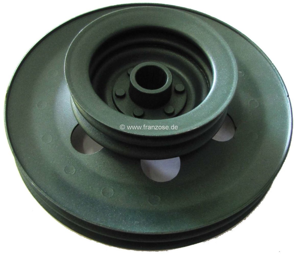

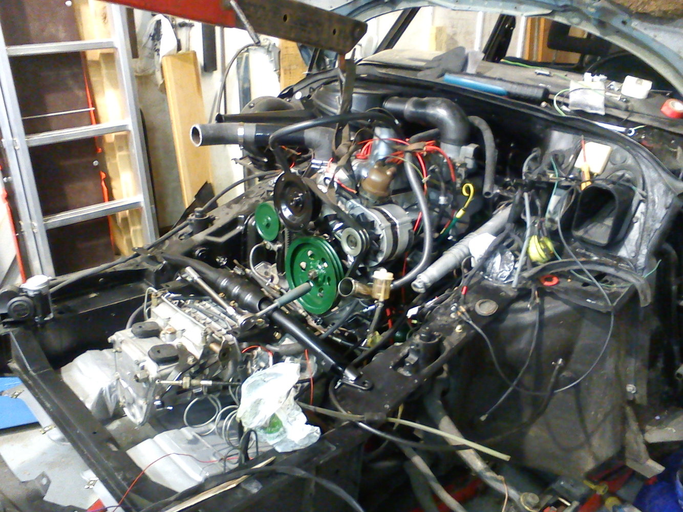

Hello, this is for my 1972 Citroen DS.
Citroen used two V groove steel pulleys for the drive belts to the water pump, alternator and hydraulic pump (belt and braces, two belts to water pump and alternator, two to the hydraulic pump). On the semi-automatic versions they used a three V groove pulley on the hydraulic pump, the additional groove was used to drive a centrifugal regulator.
I use the third groove to drive the air conditioning compressor which I installed. All the drive belts are driven by the camshaft, meaning the hydraulic pump runs at half engine speed. So too does the compressor drive.
I would like to increase the diameter of outer groove from 100mm to 125mm to increase the speed of the compressor.
So far I have toyed with the idea of machining off the outer V of a 100mm three groove pulley leaving just a stub and then machining the inside of a 125mm pulley to be a heat shrink fit.
Or take a very light cut from the face of a 125mm pulley to align the 100mm pulley centrally then pay for someone to TIG the two together.
Or bolt them together.
Has anyone done this before?
Has anyone any advice or suggestions?
