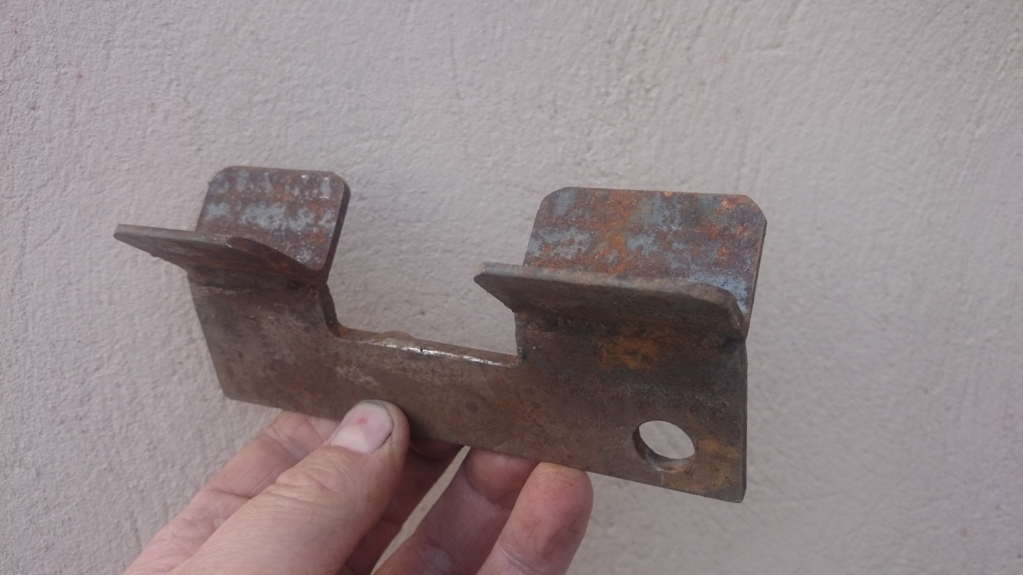

This is a little fixture for joining things straight
The centre cut out is done as the last step in its manufacture, so the angle is dead straight at both ends View attachment 83667 View attachment 83667
Those are more useful for joining rounds end to end, I have some stainless ones somewhere used for setting up pipe joints on site, mine also have a bracket over the top with a clamping screw to hold it all together without the use of G
