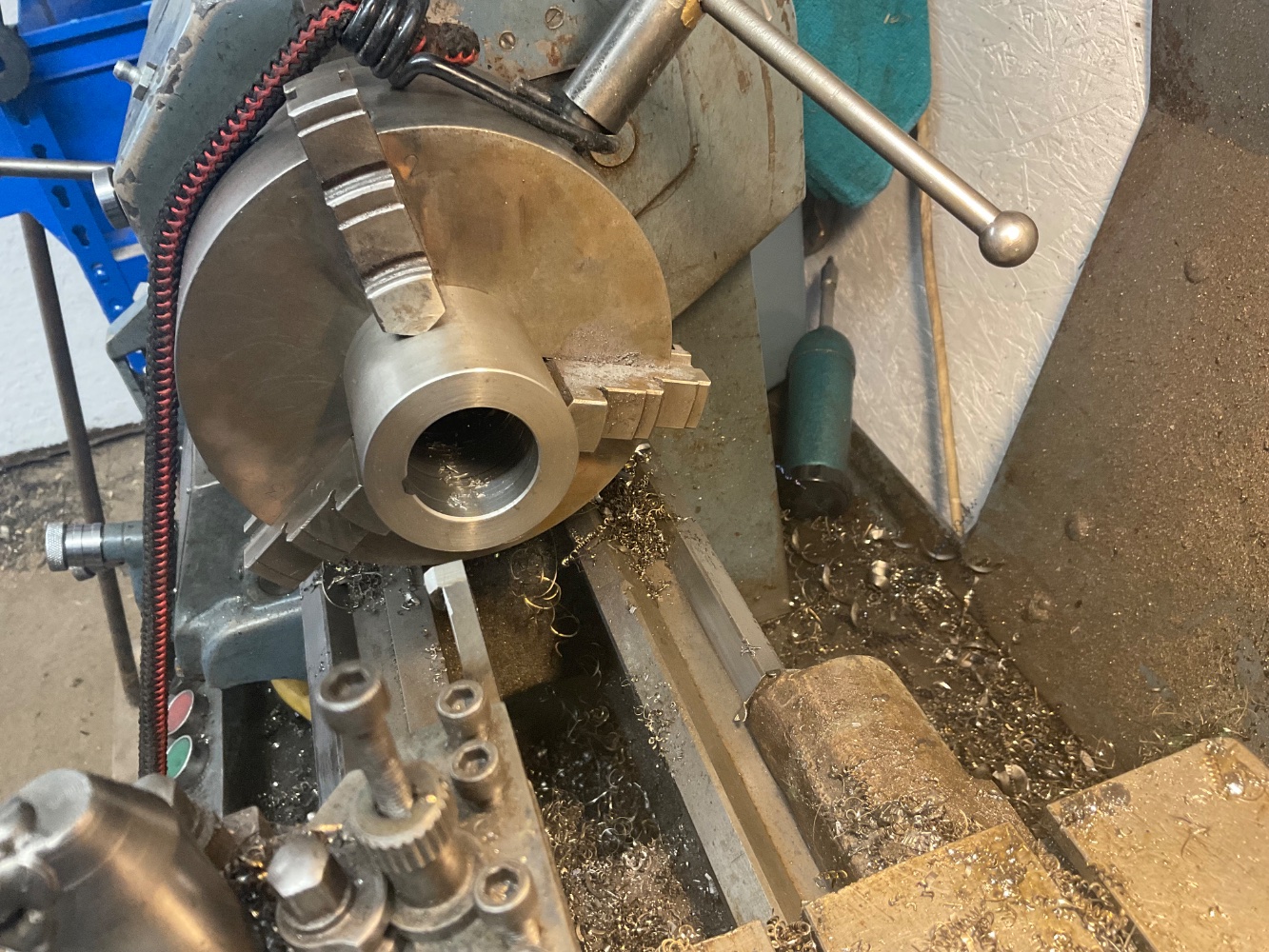

Might try making an insert anyway, for practice.

It’s what I had in that size. I was hoping it was only induction hardened on the surface, which has been machined away.Is that too hard? Thinking you'd want the easier to disassemble part to contain the sacrificial/softer repair part.
