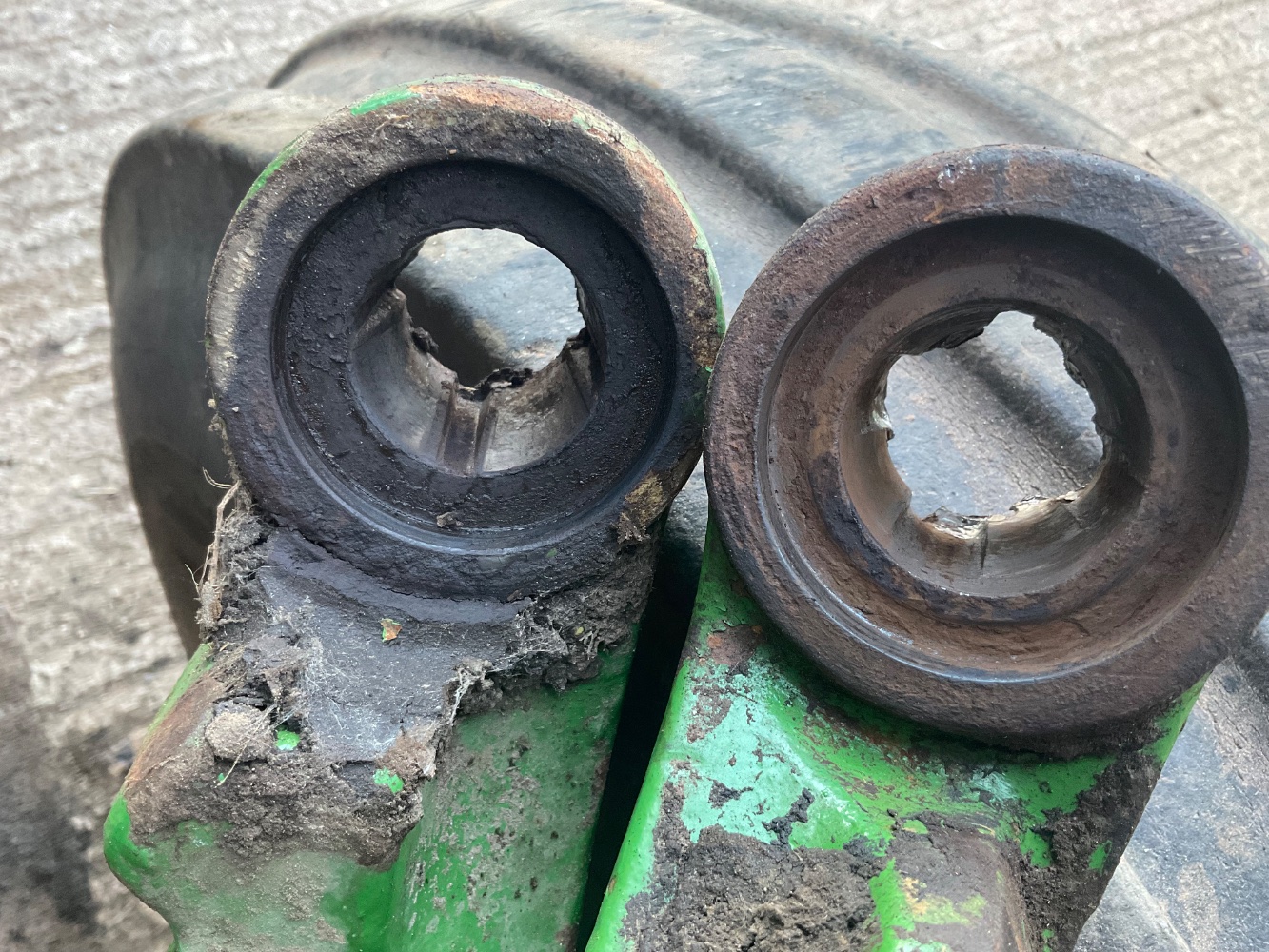

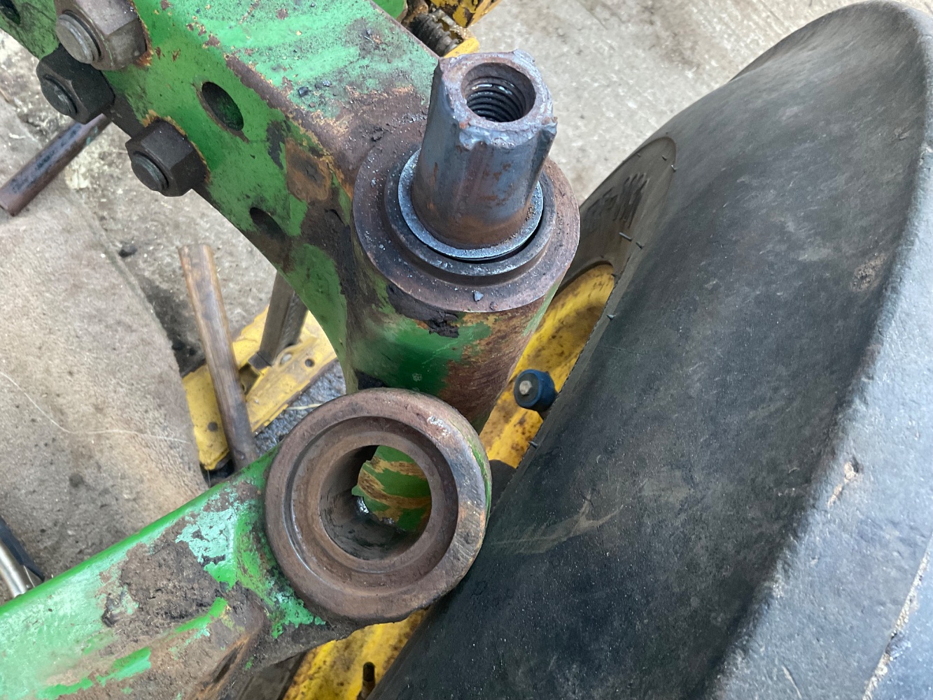

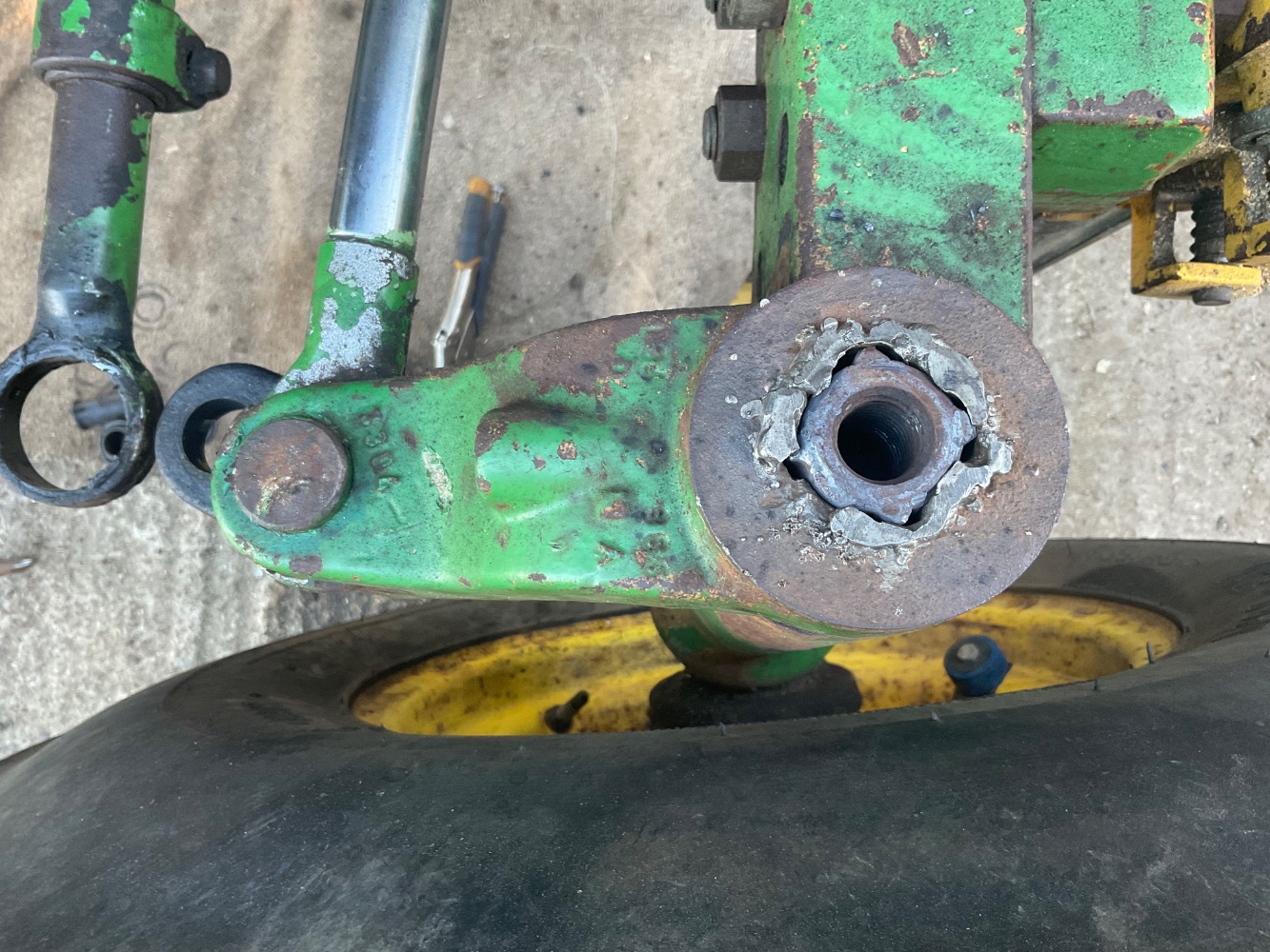

Constant loading though in one direction I'd imagine in that application? This one will be getting shock loads all over the place.We've used it on compressor shafts and vanes spinning at a few thousand RPM
Nothing like the torque put through a lever arm like this though. Potentially with really high dynamic loads too.We've used it on compressor shafts and vanes spinning at a few thousand RPM
Belzona 1111 is commonly used to build up wear surfaces and remachine. Pig launchers door seals, and high pressure #2500 flanges. Pump casings too. Only down side its blooming expensive to buy.It will survive. It's used all over industry - it's a bit more special than a bit of JB weld!
Even if you had to do it every year or two would it be the end of the world?

Might try making an insert anyway, for practice.
That Belzona 1111 looks the stuff, but 1kg for £300 is a bit beyond me. They should sell small splats of it for £20 and open up the amateur market.

It’s what I had in that size. I was hoping it was only induction hardened on the surface, which has been machined away.Is that too hard? Thinking you'd want the easier to disassemble part to contain the sacrificial/softer repair part.
