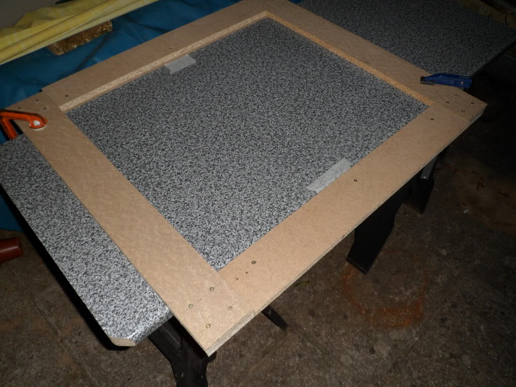

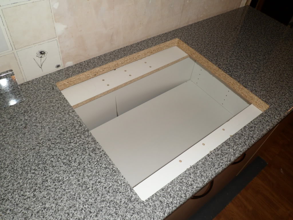

Once you cut out the sink area
I alway wipe round Mastic on the edges and leave to go off that way if water does seep under the sink once the Mastic has failed it does not damage the worktop and hope they see water underneath before the Mastic on the wood fails
