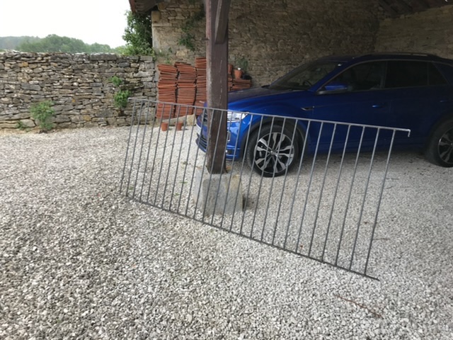

Hi Guys looking for advice/ideas to make a jig for a quantity of steel grills. 12mm x 800 rod welded top and bottom to 1" flat. Something to hold it while tacked together. Cheers

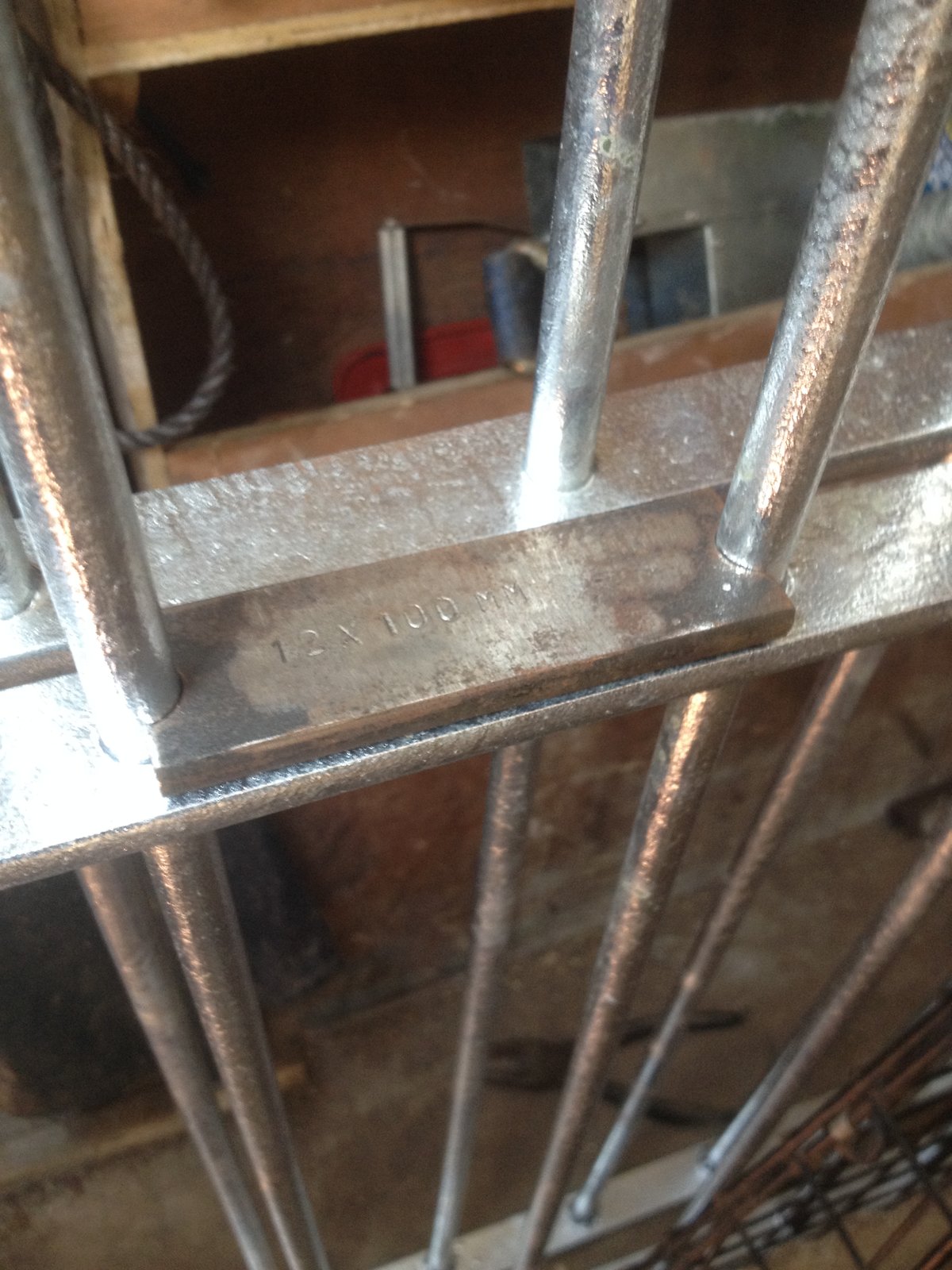

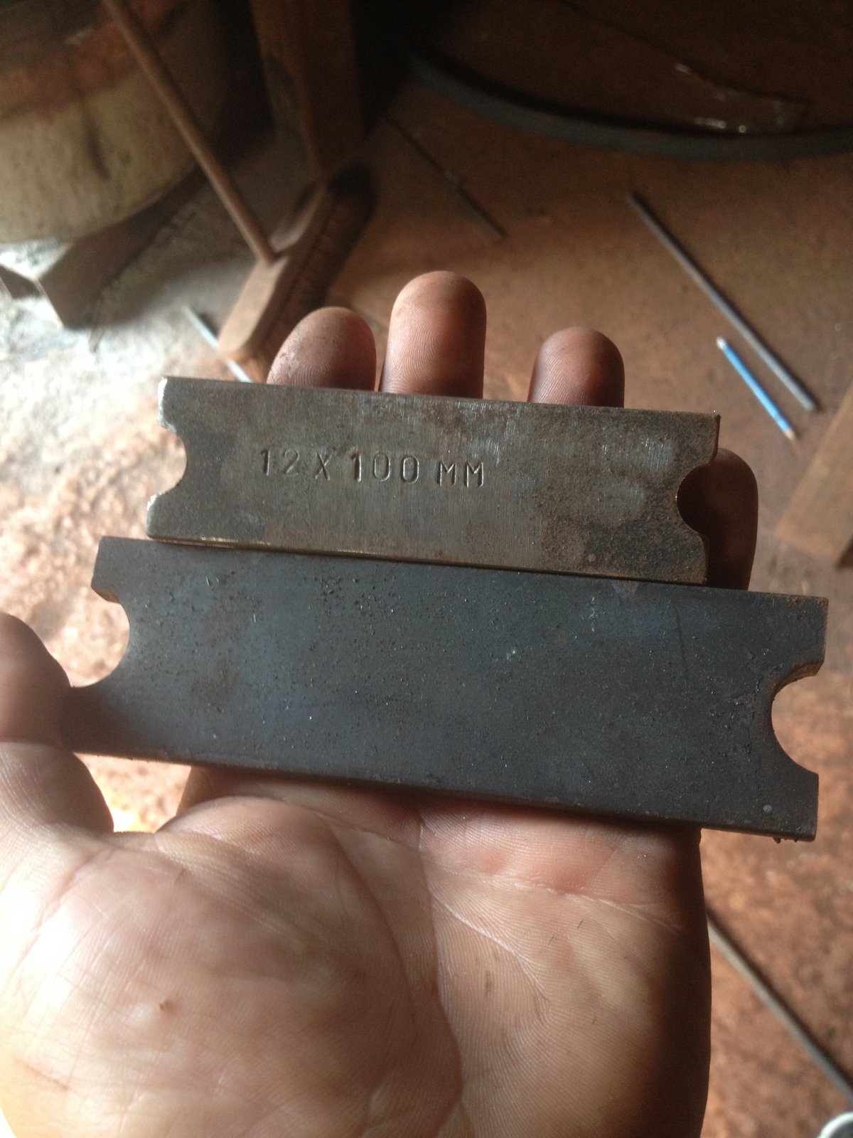

If you're looking to do a fair number of grills, then I would go with @brightspark's idea. If it's a one-off then I'd just mark a centreline for where each bar goes, having worked out the right pitching, and tack them in. Even with doing this by eye, it will come out looking pretty accurate. That one-off can be your template for positioning the bits of angle for subsequent grills.
