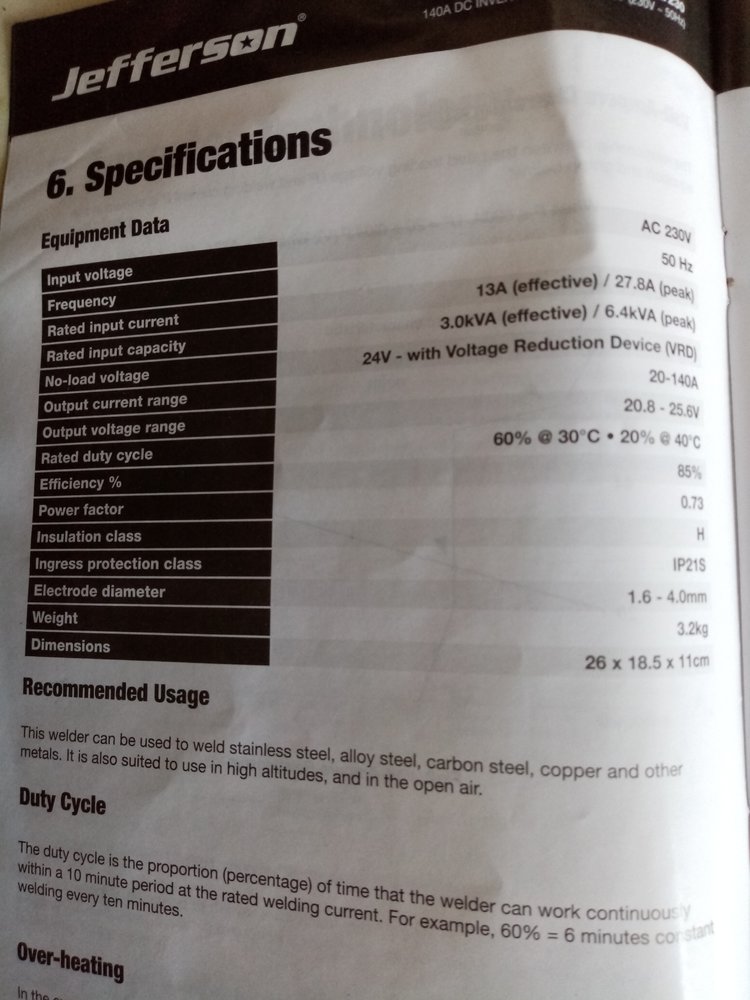

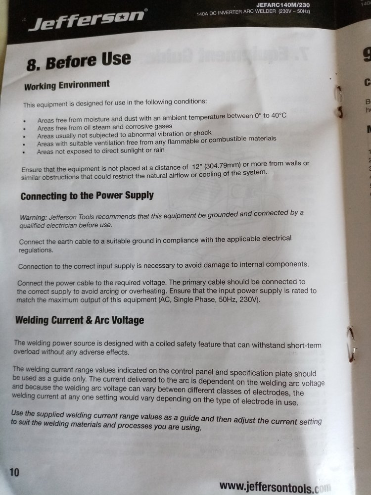

I bought a Jefferson DC inverter welder 140AMP and on reading the manual it states they recommend it be grounded and connected by a qualified electrician before use?
The welder comes with a 3 pin 13 amp plug already connected when buying it or am I missing something?

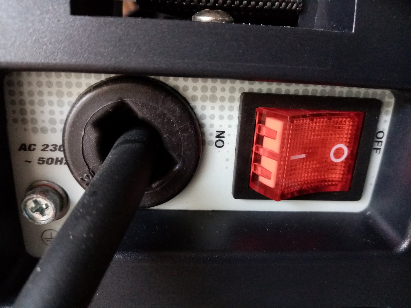

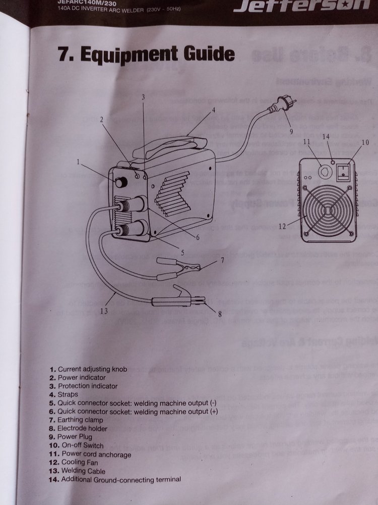

Also can someone tell me what's the additional ground connection fig. 14 and pic attached of it for?
My older welders never had this?
