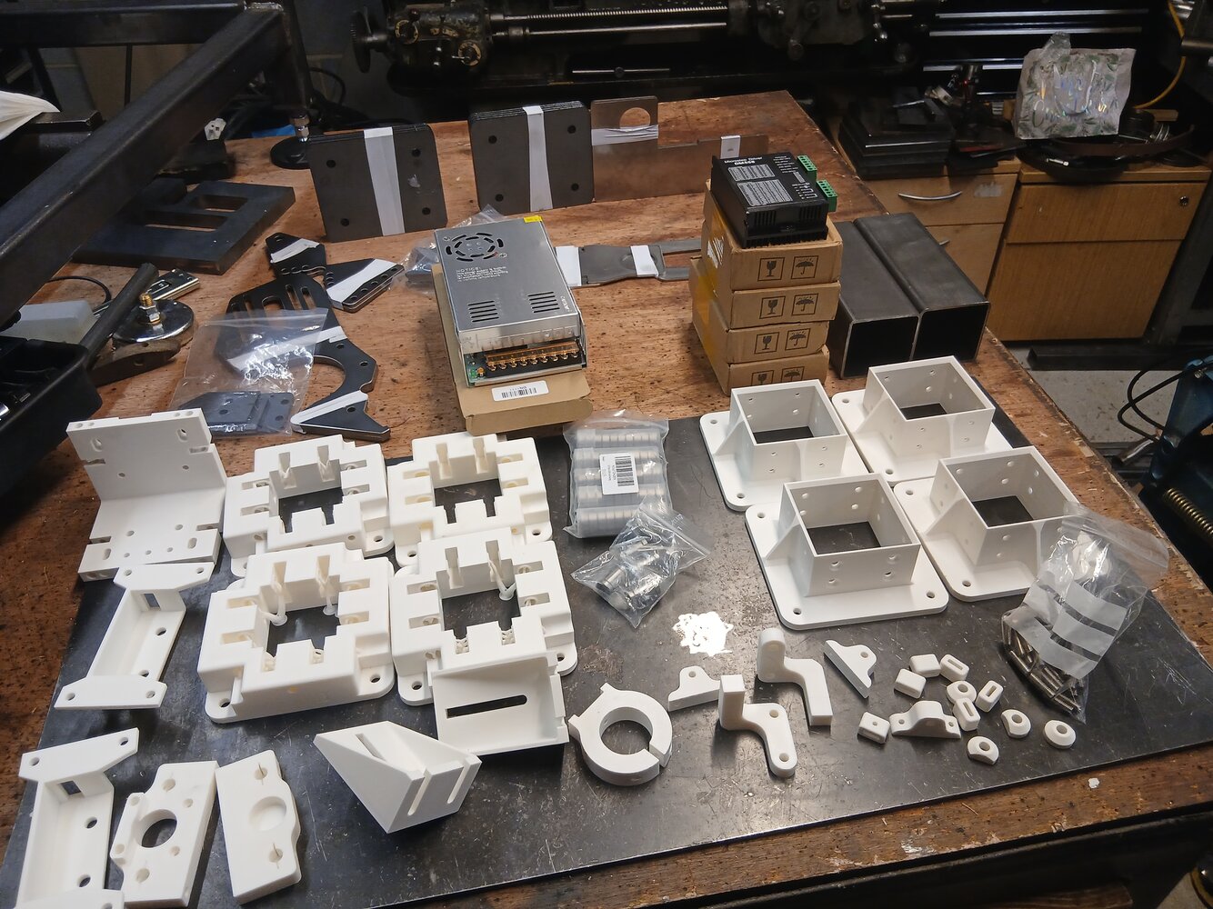

If you have designed it parametrically can you adjust the percentage of size to compensate for the shrinkage .......... say 6% bigger ?I bought the plans and am collecting bits and pieces. But I also plan on making the bearing blocks out of aluminum. I have a home foundry and have cast a fair amount of things.
One possible method is to 3d print the bearing blocks and then use those as a pattern to cast them in greensand. However, due to the unavoidable shrinkage of the aluminum, I was wondering if anyone has a drawing and dimensions for the bearing blocks. I'm sure I could print them, and then reverse engineer the optimal dimensions to end up with a good casting, but if a drawing with dimensions is already floating around, I am not opposed to saving time.
By way of introduction in my first post, I'm an optometrist (somewhat retired) and I also have a nice machine shop. But no plasma table, which would really add a lot to the workshop's capabilities.
