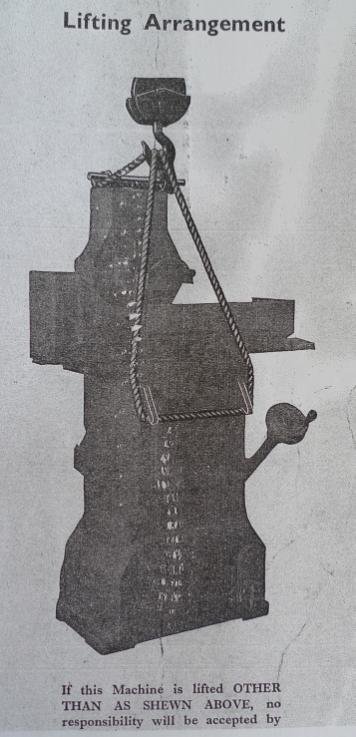

From the J&S manual it has a nice picture on how to sling the grinder using 2 eye bolts on the top of the column and the ears cast into the front of the machine

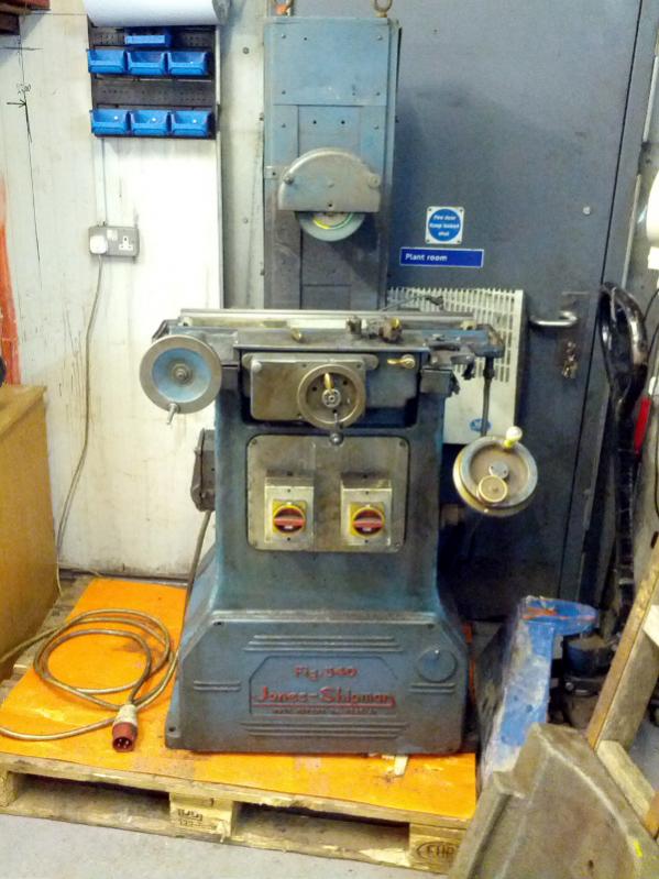

Unfortunately mine is an early one so does not have the ears on the front. Picture below is not of the one I've bought but is the same design
