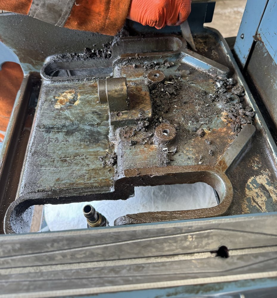

I haven't got the dresser on the wheel head but I do have coolant and dust extraction.
Just got it up and running today after having it since last November. Doesn't look too bad in the hydraulic tank but it's coming out for a clean anyway
I didn't, because that would require complete stripping of the hydraulic block, and there is nothing wrong with the hydraulics on mine.Good work.

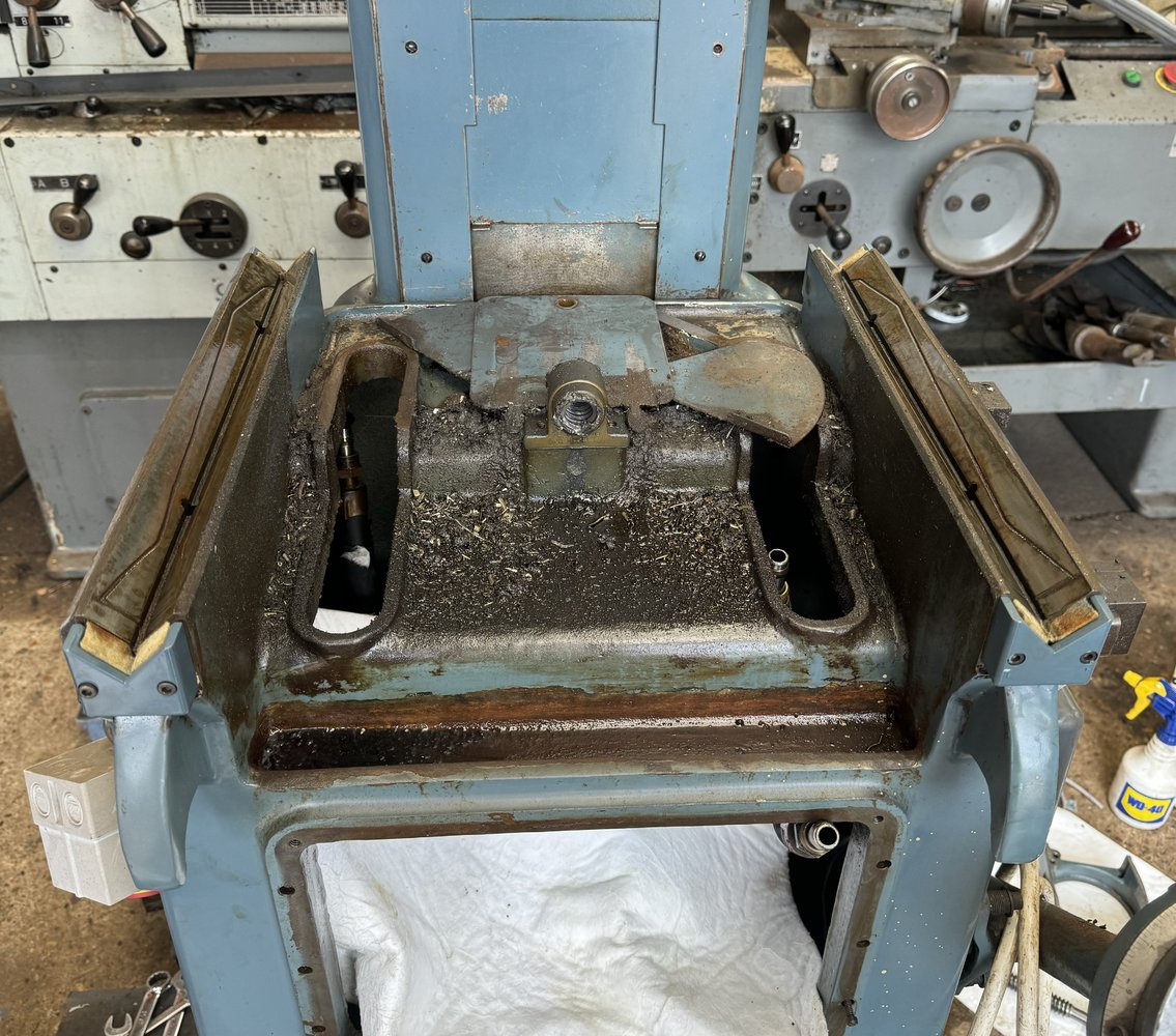

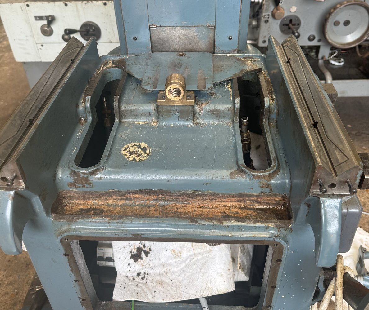

How do you remove the bit with all the feed controls on (the table base)? Definitely not the correct term
I had my table off, but did not go any further. I probably should to make sure all oil ways are clear.
Thanks. That is all I need to do too.I didn't, because that would require complete stripping of the hydraulic block, and there is nothing wrong with the hydraulics on mine.

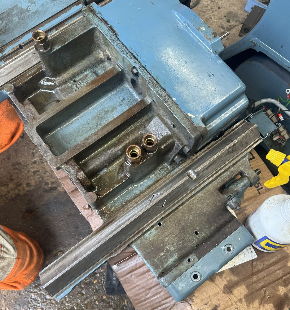

Me and @Arclikeharrypotter undone three hoses and brass oil line, removed table, removed cross slide leadscrew/handwheel assembly, then lifted entire saddle and hydraulic block off in one go. Circa 80-100kg.

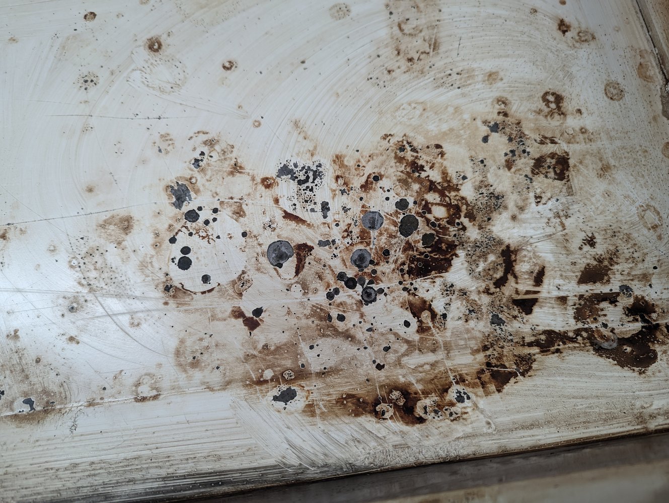

I can guarantee if it's ever been run with coolant that there will be corrosion in the bottom of the tank where the water and oil has separated.
No but to be honest they don't achieve much. Jubilee mac or andmar might have some.There is a little bit, nothing a buff and a lick of paint won't solve. The filter was chocked solid with gunk, only the water could pass through.
