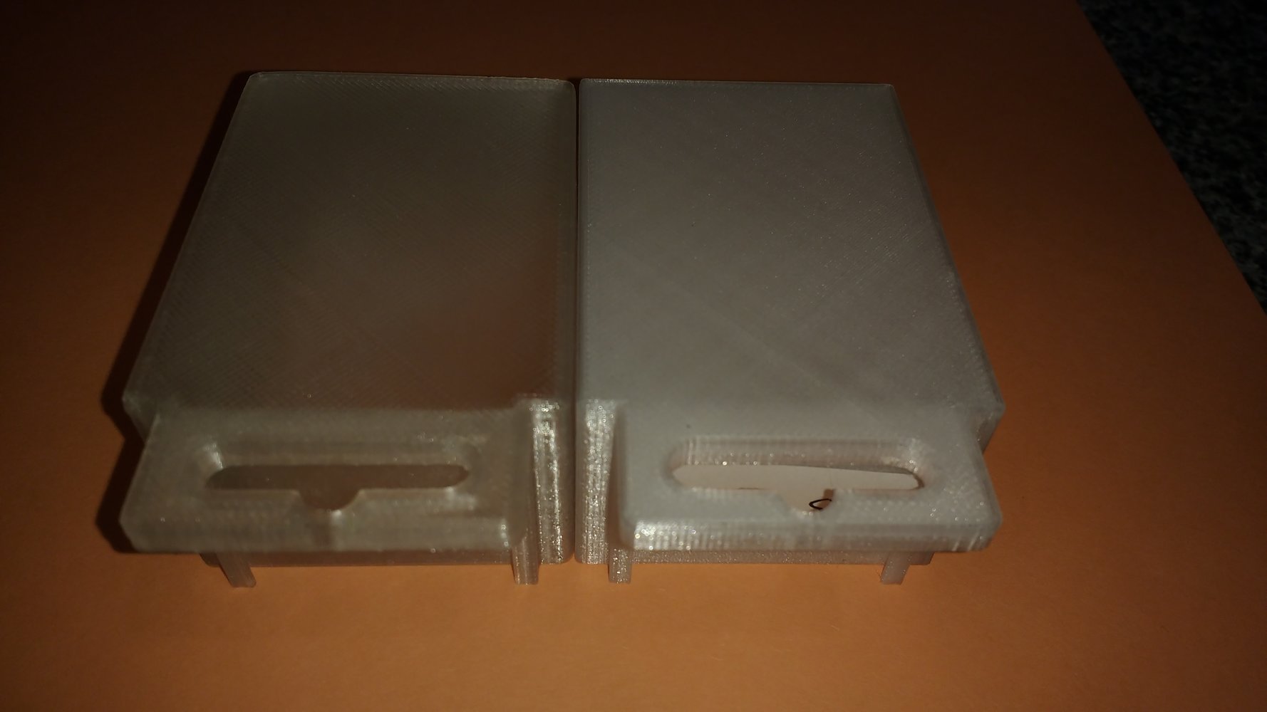

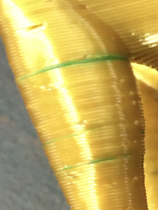

Slightly clogged nozzle? Maybe try a cold pull when changing filaments...Now this is interesting... The pen holder test finished but has ABS contamination in it!

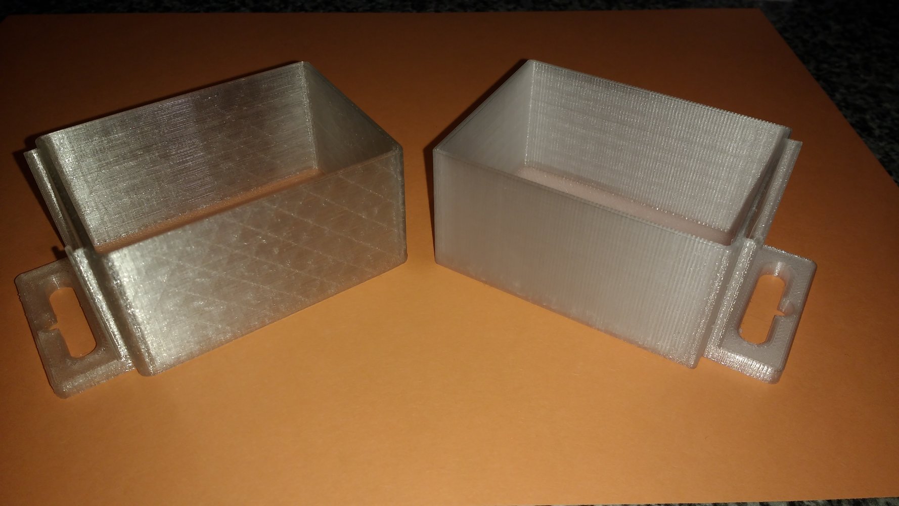

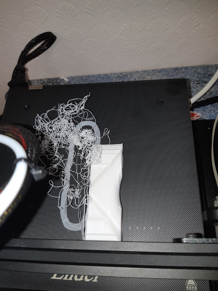

Came back to find this..... have adjusted the bed and started again....
The brim looks much more solid this time
Have upped the temps a bit .. had got the hang of the 1st roll of filament.. this seems different.. less stringy between things but also less stick on the bed

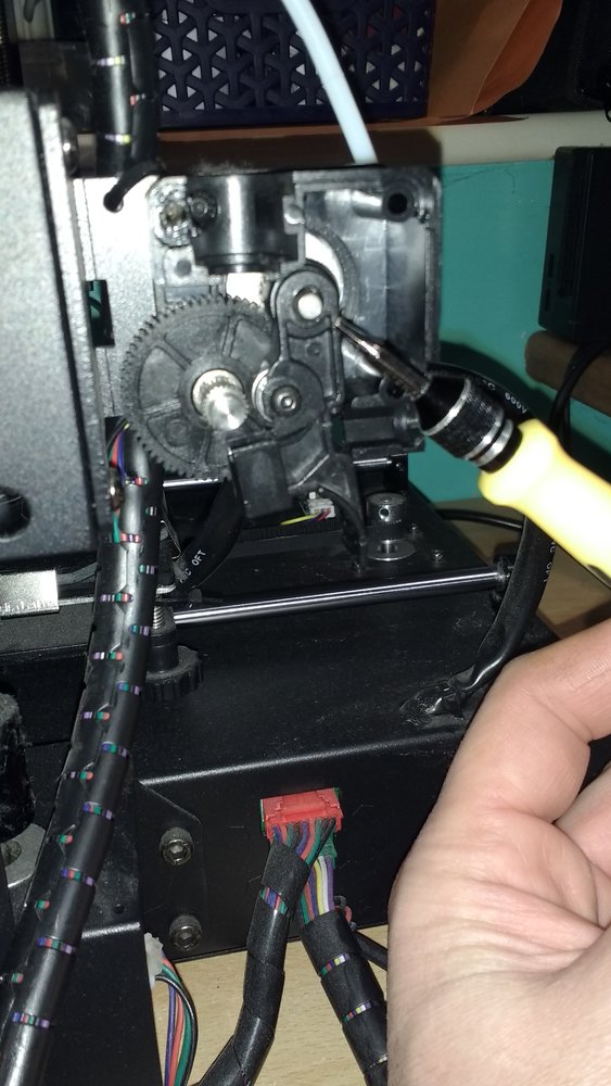

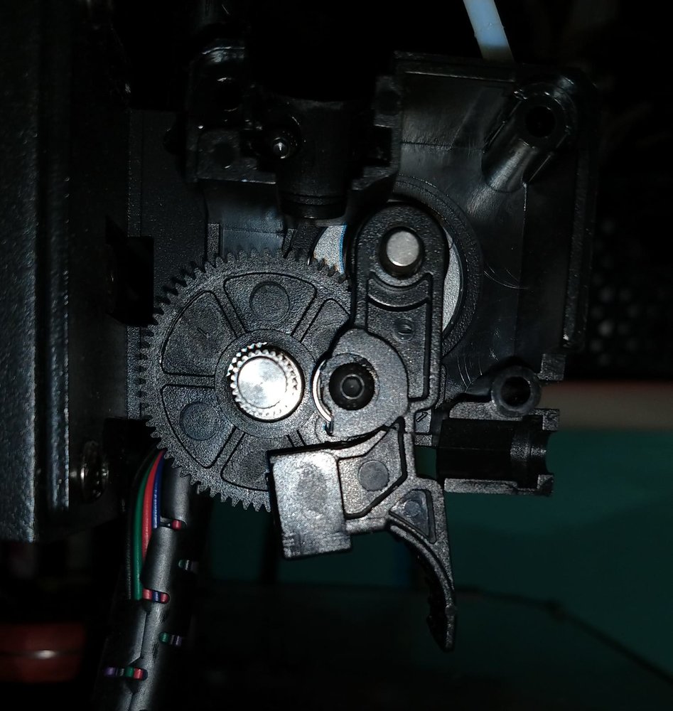

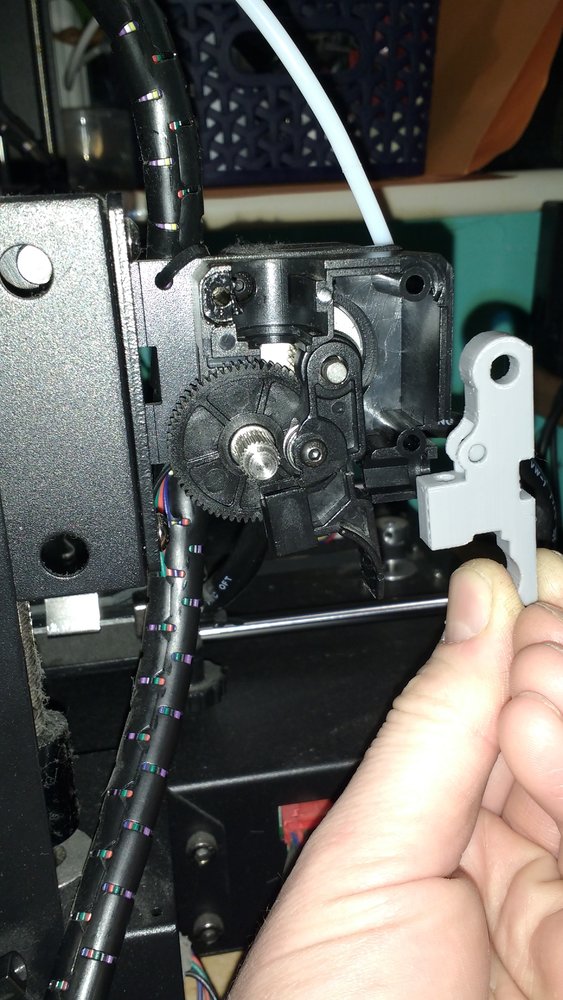

The filament lever in the lad's Anycubic i3 Mega S extruder has cracked.
Printed a new one found on the web but how do you remove the old one?
It's free to pivot but doesn't seem to want to pull off of the shaft being pointed to:
Is it screwed on, about 3/4" down from where you are pointing? Or is that just for a guide wheel?
Of course, you could have just broken the remains away!No it just pushes on over a bearing, it was just on there tight. Pulled it off in the end.
The recess in the back of the print came up a fraction under the 8.5mm bearing diameter. A quick whizz round with a bit of emery wrapped around a drill bit and job done.
All changed and up and running again now.
