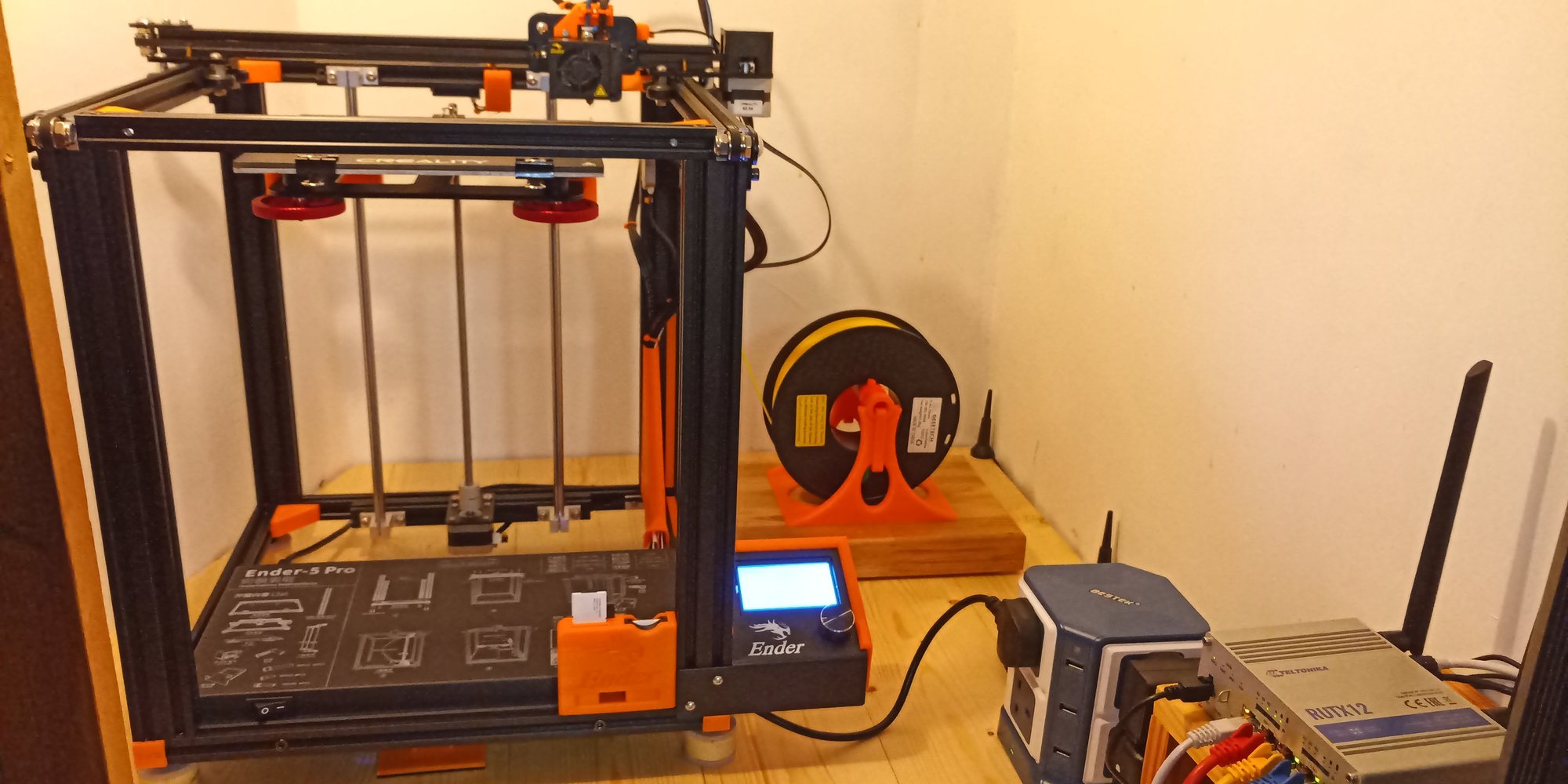

I think that was spot on.Well, that filament which I could not get to adhere to the bed for love nor money last week, I've refitted that spool again today, to try, (I've removed the oem spoolholder, so thought I'd just give this filament another whirl whilst I was changing things around), & it's behaving perfectly. Why, I have no idea.
I've printed a standalone spoolholder to use with the printer:
I've stuck the spoolholder to that wooden block with impact adhesive, to add some weight to it.
Is it a machine for printing parts for the printing machine, so you can print more parts for printing?
