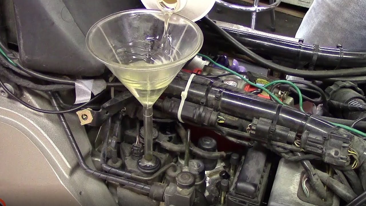

The iABS modulator is not something I am prepared to risk contaminating. They are hellishly expensive and even a rebuild service is expensive, where available. I would still need a funnel to refill it!
The funnel is required because the wheel control circuits have no real reservoir in the modulator. So the funnel gives a reserve of fluid during flushing.

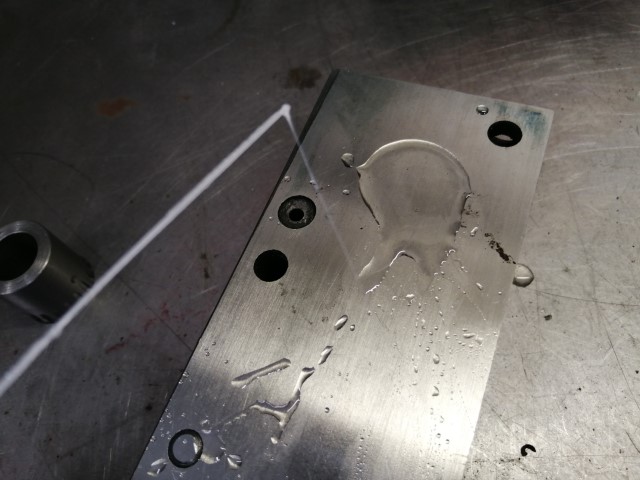

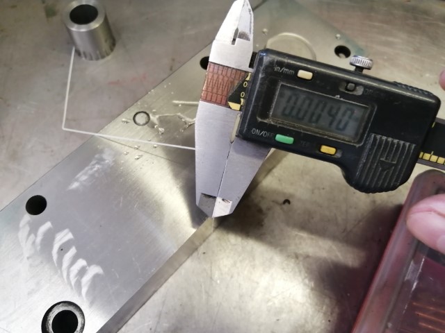

An hour and a half later and no sign of deterioration. The dot4 is still crystal clear, no change in the plastic and it's still 4 thou.
TBH if this doesn't convince you that your fears are unfounded I don't know what will. Especially since the pic above seems to show that someone has used JBweld to make a dam for their make-shift funnel extension. Now THAT would definitely have me worried about liquid JB dripping into the hole while it cured.
It's not just a funnel John, it terminates in a screw thread that seals against the iABS modulator with an O ring. You can see in the photo that someone has "made" something, but we are talking about over a Grand's worth of kit here.
 Could you buy a funnel and turn an 'end fitment' from delrin to be glued onto the end?

Interesting experiment, I am grateful for that. Being new to all this, I could only accept what was written in the item description.
Do you want me to attempt to print one in PLA? Christ, you're more indecisive than a woman at the moment.
Whomever said PLA was unsuitable may have been referring to long term exposure.
