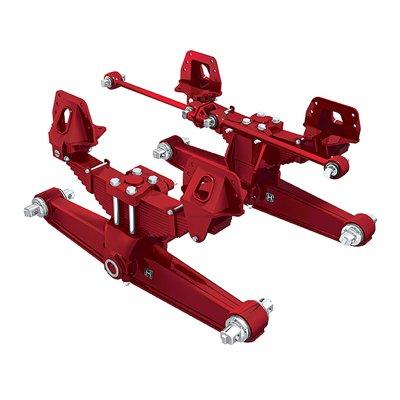

I have a crazy idea for building a 6x6 vehicle floating around in the back of my head which would ultimately result in needing to pass an IVA.
Whilst I'm stuck away from the workshop (as I will be for most of the next two weeks) I like to play around with designs and design constraints for these ideas and see if it's something I'd actually take further.
The IVA manual, whilst fairly terse generally sets out the requirements fairly explicitly, apart from chassis and suspension design which are notable by their absence.
This is unhelpful as the idea I'm playing with involves modifying the chassis and building a completely new suspension system, leaving pretty much all the other relevant systems untouched.
There also doesn't appear (based on an initial search) to be any definitive standards for the design calculations to determine the strength of chassis and suspension components.
This also makes it very difficult to determine the design weights of the vehicle, which logically would be determined by reference to calculating the imposed load that would exceed the yield strength of the components, divided by some recognised safety factor.
Is there recognised best practice for this, or is it a case of designing it along "sound engineering principles" and seeing if the examiners agree with your decisions/justifications?
