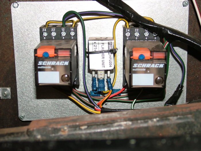

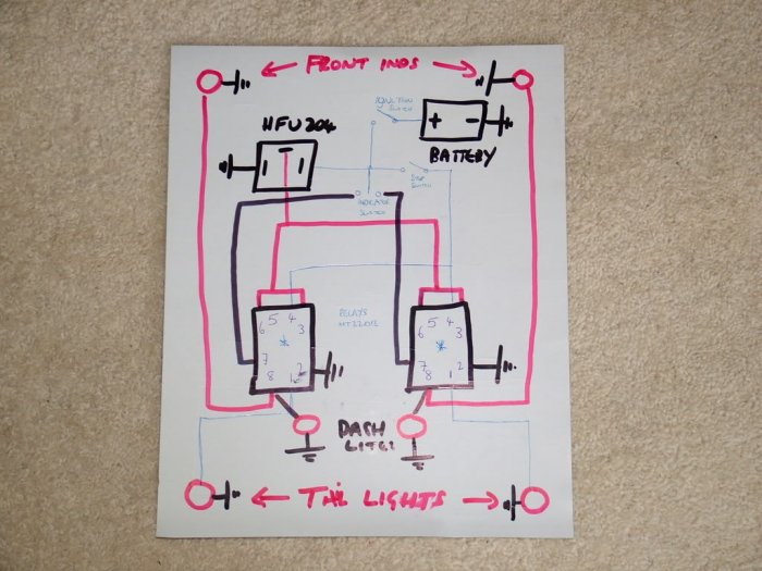

The turn switch energises the left hand relay when you are turning left and vice versa. It only energises one relay at a time - never both. When the relays are turned off the front indicator lights are disconnected and the back stop/indicator lights are connected to the brake light switch. When a relay is turned on it connects the front and back lights on that side together and supplies them with power via the flasher unit.
Note that the sidelights and tail lights are on a separate circuit - the ones that are a single lamp use two filaments in one bulb.
Apologies if I've made any silly mistakes in this post - it's getting late and I haven't built and tested the circuit.
