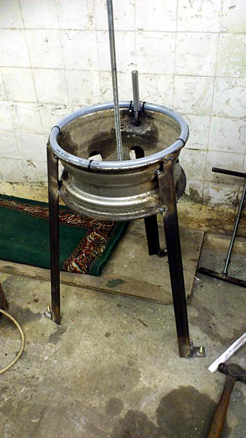

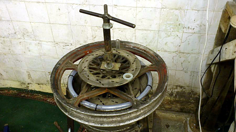

I wasn't rushing, and seeing as I'm not in a competition, who cares?10 minutes ! Back in the day to qualify for a place in the British ISDT team one of the tests was to be able to stop / remove and replace rear tyre and ride off in under 4 minutes. This was done during an off road special test often in the rain mud etc using only tyre levers and a pressure bottle to refill tyre.
Hmm, now you mention it...where's the electric motor & gearbox ?
You mentioned the time .I wasn't rushing, and seeing as I'm not in a competition, who cares?
Only because I was surprised at how quick it was. Previous wrestlings with the device have taken longer.You mentioned the time .
Is it going to look something like this ?

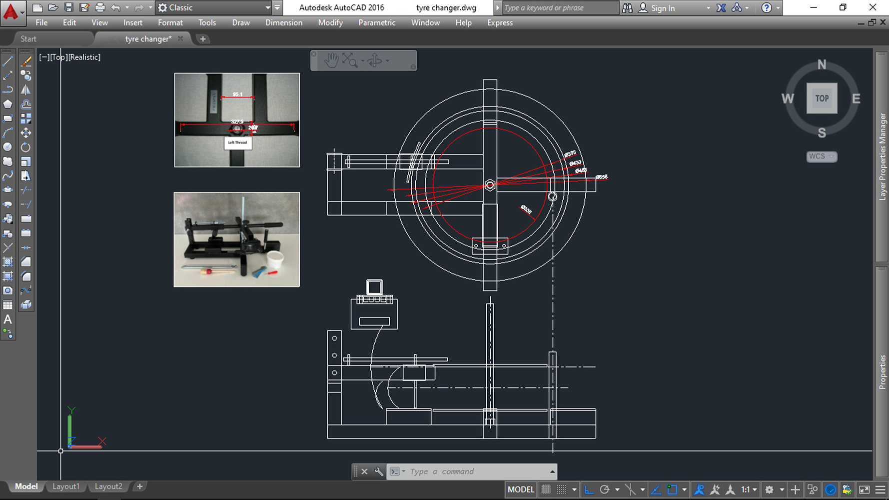

I see, looks like the one I linked, only a benchtop version. Same concept.No, like this (I hope):
Reifenmontiergerät 2020 (Tire changer 2020)
olmaxmotors , olmax motors , reifenmontiergerät , motorrad , reifenmontage , tire changer , tyre changer , motorcycle , motorcycles , wheel balancer , auswuchtgerät , auswuchtbock , lukas werner , Łukasz werner , manual , portable , ręczna , mobilna , montażownica ogumienia motocyklowego ...www.olmaxmotors.pl
Ah, a proper oneI see, looks like the one I linked, only a benchtop version. Same concept.

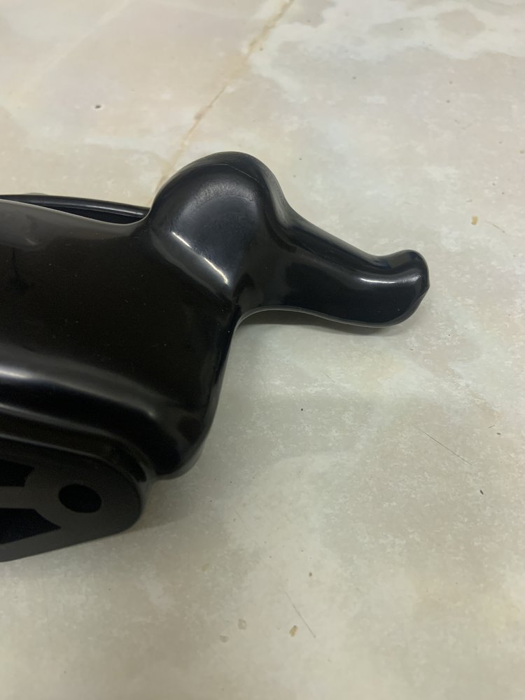

I'm thinking that maybe the Coats version is so tall above the rim surface, the duckbill being on a long vertical rod,
to make room for your hands to work the tire easier.
Nice one... and yes I know about the centring collar. I'll turn one up from a random bit of scroungium.
