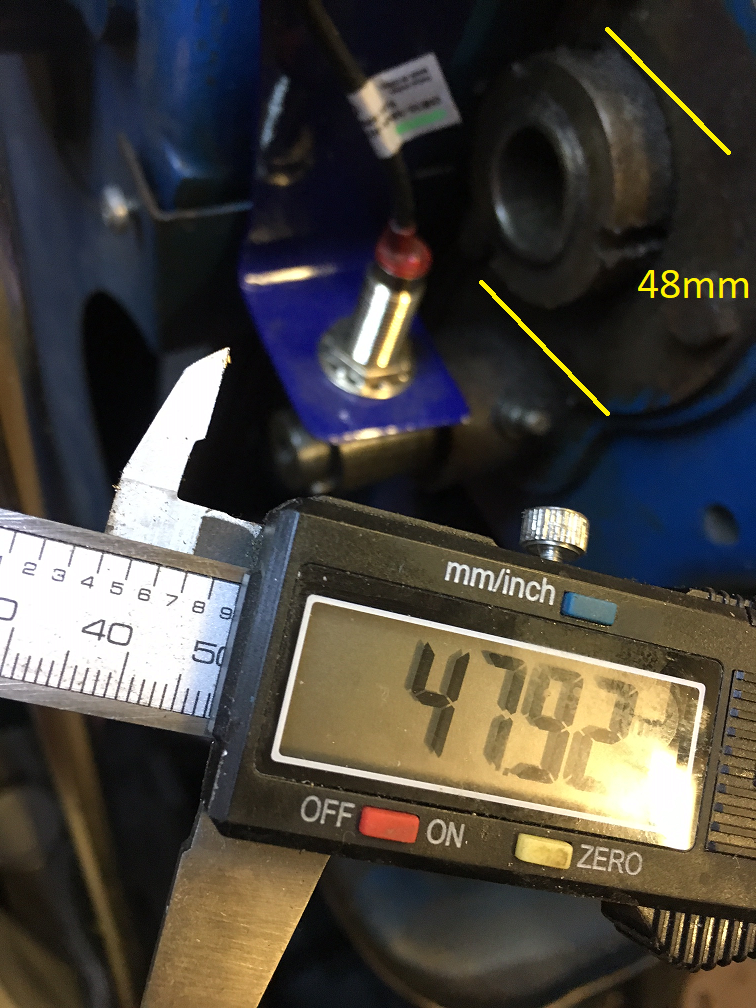

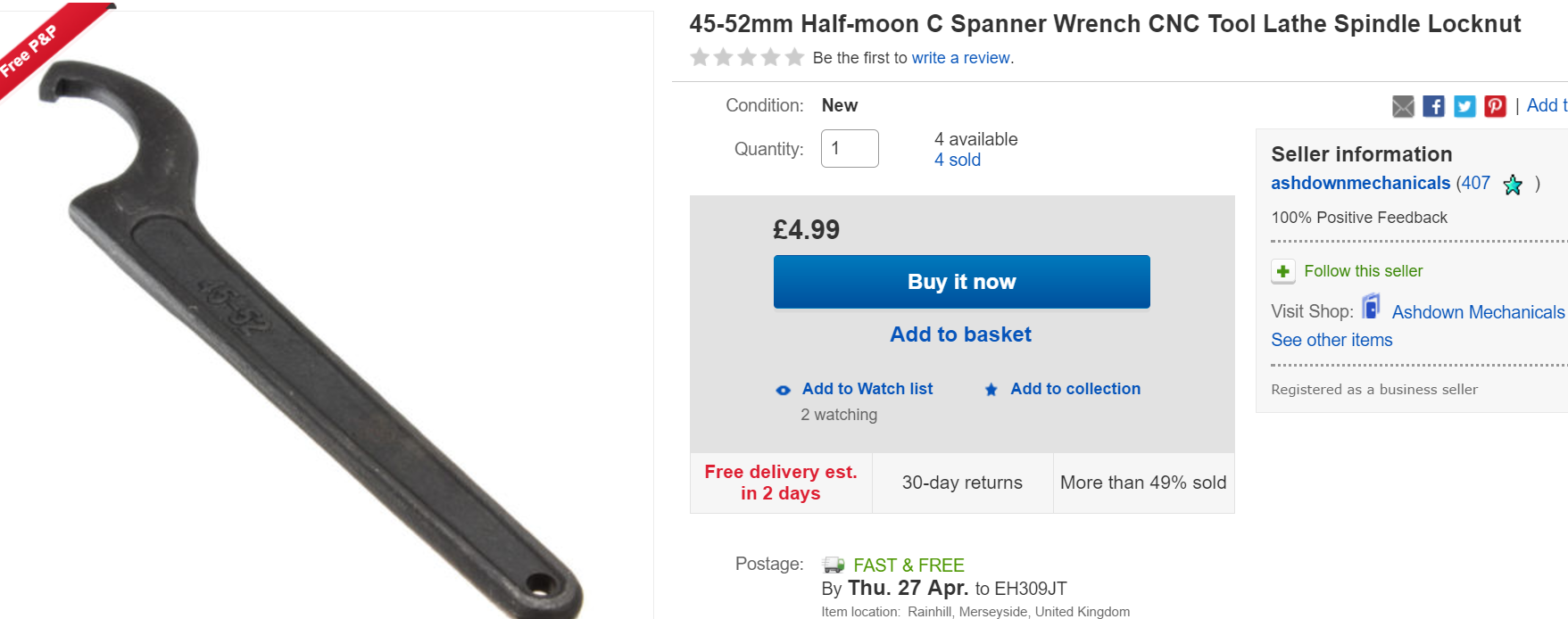

There's two locking rings on the bottom right. Rightly or wrongly I have used a C spanner in the past on these to stop the shaft from turning to remove the chuck. Apologies in advance if I am giving shoddy advice.
They too seem like preload nuts so best not to disturb.
