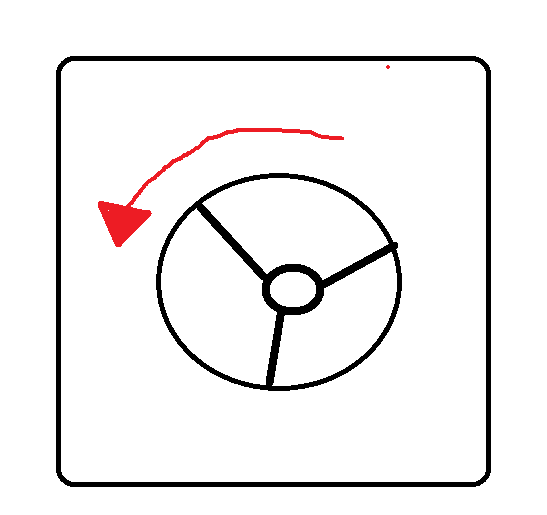

Avoid using gears if it is stuck, they are easily damaged. Make a drawbar like at the end of this www.youtube.com/watch?v=7dC13inQC9A
@doubleboost uses an adjustable spanner on the jaws rather than the chuck key.Ooohhh... conflicting advice
I see youtubers grabbing the spindle to loosen the chuck - so that's not the way to go?
I've just come in from the garage after an unsuccessful attempt to get the chuck off by whacking it![]()
No spindle locks on that model as ive owned one...chuck removal involved putting in back gear and putting a piece of wooden batton across the face of the chuck held with the jaws and have about 16" sticking out and then a firm hard bang with a large rubber mallet hitting down towards the bed and the chuck will spin off really easy...

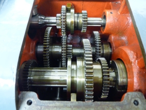

yea get a piece of batton and re-read post 31Got it off, finally, with the help of my neighbour. Hour and a half we were at it - the only place we could get leverage was the spindle inside the gearbox.
Variety of different tools and finally it loosened.
The threads seem clean and had a light coating of oil so not sure what caused it to stick so much - any hints on how to prevent it in the future?
