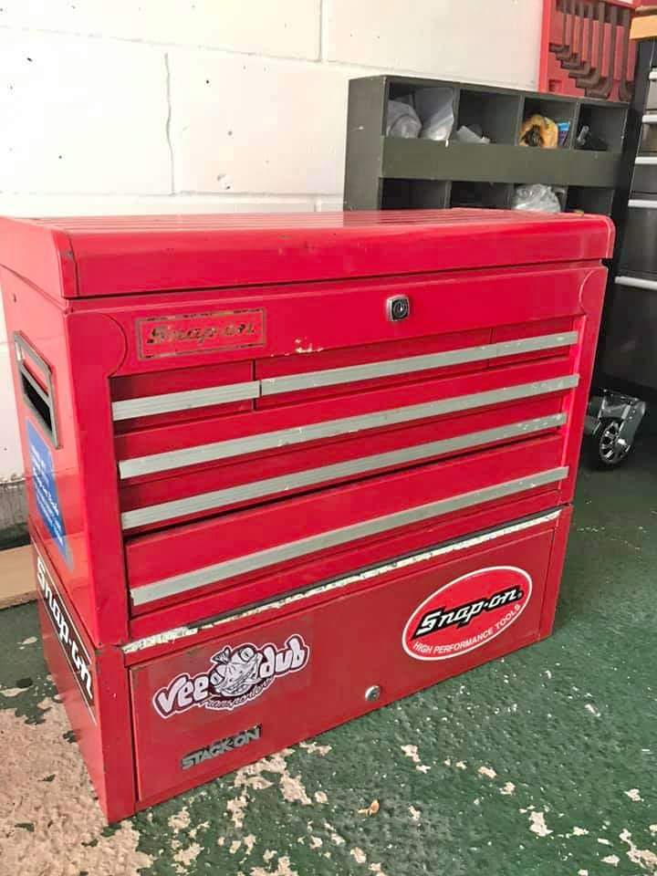

    Someone's got a box up for sale locally.
    I don't know snapon well, but I've seen plenty of snapon stickers stuck on anything!
    Is this one genuine?

    Hmm... Now I've posted the photo, I'm wondering why anyone would have a stackon sticker on a snapon box.
    I think I've answered my own question!
    Thank you.

    The box with the stack-on badge is a intermediate box by the look of it and separate to the top box, also looks a different colour.
    Not sure if the top box is snap on but the carry handles are the same as on a beech toolbox I have, but mine has a drop down front.

    Stack-On was sold in Halfords I think before the Professional range came out.

    Looks like a rip off.
    Not sure I've ever seen snapon boxes with plastic handles....

    Doesn’t look like a SO to me.
    They are very good boxes, worth the money if you do more than hobby level work.

    The silver bits for the handles are on the top of the drawers on a genuine snapon box.
    Lock is wrong as well, should be a round barrel with anti grab ring around the outside.
    If they have the key/s they will have snap-on in the metal of them as well

    draw edges and side handles suggest its a cheapie to me
    thing is you dont loose alot of money on a clean used snap on box as it will always re sell

    Something made me look closer at the top box, I think it was the two folded ears on the front face and the ribs on the lid. It looks very much like one I bought in 1989, the drawers had roller bearings and it was quite well made with a good shiny finish. Snap-On boxes at that time I don’t remember being so shiny, the finish was more in keeping with the lower Stack-On cheapie, a satin finish. Unfortunately I don’t have it to compare as I gave it to my nephew when I bought the Halfords Professional set.

    never used a square lock that im aware of either..agree on the folded ears too , none of the ones ive had used exposed joins like that

    Also the snap-on ones have the snap-on logo and the part number stamped into the side panels lower rear corner on at least one side so you could ask for a photo of that if they are claiming it's a genuine one.

    snap on sticker should be alloy panel with plastic insert used to be on the top right hand side on the older top box's

    Bottom is Stack on very cheap and flimsey for professional use, top one isnt Snap on, Cant remember who made them but I recognise the handles and front ears? Talco?
    All Snap on boxes have a serial number and country of manufacture on the rear
    It all depends on price and what you need, if its cheap just buy it.
    Snap on have always made good boxes but some are better than others, but they are all good quality.
