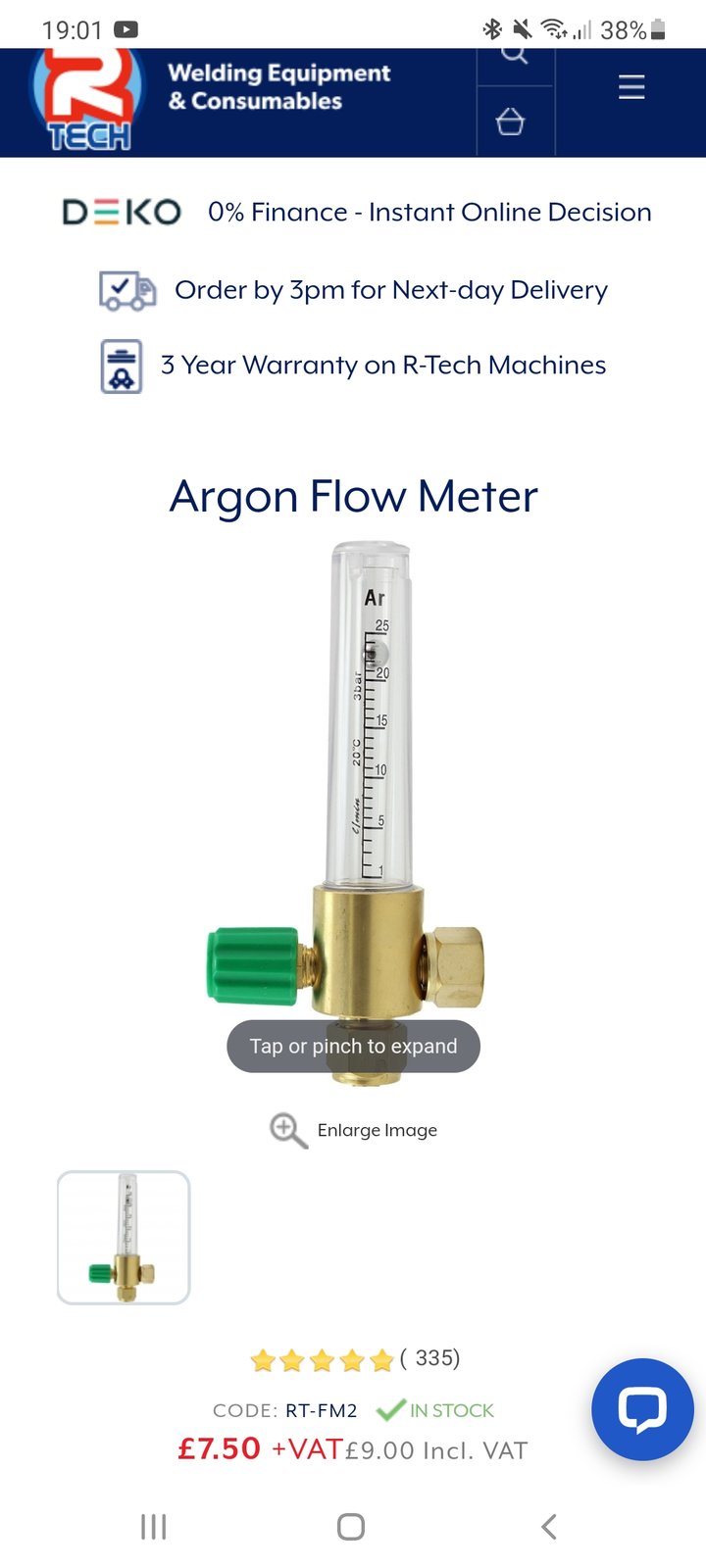

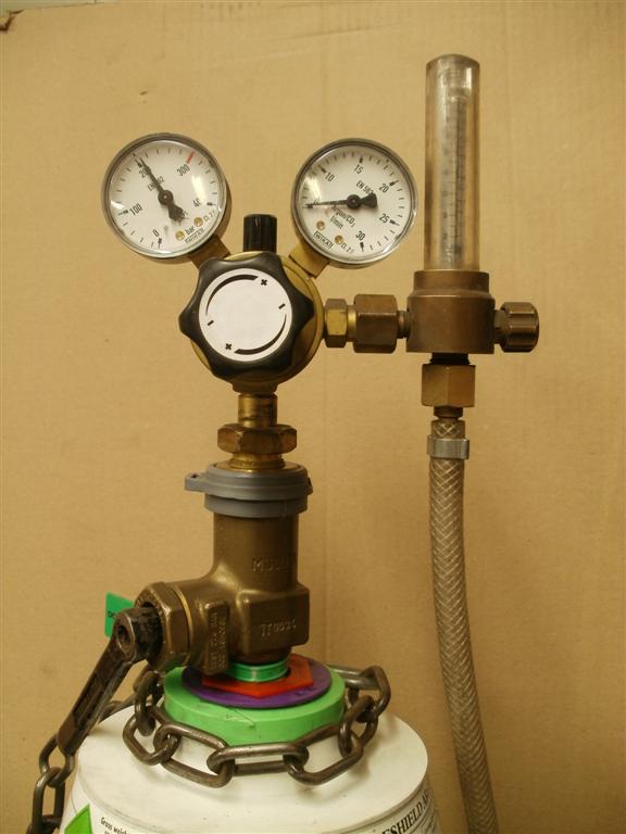

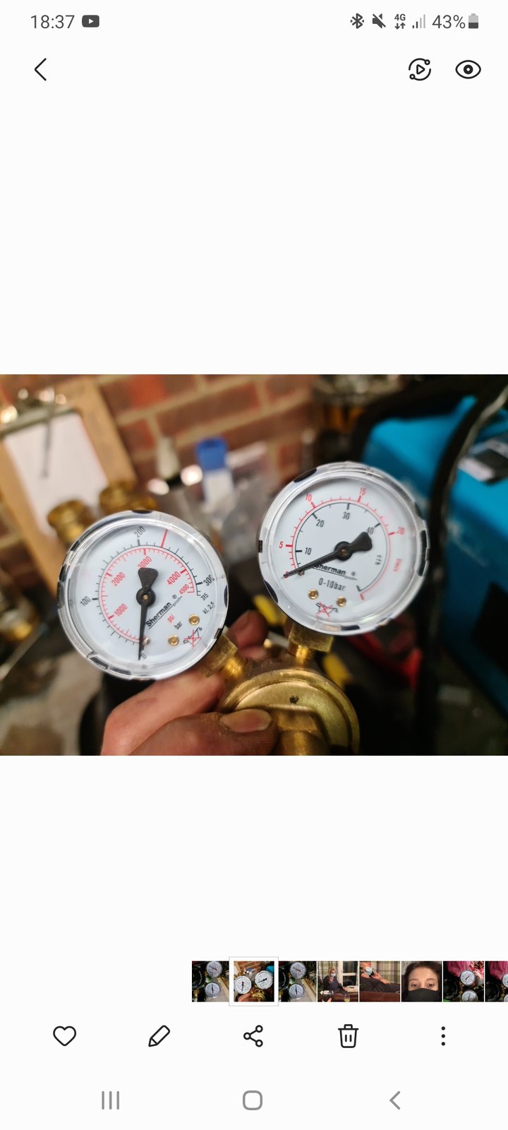

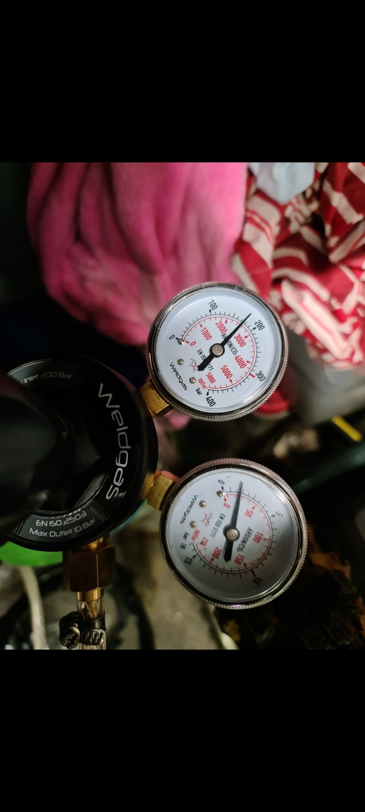

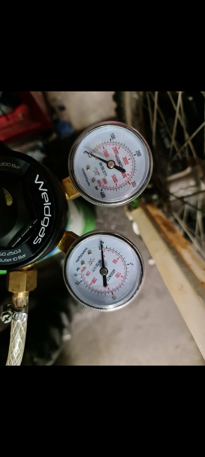

I’d just start off with it set very low and up the pressure a little bit at a time until I got decent welds and order a pea shooter or a proper flow meter when you can. It probably doesn’t work any differently to the other reg as they both show a max 10 bar outlet. Depends on how restrictive the outlets are.
