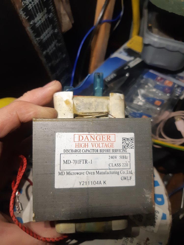

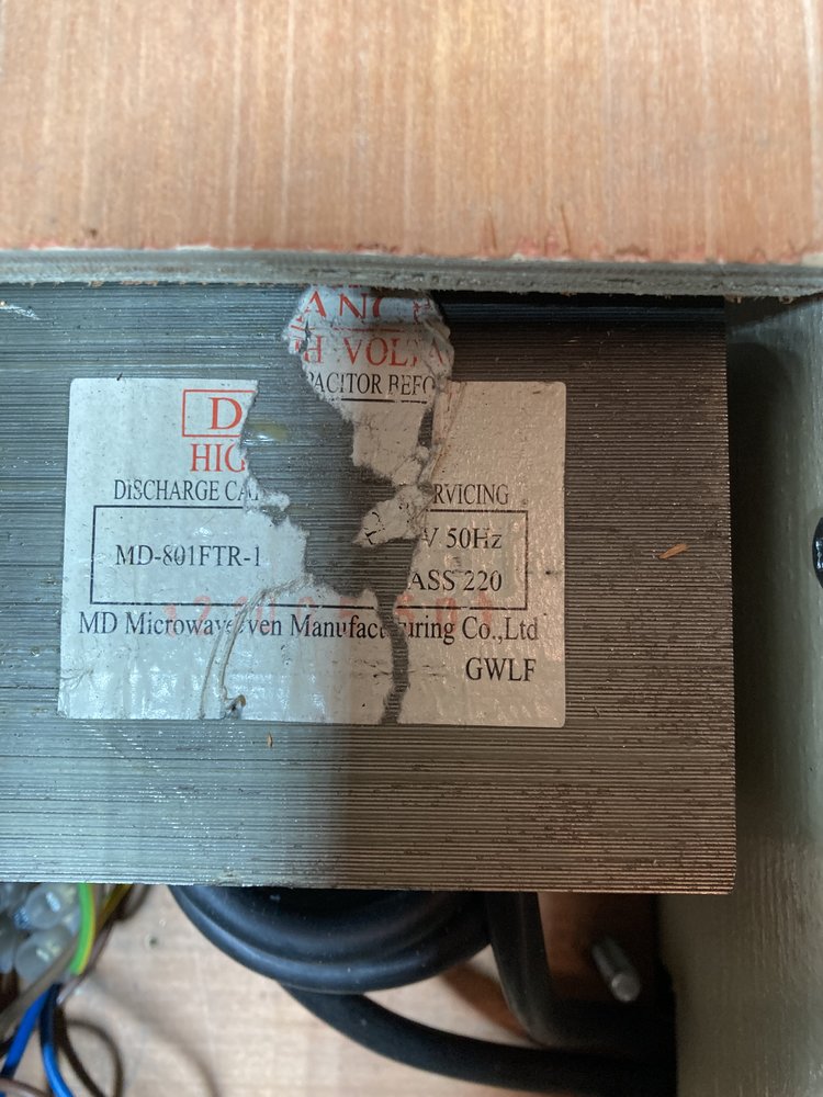

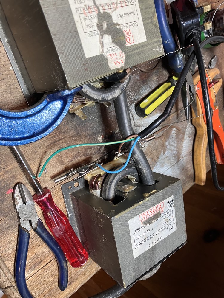

Ah yes, i wasnt sure if it was series or parallel, clearly need a refresher from my o levelsTo increase the current, you would need to put the secondaries of the second & third transformers in parallel with the first one.
If you put them in series, the voltage will increase. Not sure what would have the best effect for your application. I think commercial sheet-metal spot welders start at about 2 volts and 2,000 Amps....
You can also increase the voltage by stuffing more turns of cable into the space in the core.
( The primaries, of course, will all be in parallel across the switched mains input.)

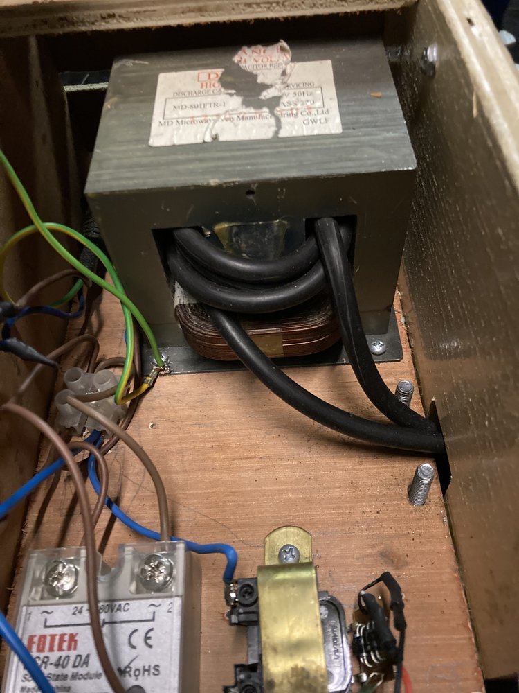

You could probably get it to work better by beefing up the cable.Indeed secondary is from a jump cable

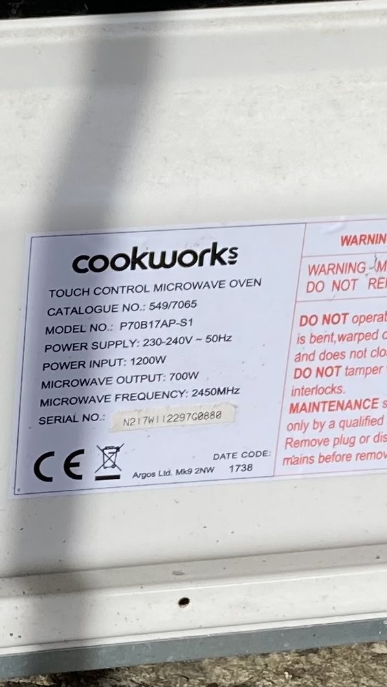

	They have one but it's only tiny. The magnetron is the same though.I think they all would need a transformer of some description to step up the voltages?
A quick google suggests that inverter microwaves are able to regulate their power rather than being simply off or on, so I think the transformer would still be required (But thats only a guess!)
If you are paralleling the secondaries, the transformers need to be identical

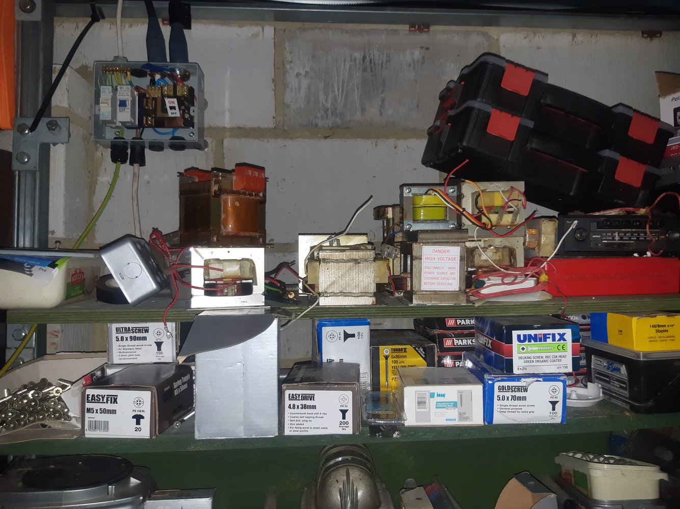

Much appreciated , very kind of you , grateful for all the input here too@Sapre as per my pm you can have this trannie. If we can meet up in town even easier. On the cable front, years ago I was given I think some 50mm cable for my own (as yet unstarted, spot welder project). If I can find it you can have some too. I got it for nothing so I'm just paying it forward, Karma and all that.

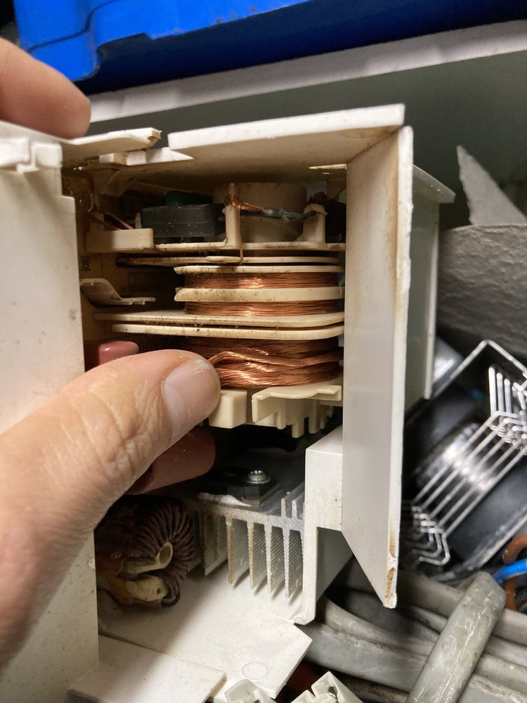

Ah good tip, thanks!The cover is usually a clamshell "U" shaped.
These make a good wrap around shield for a bench drill press to keep stringers flying so far.
so there is a bit more salvage value for you.

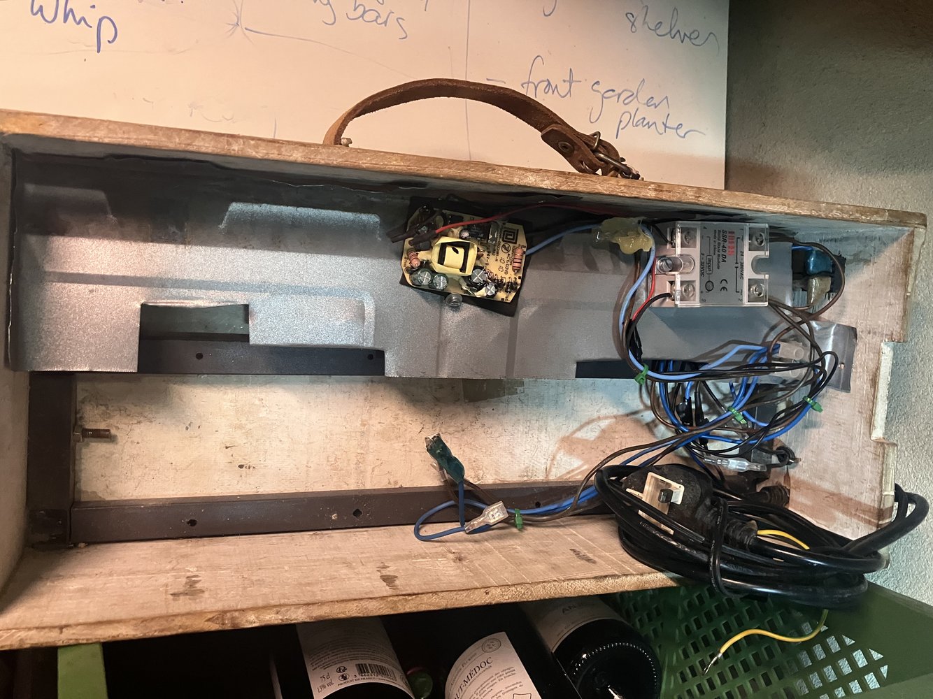

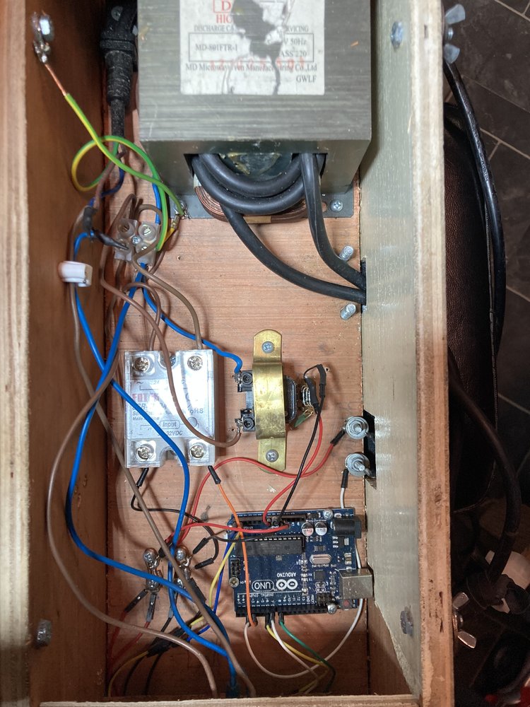

welding up the frame for the spot welder itself went fine
No, inside the wooden housing case i made a frame from steel box tubes to hold the transformers , all spot welded together!Do you mean you slit/hacksawed the transformer frame to access the windings, then rewelded it together?
