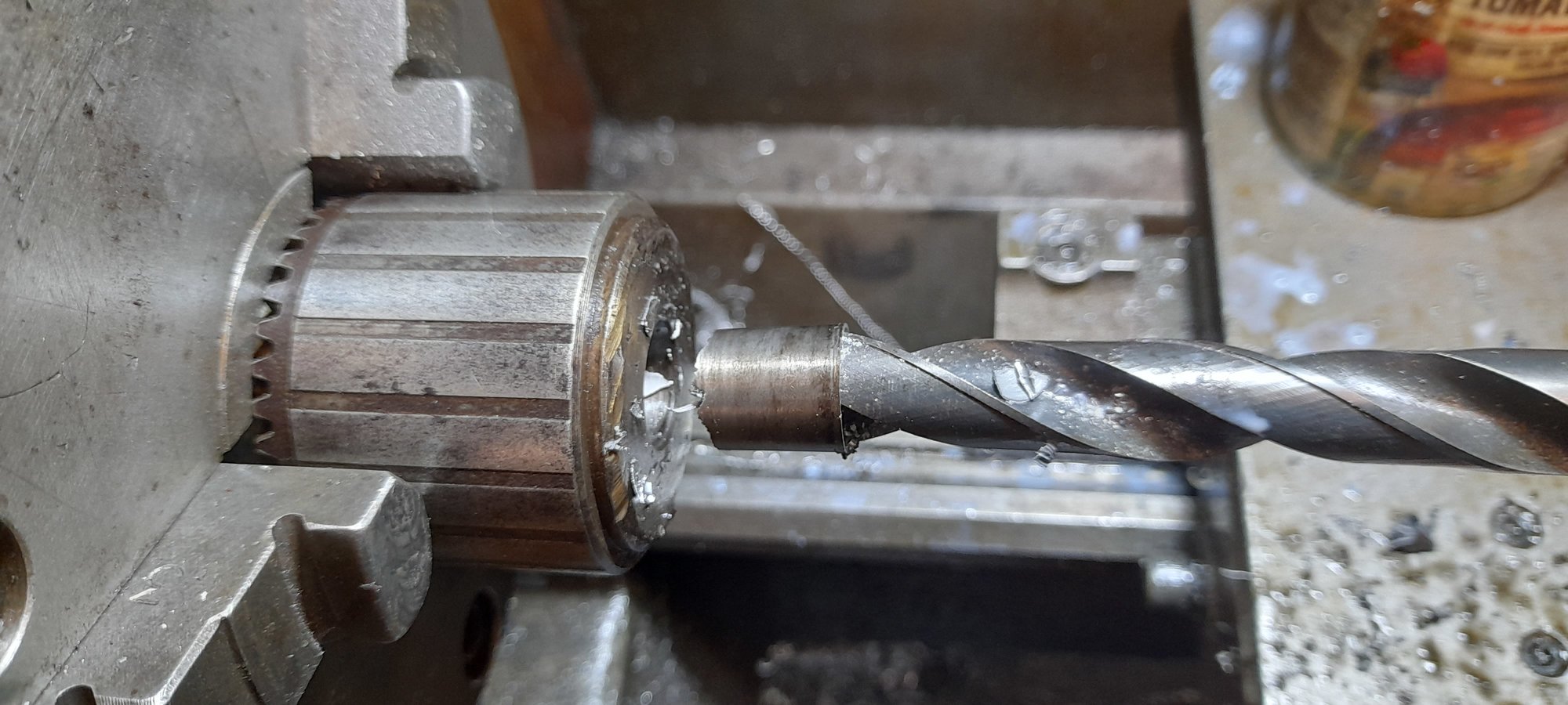

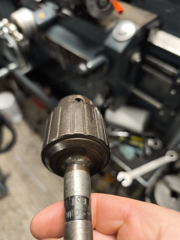

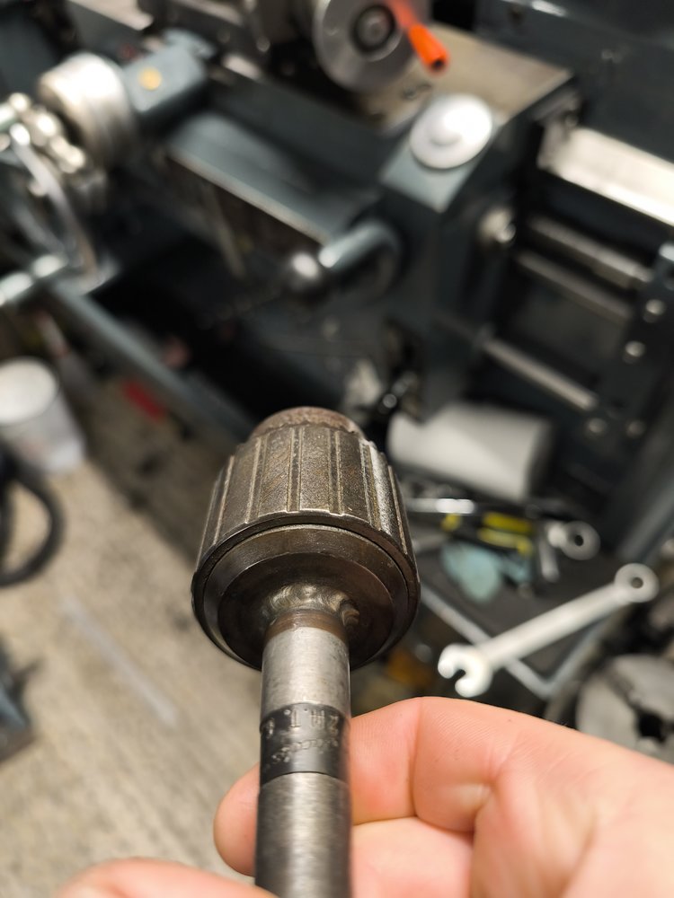

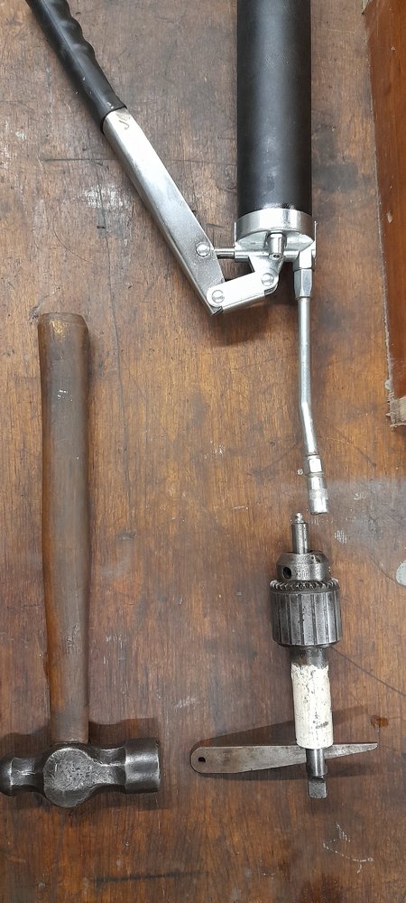

That's another good suggestion, thanks.As you had to weld arbor to adapter, make a thick wall tube spacer from back of chuck to adapter removal cut out, then you have grease pressure and then beat a wedge in against spacer .removal slot
It had heat when welded. I guess some more heat could be tried. Anyway, I'm onto plan C in a moment...Cut it off and either drill it out or weld a tab onto the end to get wedges or similar under. A bit of heat into the chuck may help too
I've started, so I'll finish!plan e get another one![]()
It's out. Hooray!!!!I had one of those with a bent arbour. I tried all of what you did to remove it bar the grease gun but all failed.
I ended up cutting off the arbour close to the chuck and drilled the remains of the tang from the chuck using a lathe.
Even then it took a large hammer and punch from the chuck side to drive the remains of the tang out.
I'm guessing you are trying to save the arbour but new ones are cheap, a lot cheaper than a new chuck if you ruin that one from too much heat!

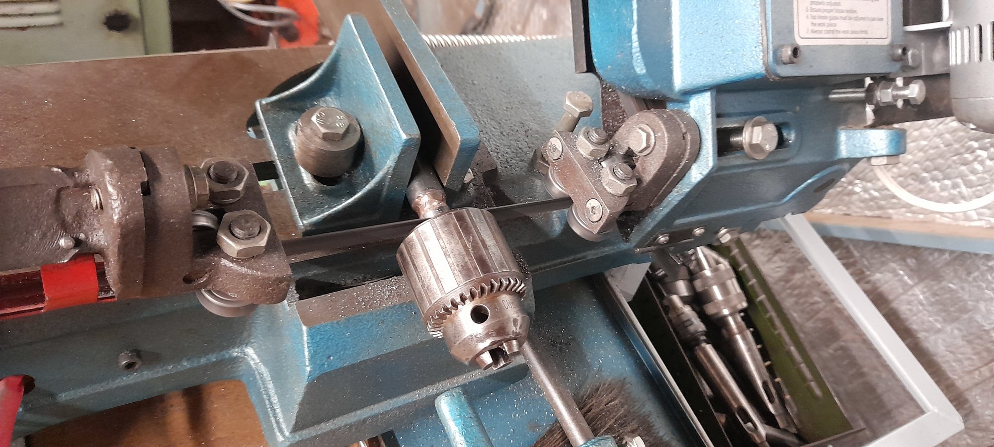

Still got the Q&S 6H, but I find the bandsaw good for small jobs like this.What happened to your donkey saw?
I am pretty sure you had a Qualters and Smith saw.
Have you replaced it with a little bandsaw?
Or am I going senile?![]()

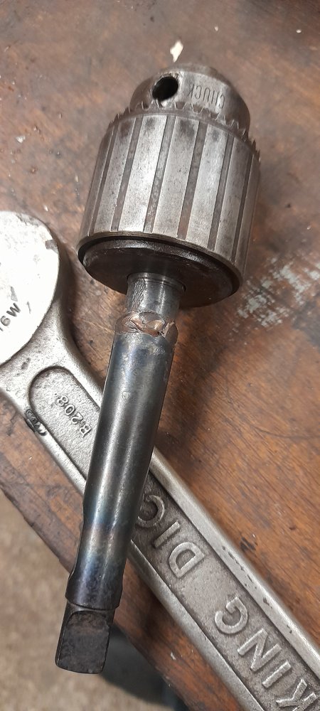

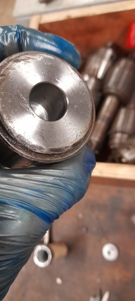

That's "nice"Found the chuck I was thinking of.
Somebody really did a number on this one.
