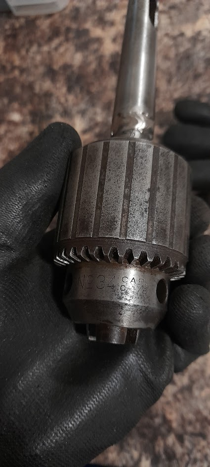

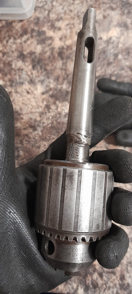

I've stripped, cleaned and reassembled a couple of chucks this evening.
Great info, thank you!One tip with reassembly: use the chuck key as a gauge to determine how far on to press the sleeve. If the mesh of the key is too tight, it needs a little more; if the mesh of the key is too loose it needs a little less.
This is also the way you solve the problem with a chuck where the key slips (providing the key itself is in good condition).

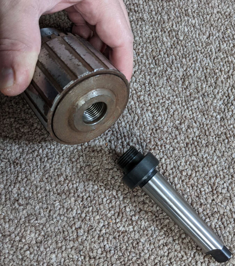

With the welded on arbor, it would be possible to skim 0.5mm-1mm off the back of the chuck, which would break the bond of the weld and then the arbor can be removed as if it had never been welded.
