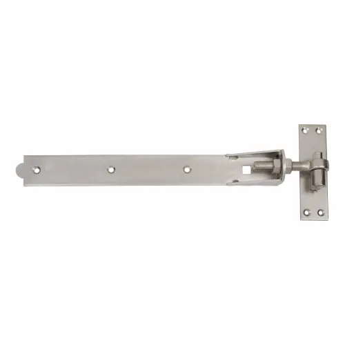

I've had a couple of these millstone grit post installed on the driveway recently to replace the wooden posts. I'm in the process of getting the oak together to make the gate as I want something a bit different and I like working in oak.
With oak, its usual to use SS hinges as the tannins react with other metals causing discolouration of oak and ironwork. You can get SS hinges off the shelf, about £150 a pair but they are designed for wooden posts.
The plate is much too small, I would be using SS threaded rod, resin and SS dome nuts, the plate needs to be a lot wider. I may also design it slightly different and incorporate some antitheft, we usually put the top hinge upside down to stop people just lifting gates off and nicking them but a nice new oak gate may need a bit more of a deterrent. It will take me a while to build the gates, so I'm in no immediate rush, so can practise on a few bits of scrap first. There is a guy nearby who I can probably get around to show me the basics, were in the same working men's club and he has a small fab shop at the bottom of our hill.
