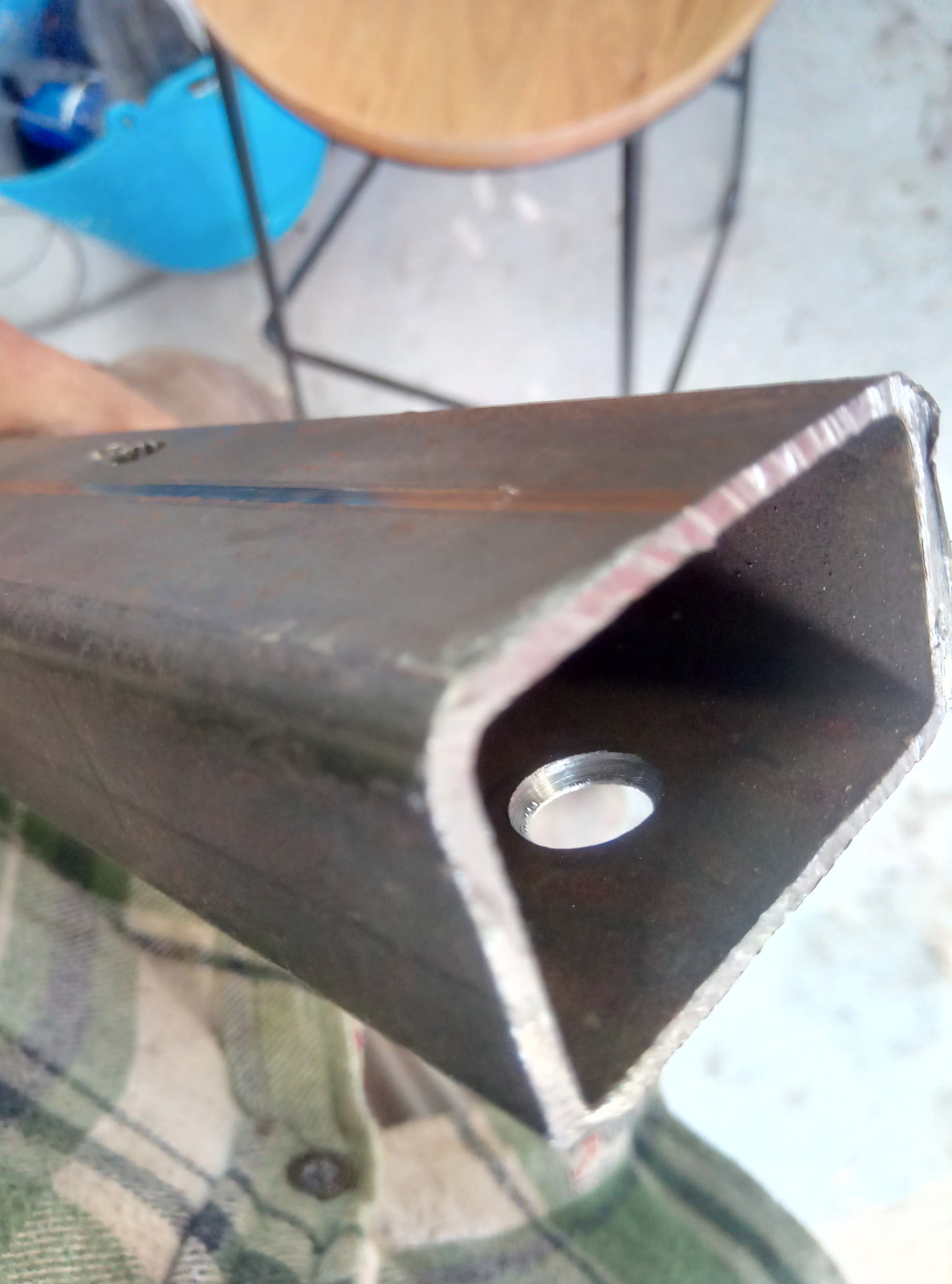

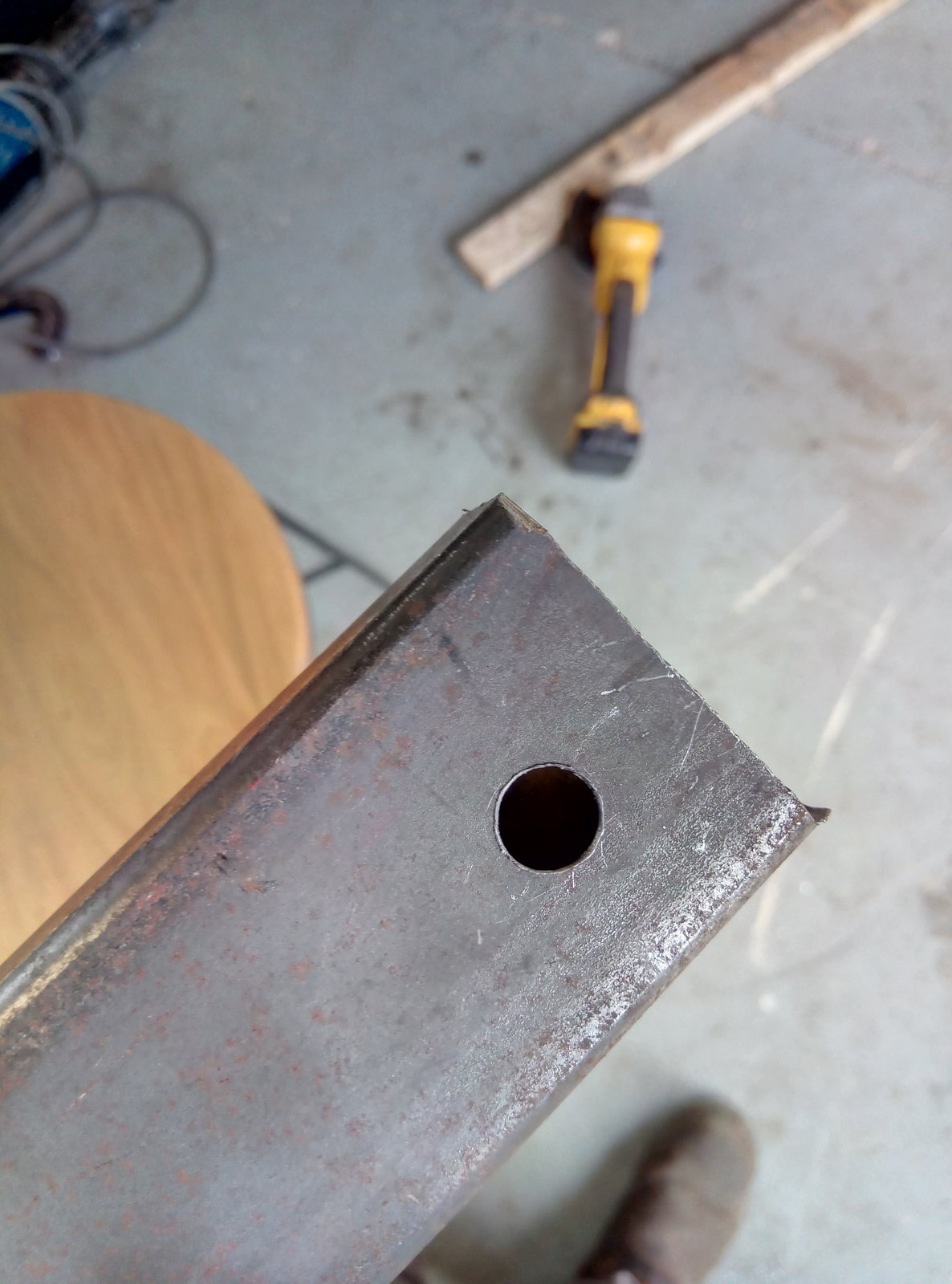

M10What diameter bolts are you looking to use ?
I'll have to check it tomorrow I can't remember. Not 6mm though.How thick is the wall section? M10 C/S would need about 6mm or so to sit flush.

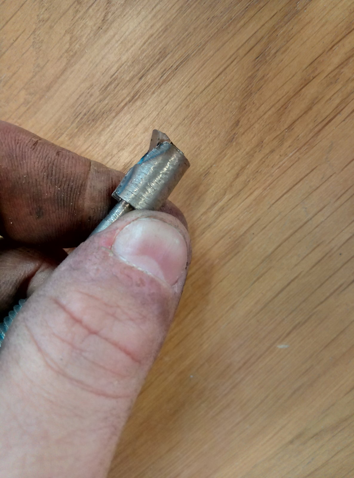

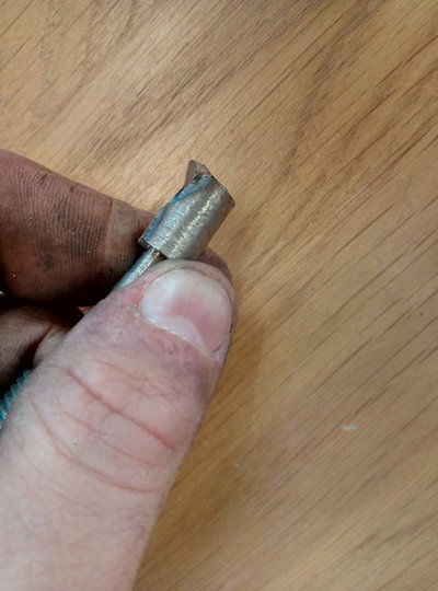

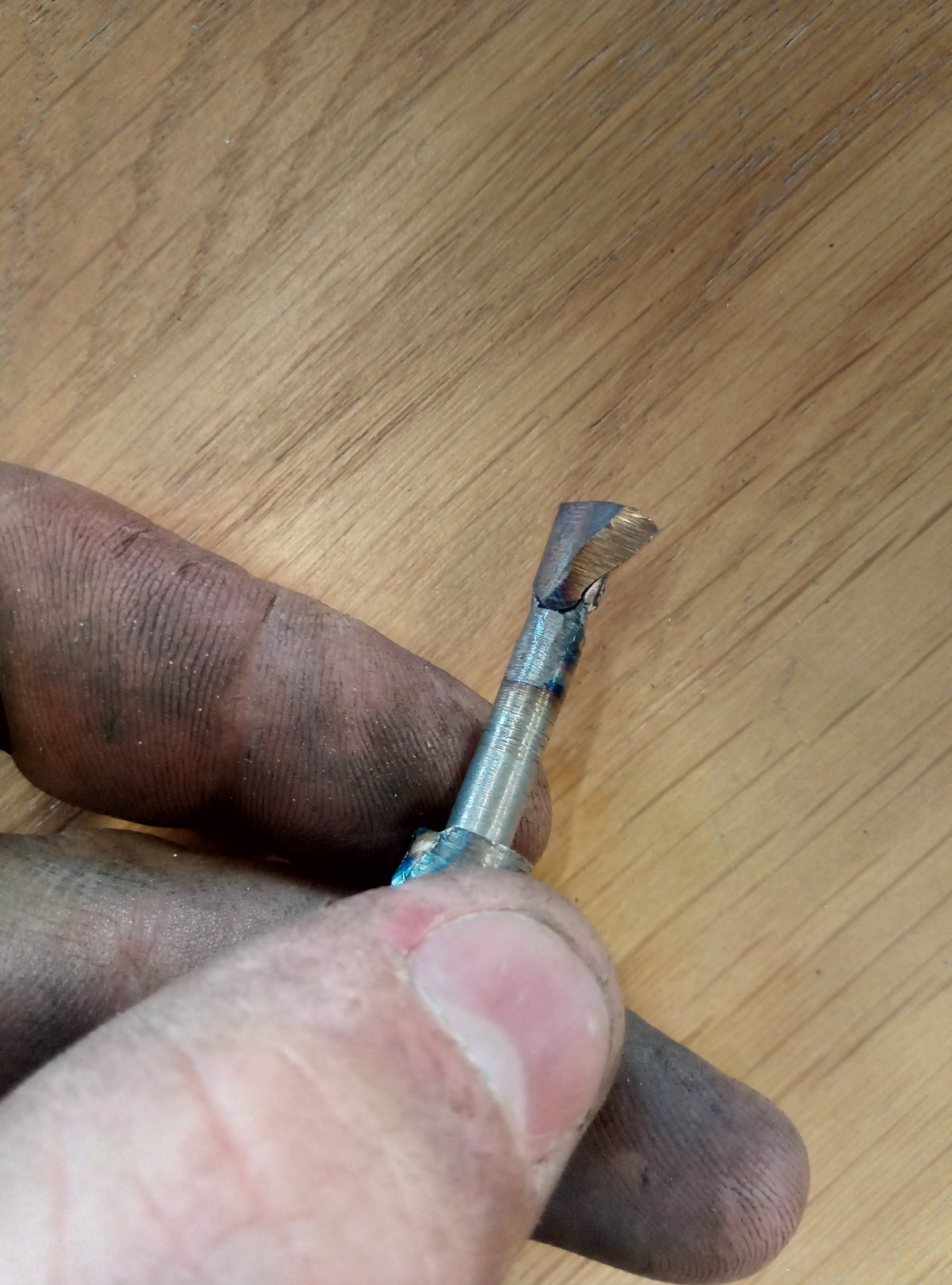

That's not a bad idea. I have some bits of HSS I could braze or weld onto something. I'll investigate. Thanks.Something like this any help
View attachment 230071 View attachment 230072
Very rough but i didnt want to waste time on an idea
Hss tig welded on use 316 stainless, ive done this a number of times.
Silde the bush up, insert tool, slide bush down and go at it lots if speed very gentle up.
View attachment 230074 View attachment 230073
Put the effort in you will easily have a nice tool

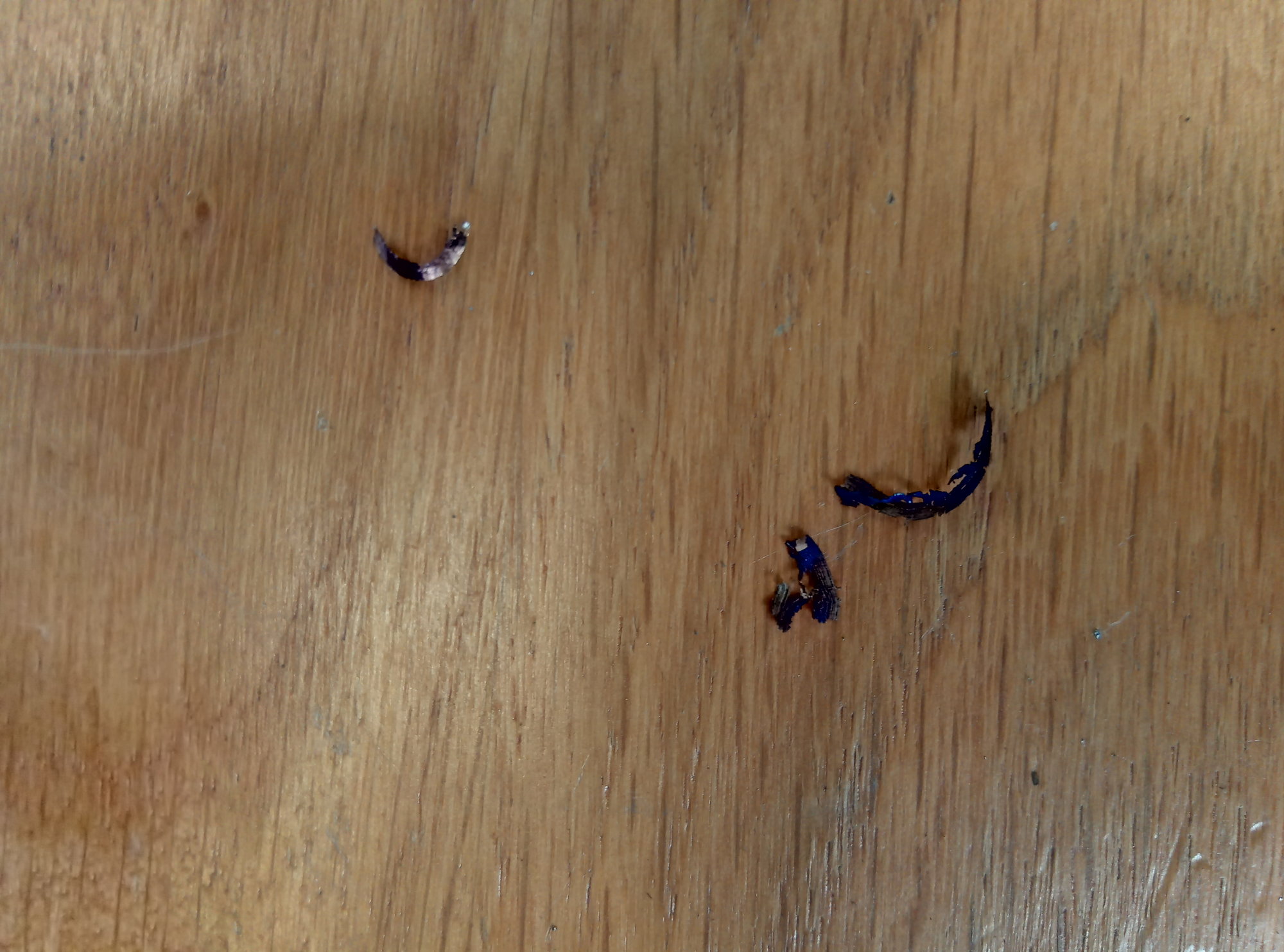

The swarf. Cuts easily with a hand drill

Thanks. I think I can have a go at it.That was a 10mm hole i iashed this up using an angle grinder.

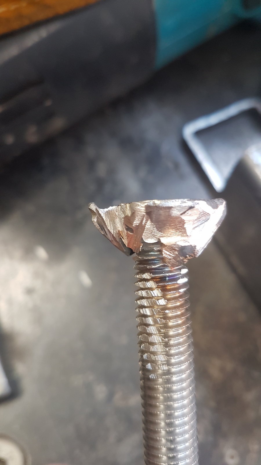

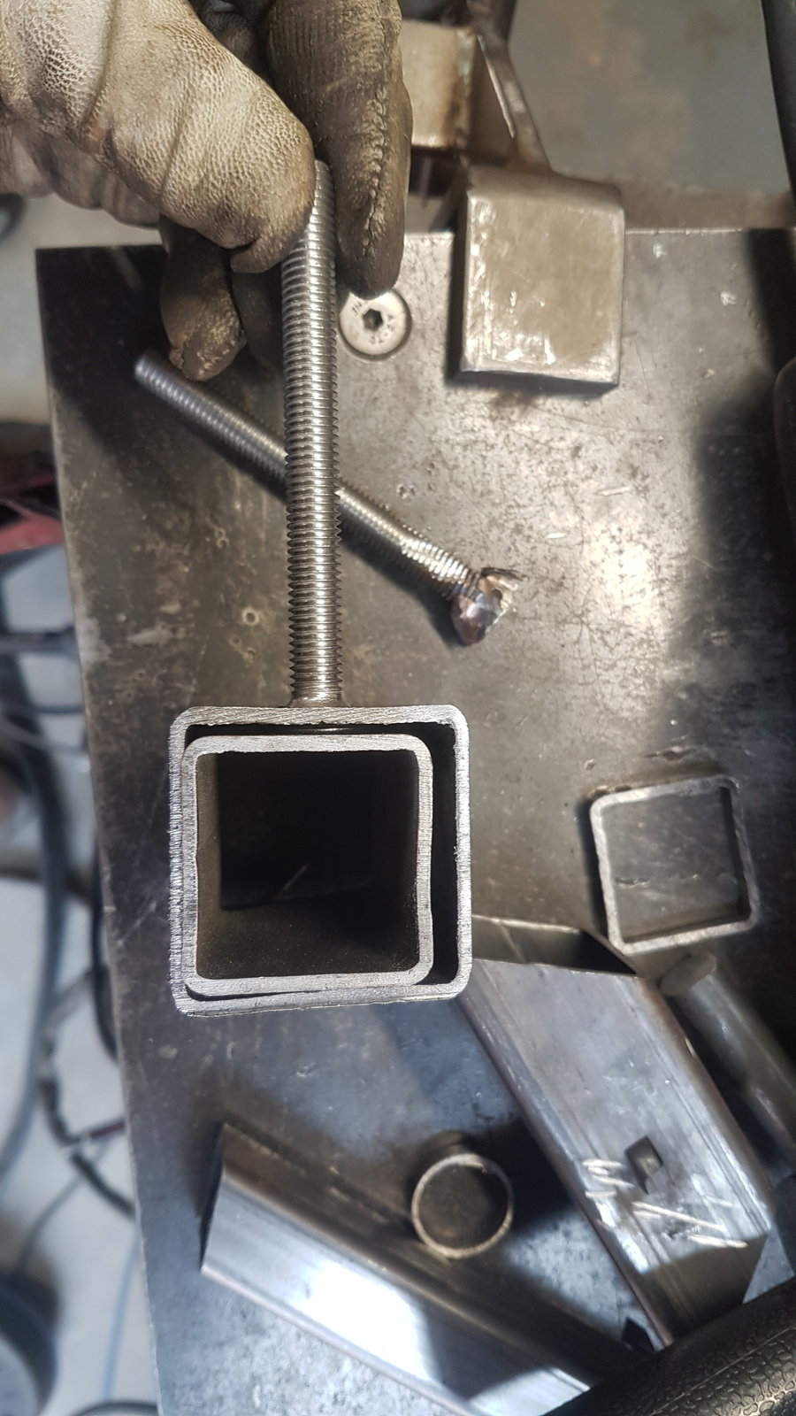

I think we have a winner. Spare bolt repurposed into a (very rough) 2 flute cutter.Something like this any help

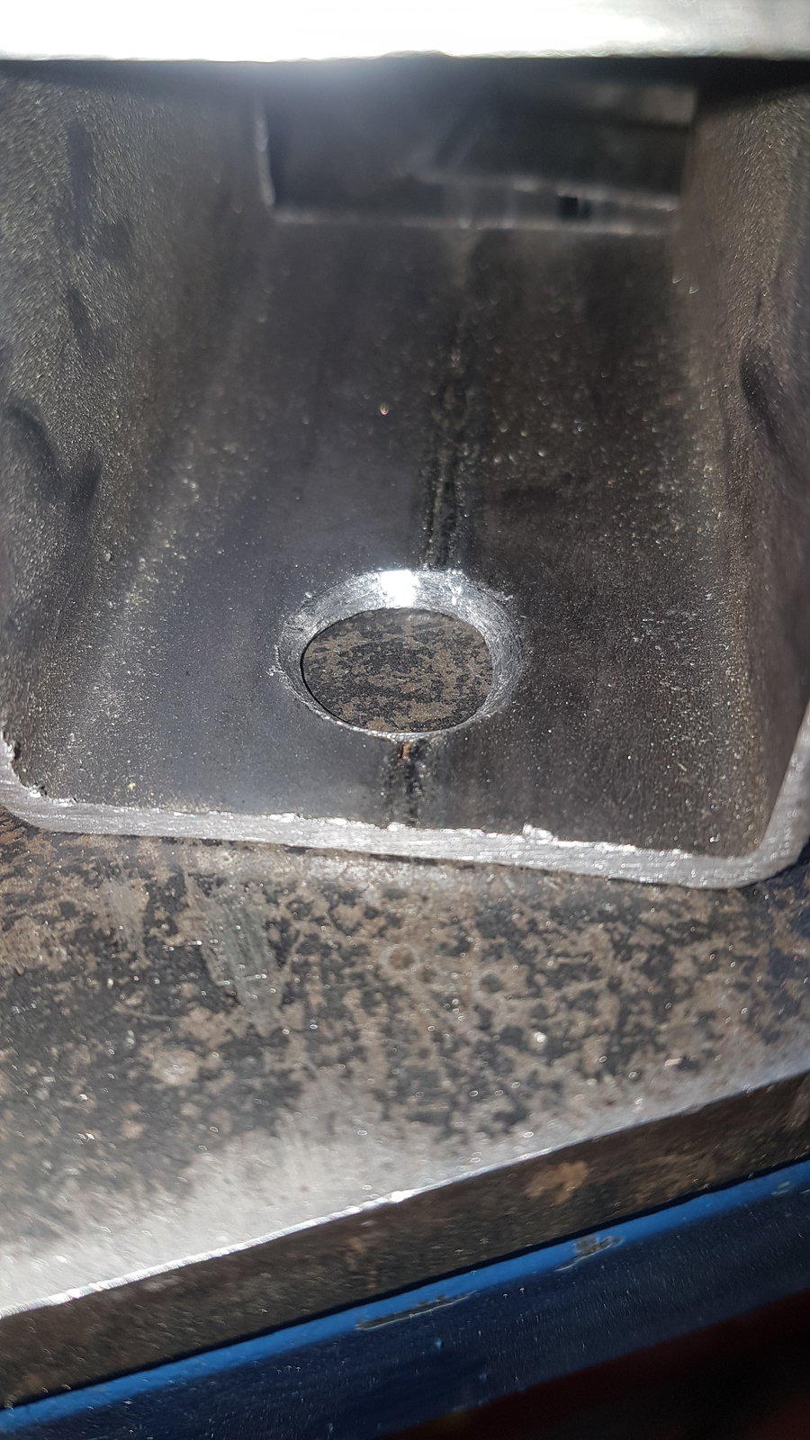

It's not great. Not sure how much damage I did squashing it in the vice... Not that much though.Good result.
Look how out of square that 50 box is though![]()
