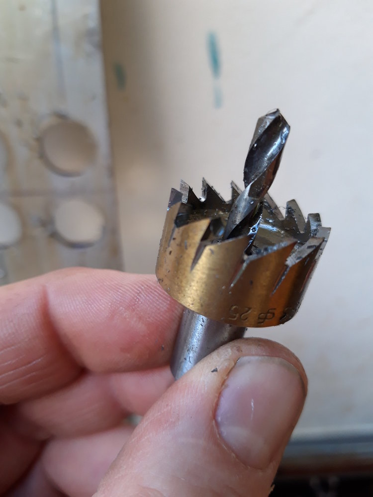

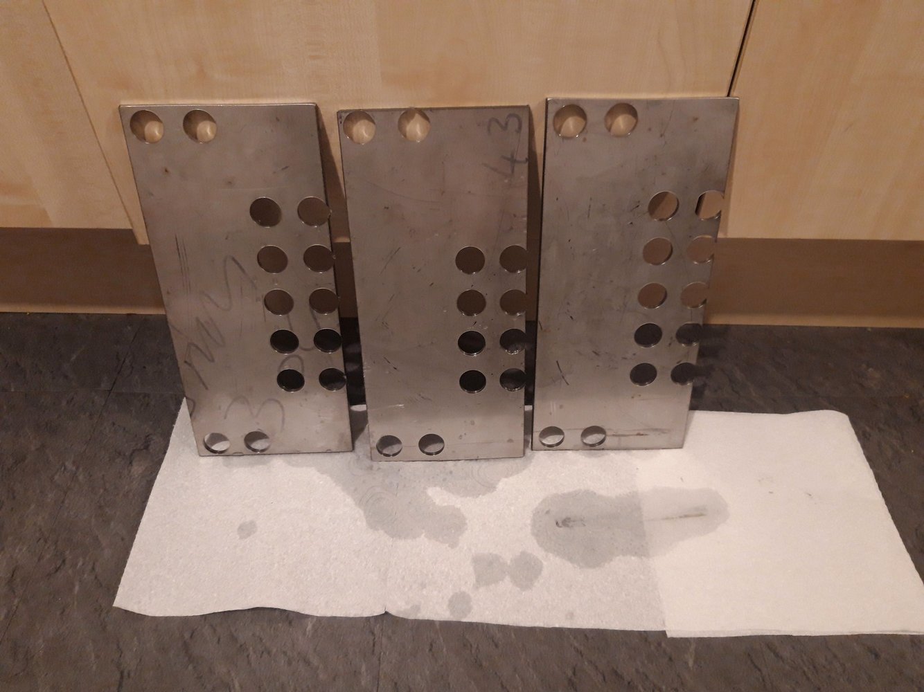

Oxy torch making holes in 6/8/10mm plate, and for the life on me I cannot get neat round holes, all mine seem to be less than round!
Holes are approx 25mm dia.

I also have the Panther. It is awesome. And made in Britain.If you need to do neat usable 25mm holes in 6/8/10mm plate then mag drill is the way forward.
We recently bought a Rotabroach Panther with a selection of cutters, it does a really good job on this kind of thing.
SixHow many holes have you got to make?
Hire or buy a mag drill.
Hole saw and lube.

Yep I’d hire one or see if someone’s local to help outHire or buy a mag drill.
If you can get it in the web it’ll be a much easier and neater job
