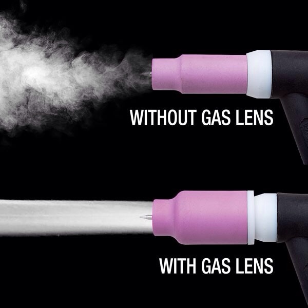

Yep. We are just wasting our money because we are welding tarts.All of us that use them are obviously wrong then !!!
The thing I noticed most was I could knock a couple of lpm off with a lens compared to standard.
Are you using a huge cup. If so that makes sense as the gas flow needs to be higher for bigger cups even on lenses. Like for like cup sizes though if your using more through a lens then something is wrong.I found they needed more gas flow but they give a better coverage with less turbulence
Like Richard says pal, size for size it should be lower. What size ceramic you got on and is it one of the 'compensating' sized ones?I found they needed more gas flow but they give a better coverage with less turbulence
