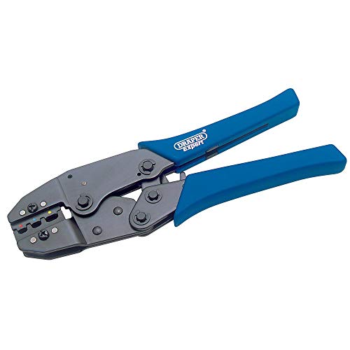

They had that on Lorry loader cranes, if the main battery connectors were soldered the cable would fail at the point were the solder had stopped flowing into the multi strands.
After that issue was discovered it was crimps all the way.

That was the issue we had.
But the technical manager insisted we soldered.
But after a series of recalls we went back to crimping.
Sound like bad engineering design or the wrong sort of stranded cables . I'm sure you can imagine 2 x 100 amp 12 v batteries bolted down in a tank or fighting vehicle the battery cables are well clamped to stop vibration problems

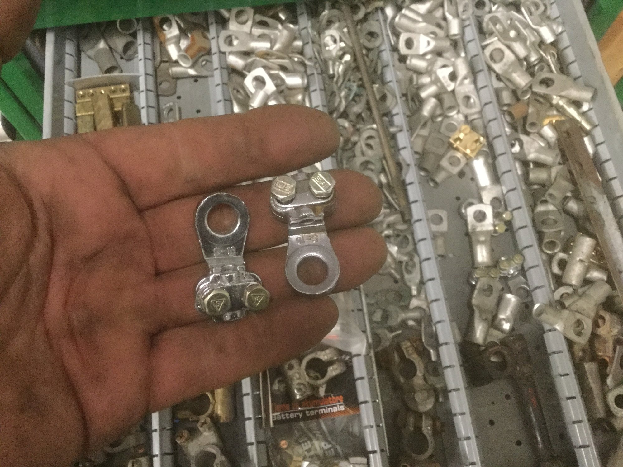

Interesting very interesting .don't ever bother soldering welding leads in to lugs the cable cant flex and snaps quite quickly . best crimped and will flex for years . been there done it and got the tee-shirt![]()

Always worth having the bolt on ones handy for the quick and easy "temporary" bodge

Me too, on 2.5mm flex for motors I pull the coloured sleeve off normal crimps, solder them on and cover with heat shrink. Much neater and more secure to my mind, even if soldering stranded cables isn't ideal.
