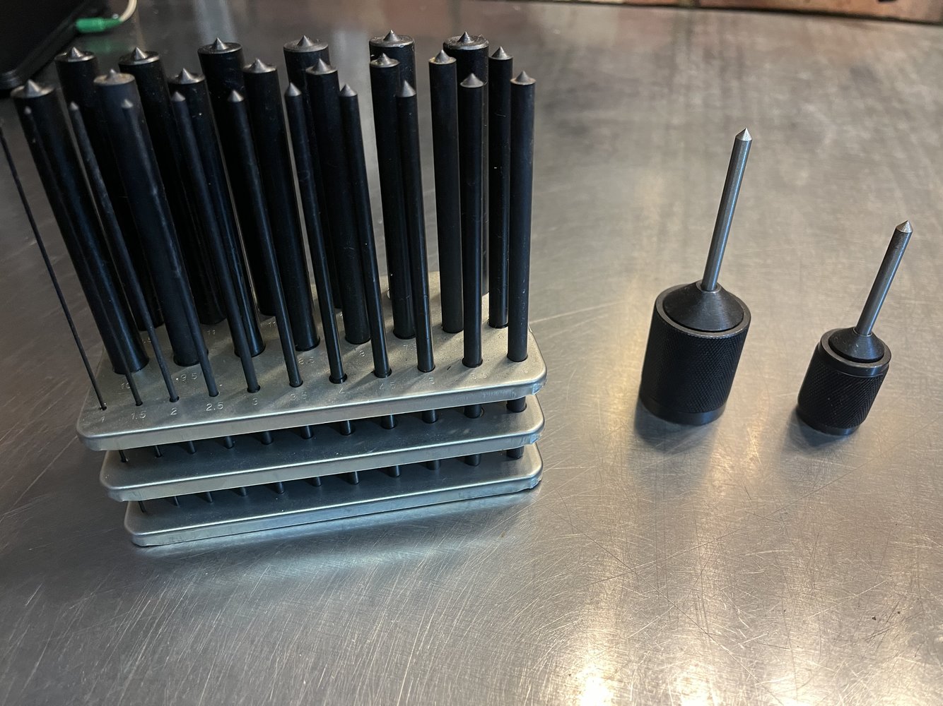

I got a set of them after a recommendation on here (might have been @Brad93 ?). Just been using them this weekend. I found that a 6mm transfer punch won’t go inside a m6 tapped hole though ….
That would need to be 5mm or smaller.
Got a couple of sets of these hole transfer punches many moons ago, metric and imperial. They were on special from one of the suppliers catalogues at the time for about £10. They get a lot of use.
