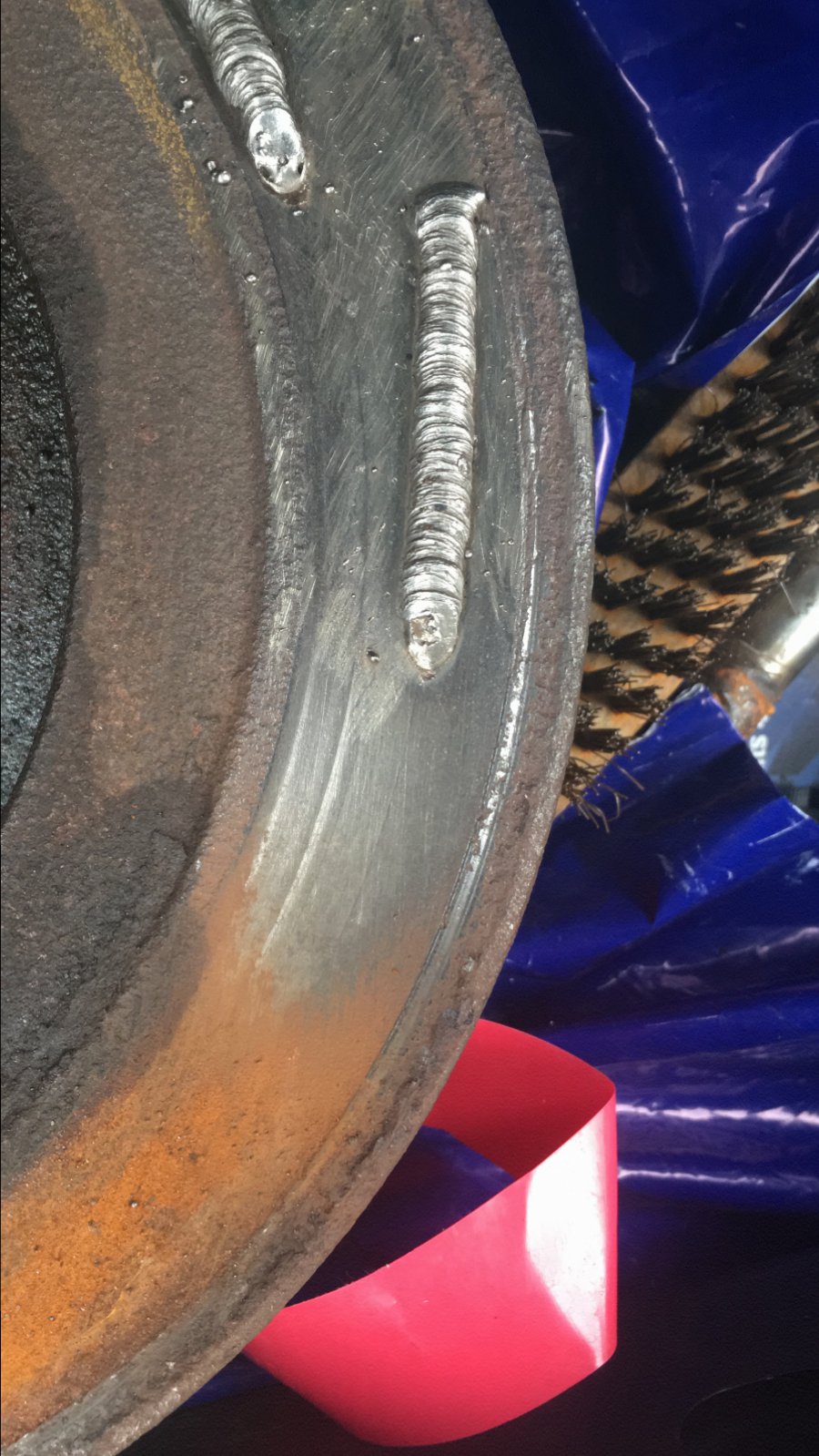

O Olig1990 New Member Messages 2 Location Warrington england Aug 31, 2016 #1 i have only just started welding and have been practising on old brake disk with 0.9 mm flux core i am just wondering is it any good ? Thanks in advance image.jpeg 258.2 KB · Views: 105
Pete. Member Messages 14,952 Location Kent, UK Aug 31, 2016 #2 Looks bloody reasonable to me especially laid on cast iron. Might find your mum gets a bit of judder through the pedal now though
O Olig1990 New Member Messages 2 Location Warrington england Sep 1, 2016 #3 C Pete. said: Looks bloody reasonable to me especially laid on cast iron. Might find your mum gets a bit of judder through the pedal now though Click to expand... cheers dont think she would be to happy if i put them back on lol
rtbcomp Moderator Messages 18,573 Location Sheffield UK Sep 1, 2016 #4 Brake discs are most likely steel, not iron.
Seadog Save the planet. It's the only one with rum! Messages 12,956 Location NE London - UK Sep 1, 2016 #5 I'd have said cast iron, unless you've some exotic machine with ceramic or carbon fibre.
rtbcomp Moderator Messages 18,573 Location Sheffield UK Sep 1, 2016 #6 ^^ A quick Google says most are made fro grey (gray) cast iron or an alloy, but a fair few from cast steel, then there's the exotics as you say
1 123hotchef Member Messages 14,394 Location Kent Sep 1, 2016 #7 i have practiced on steel discs tried on cast ones too but it didnt like it!
