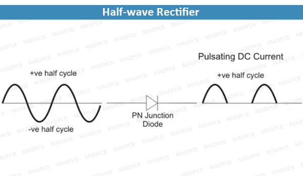

A half wave rectifier results in current flowing only in one direction in the transformer secondary. This produces a unidirectional magnetic flux in the transformer which will saturate it. Transformers are normally designed to have a net flux of zero.
If the transformer saturates, the coupling between the primary and the secondary drops. This results in, inter alia:
1 The input impedance of the transformer drops (so more mains current) and
2. Less output current.
Both are a direct result of the loss of coupling between the primary and the secondary windings.
There will be less output because of the half wave rectifier (wasted half cycle) but the reduction I am talking about is in addition to that.
If that doesn't answer your question, please be more specific.

Half wave rectification outputs a pulsing DC current at the supply frequency (50 Hz) whereas full wave rectification outputs at double the supply frequency (100 Hz). I make no claim regarding the relative merits of either method for welding (I'm still using an AC buzz box) but if you need a smoothed DC output, full wave rectification is preferred. From what @Jack Ryan has suggested, there may also be some benefits regarding the effect on the transformer.Are there any situations when you may only have a half wave supply available and might need to run a welder from it?

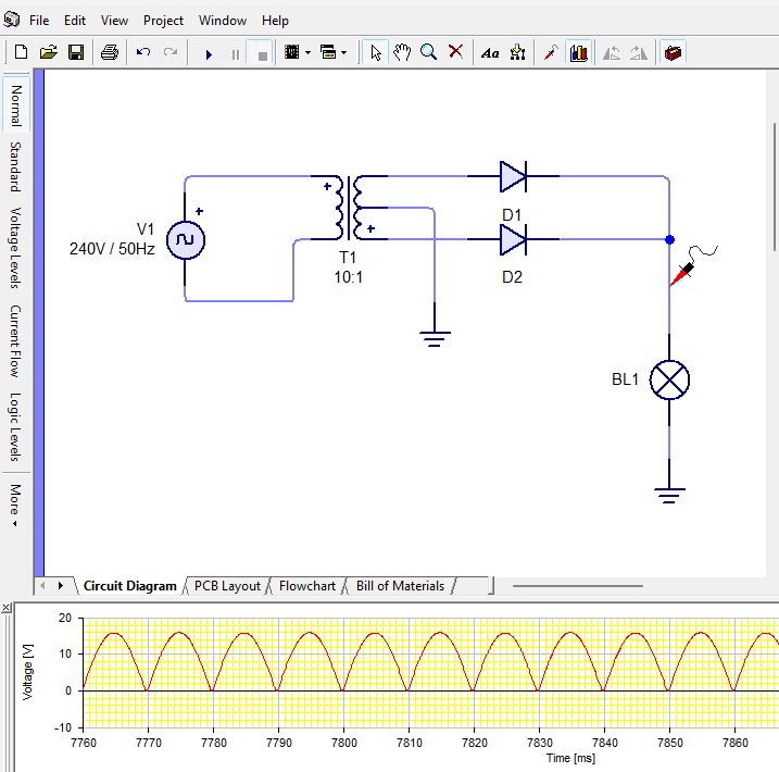

Just for completeness, it is possible to build a full wave rectifier using just 2 diodes if the transformer is centre tapped. However, I doubt that will apply in this situation.You didn't answer the question
There needs to be a full wave rectifier so that each half cycle's magnetic flux averages to zero.
So could this be done with a diode resistor? Yes wasteful, as would be having an oversized transformer, but that's a secondary issue, especially if it's an experimental lashup, or even poor man's tig.
Yes.Just for completeness, it is possible to build a full wave rectifier using just 2 diodes if the transformer is centre tapped. However, I doubt that will apply in this situation.
Two Diode Full Wave Rectifier Circuit » Electronics Notes
A two diode version of a full wave rectifier circuit can be usefully used on a number of occasions to make use of both halves of an alternating waveform.www.electronics-notes.com
Still never answered the questionJust for completeness, it is possible to build a full wave rectifier using just 2 diodes if the transformer is centre tapped. However, I doubt that will apply in this situation.

A single diode causes current to flow in one direction, this results in an average DC current which may saturate the transformer.The rectifier diode prevents DC from feeding directly back to the transformer directly, so the secondary doesn't "see" any DC as such. It just has to grunt every other half cycle. This results in an asymmetric load presented by the primary, because the secondary only has to do work during one half cycle, and this makes the incoming mains slightly asymmetric, making it behave as if there is a slight DC bias.
