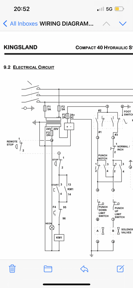

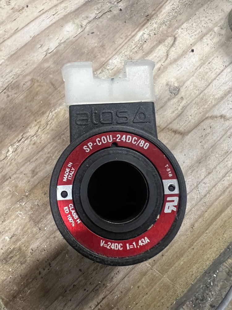

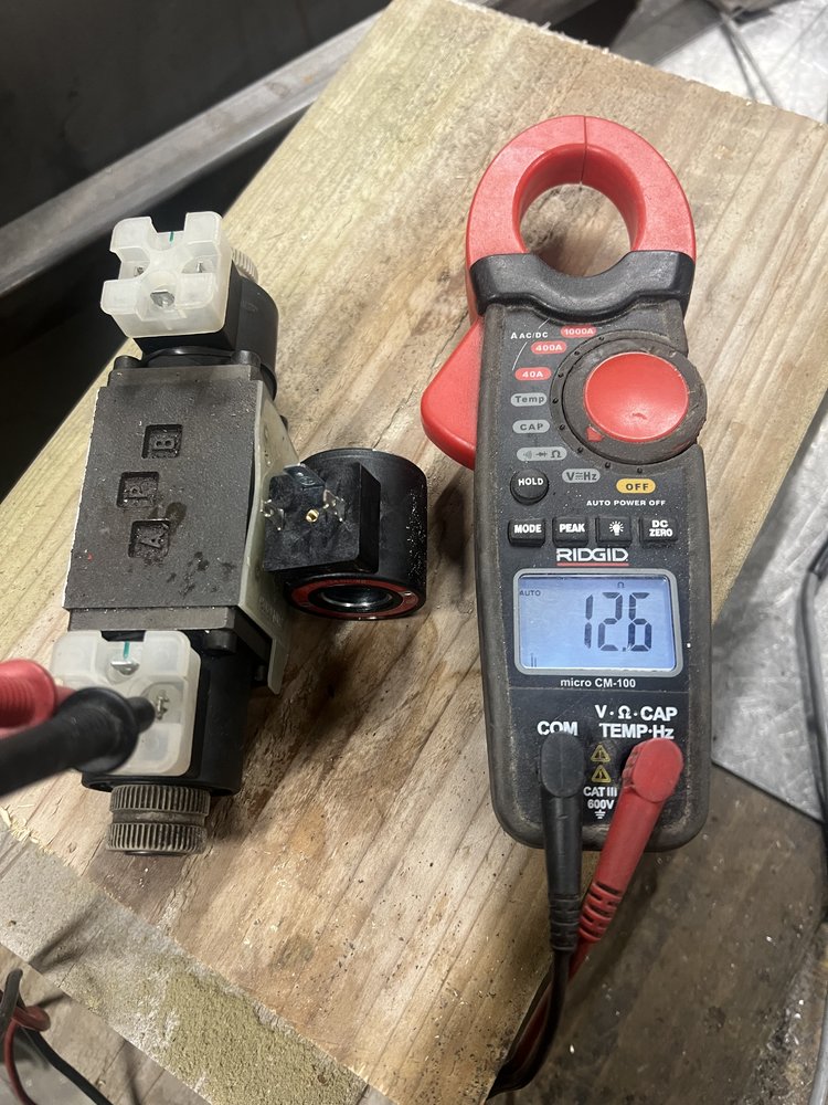

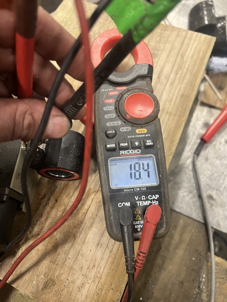

I was cutting stuff on my Kingsland 40 today and midway through the job the ram seemed to get stuck and won't retract. I've tried tapping it and levering it while operating it but no joy. I've now blown a couple of fuses in it so will have to get them tomorrow before I get back at it. Any thoughts or ideas welcome thanks
