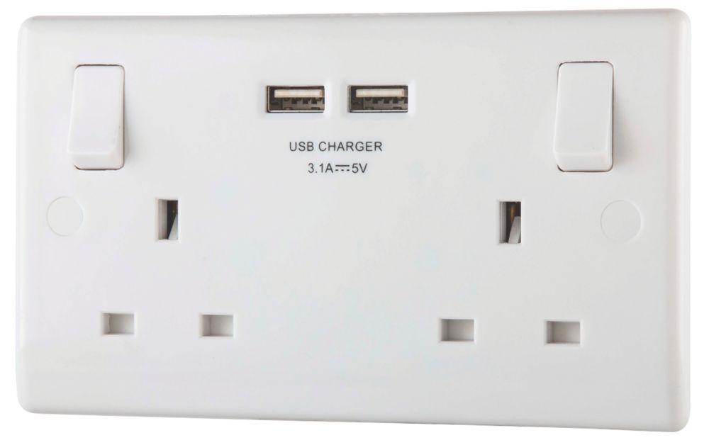

The 800 series face plates are exactly the same profile and you only need to take two screws out and slacken the other two to swap them, there are a couple of the plastic plugs for the normal faceplate holes that need to be transfered but that is it.

So now I have an IP66 double socket with USB, it also means if you have newer stuff you could also fit a socket with USB C instead as they do a USB C in the 800 Series
Obviously I do have a redundant double socket faceplate too.
British General 800 Series 13A 2-Gang SP Switched Socket + 3.1A 15.5W 2-Outlet Type A USB Charger White - Screwfix
Order online at Screwfix.com. White moulded socket with 2 USB charging ports. Ideal for mobile phones, tablets and other USB devices. Features protective overload function. FREE next day delivery available, free collection in 1 minute.
