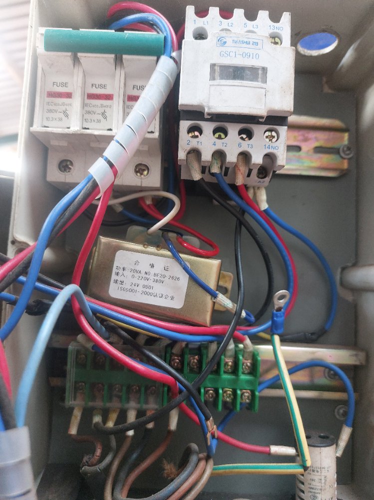

Inside of control box just power off/on and stop start buttons on the front. thanks.Are there any controls (eg relays) associated with this motor? If so then you need to make sure the control voltage is suitable for these as well, a vsd typically won’t be suitable for these.

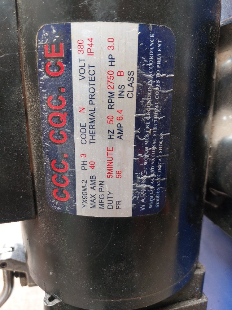

For that motor it looks like you need a 230-380v vsd unless there is some links inside the terminal box to change voltage.

The motor label states "thermal protect".
