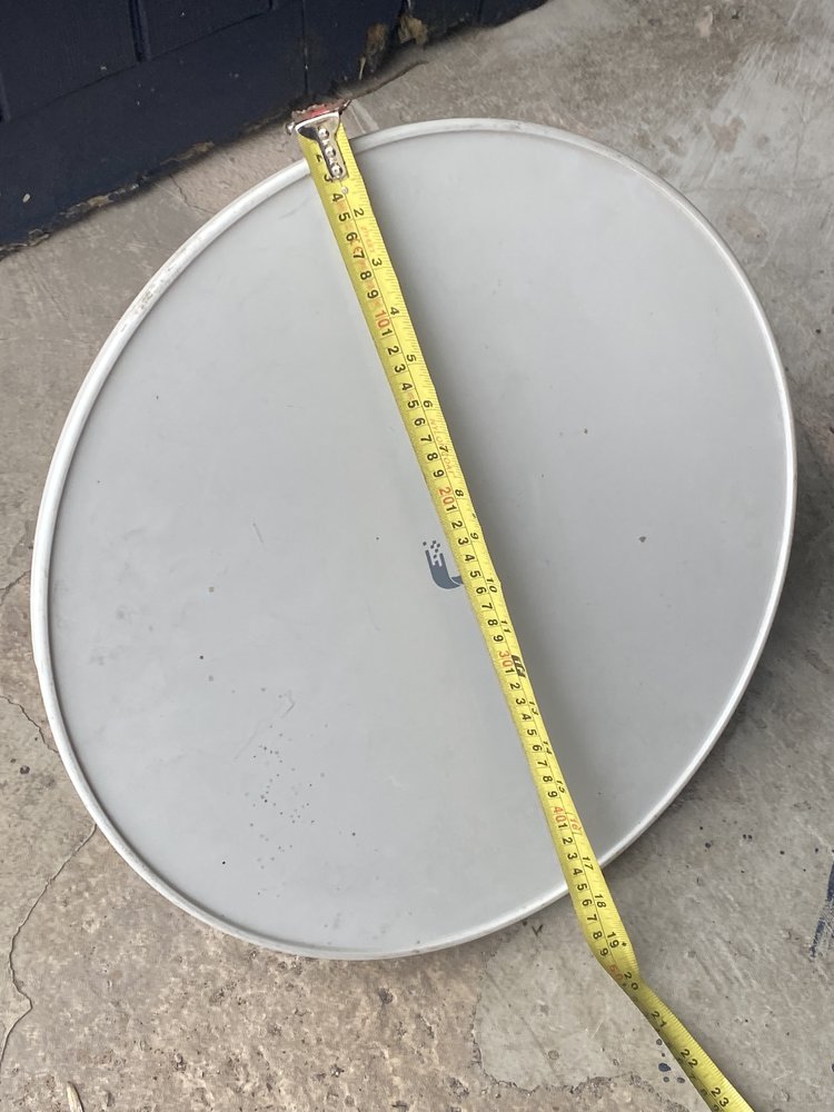

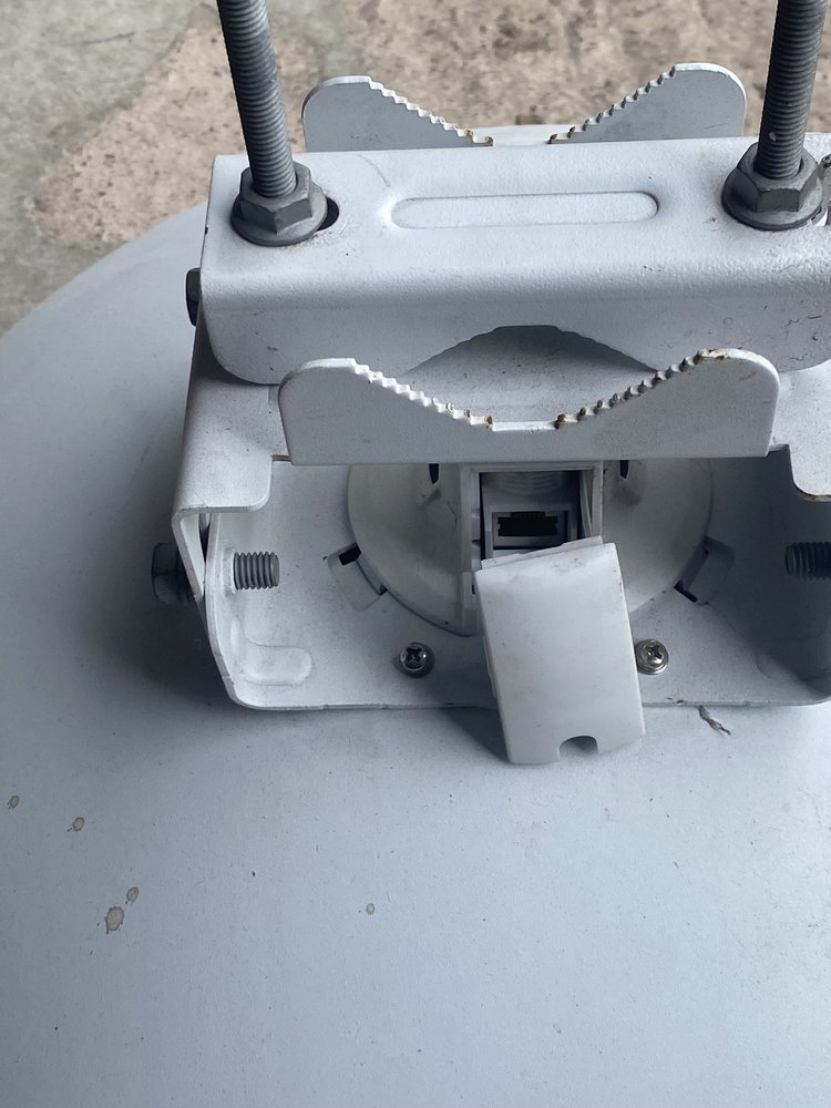

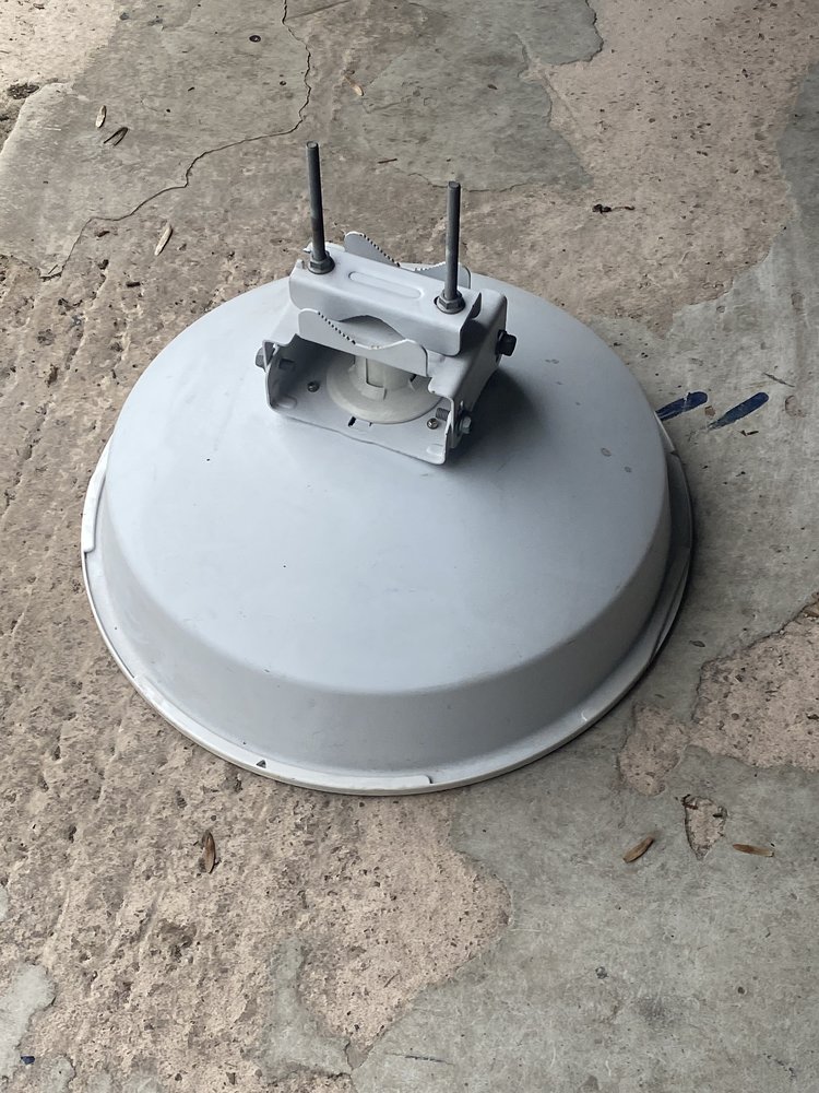

No model number on them, but they are Ubiquiti Unifi. You talk to them on their web page.
View attachment 450441View attachment 450442View attachment 450443
5Ghz. For interest, microwave refers to anything above 999.99 MHz.Microwave?
My point to point discs are by a firm called Microtik, but they do different ones now. They have-an 8degree aim apparently, as one disc on the barn supplies two different locations. When discussing your line of sight with trees he suggestec dropping from 5 Ghz to 2.4 for better stability.Mine distance point to point, one is 50m the other is about 80m. Ill get make on Friday as Im clueless on this stuff but-the guru is here to extend my network Friday, so I will ask him.
