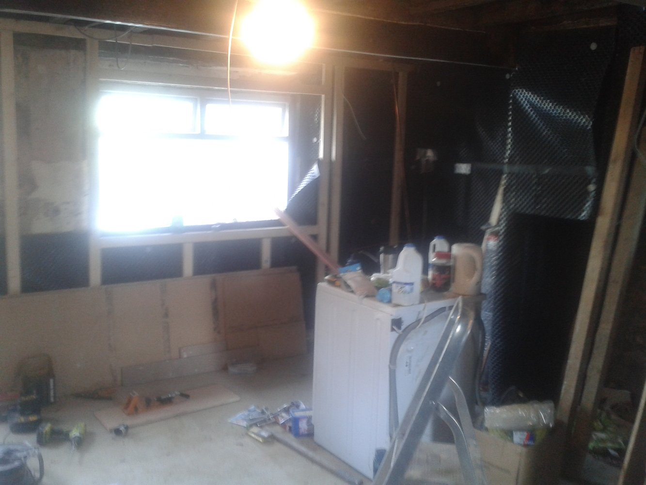

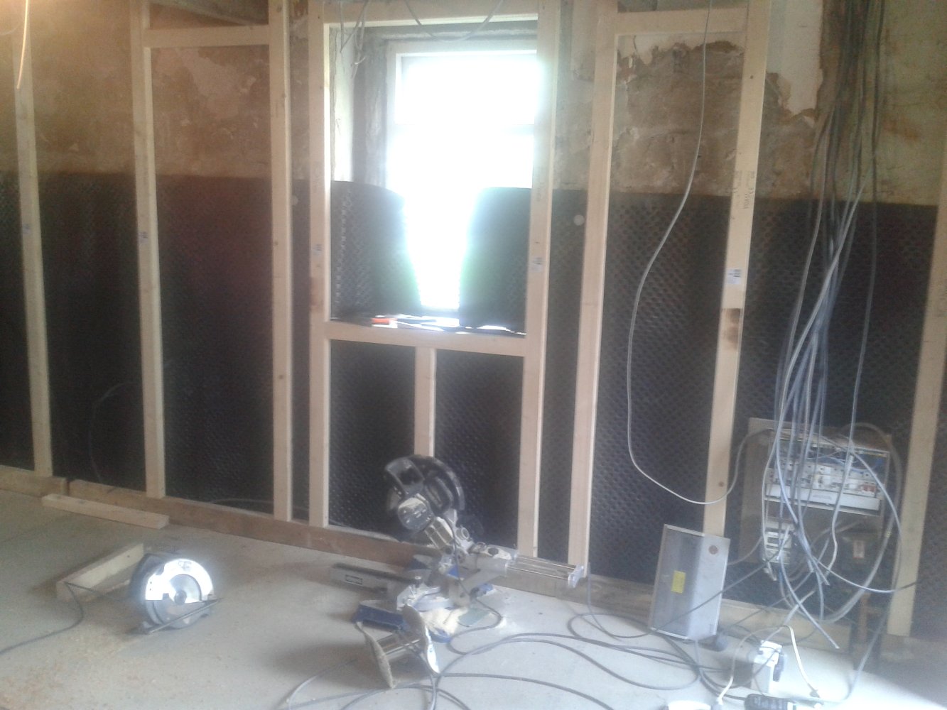

if you watch this its dot and dab with plasterboard just shouldnt be used on a solid wall ( no cavity )
please watch and see for yourself
if you put any light switches or plug patress box and dont forget the wiring that needs to be fitted you break the water seal
please do not do his updated video
once you use the foam in horizontal form it seals the damp within the area the verticals are fine so is a good idea
do not cut spray foam it collects water for fun if you do if theres any damp it will be absorbed into the cut foam
